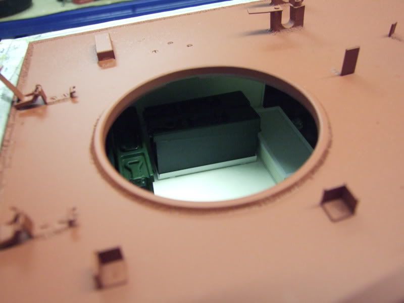

As I suspected I knew I hadn’t read anything anywhere about paint other than red oxide.
This picture must be of a Jagdpanther
Hear are some pictures of my attempt at zimmerit I have ran out of milliput so will have to get more tomorrow,
This is the front covered with zimmerit along with the all important ladder marks that is so often missed by builders, the authors of a few Tiger books claim that this front horizontal plate was rarely covered with zimmerit but after studying hundreds of pictures it became apparent that that all mid and late Tigers had this covered though clear pictures are rare the angle that pictures where taken is one of the reasons why there are few pictures showing this detail.
The rear plate under the mudguards was void of zimmerit though pictures showing this are rare as the back is usually covered in mud so becomes very difficult to see

I'll search on my books as I saw pictures with zimmerit on glacis, but there are however a lot of pictures (I used the pz.abt.508 pictures to make my tank) showing the glacis without zimmerit. Yes, mostly are unclear also for the sun, but I'm almost sure that on pzabt 508 tanks (basically all mid of end '43/beginning '44) have no zimmerit on glacis.
I will search better, but I think that it can be a unit/crew modification to keep or to make it.

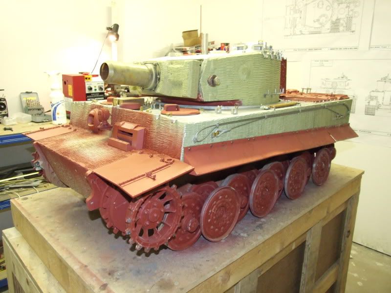

I have now completed all the Zimmerit on the Tiger, this I’m hoping is a reasonable reproduction what I did to make things as realistic as possible was to attach all the stand offs, cable/tool brackets etc then apply the milliput around the parts just like the real thing this takes a little more time but is well worth the effort I have also studied hundreds of pictures of zimmerit on Tigers and have tried to reproduce some of the effects used along with the irregular pattern
SS102 Tigers had on a number of Tigers spare track brackets fitted but as there are no known pictures of 134 then I have to use a little artistic licence and luckily enough there is a picture of 132 with these brackets fitted these where welded to the front driver’s plate each set of brackets will hold 3 spare track links there is also a picture of 131 without so it would seam to be hit and miss.

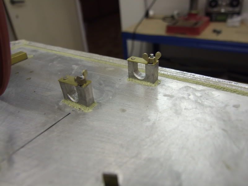

All the tool brackets are from Mike Stannard I purchased these around 3 years ago and since then he has upgraded a few of these parts using brass as opposed to white metal one thing that will be updated at a further date is the ends of the gun cleaning rods these are cast from white metal I will replace these with brass turned ends when I get the time to make them, one modification I have done is to replace all the cast wing nuts with working brass items
The side mudguards are from Mark 1 Tanks and are steel these will have a small amount of damage dome before painting, I have also attached a set of scratch built track pin deflector plates

Hear are a few pictures of the tank with the turret attached for the first time in a few years this still needs a lot of work before it will finally be ready for painting.
This is a new part from Panzer works, made from resin and just needs the seat pads making from milliput.

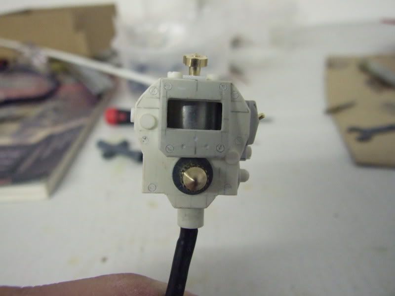

Gyro Compass
This has totally been scratch built using a scale drawing of the real thing http://www.theresearchsquad.com/drawings.html using alloy, brass and plasticard I have even built the bracket that holds this in place the idea is to give the Tiger a certain amount of through the hatch detail things like the ammunition racks and the stowage for MG ammunition have already been built though the engine compartment detail will come latter probably after the tank is fully painted and running, as you can see from the pictures the compass will have a light fitted this will be connected to the main switch so when the tank is turned on the compass illuminates
And here is the completed item ready to install once the LED has been fitted, I’m sure you will agree I have gone to some trouble just to have a different on/off light instead of the usual car dash light below the grills, first picture is of the Bovington Tiger compass and before any smart arse says the centre of the dials are different colours have a look at the link above
