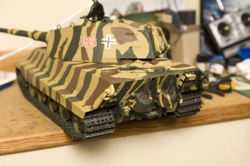

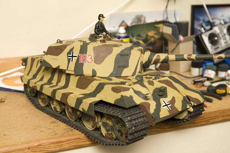

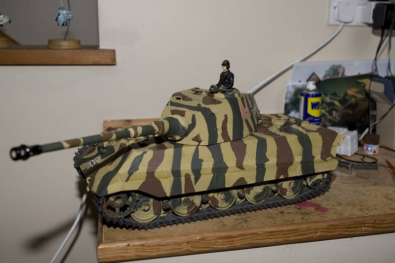

#35
Join Date: Jun 2008
Location: Nottinghamshire, UNITED KINGDOM
Posts: 163
Received 2 Likes
1 Post
RE: paint mixing tips please
here are some photos of my newly painted tank......i gave up with the spray gun trying to paint lines so i ended up using a brush, funny thing is, this morning i was watching a youtube video of the KT at Bovington museum and my KT looks similar (well i think so) let me know what you all think of my first effort
thanks for all your help
Kev
Kev
#36
Join Date: Jan 2005
Location: New Braunfels,
TX
Posts: 56
Wow! That realy looks great!
I have not done much camo. Did you use stincels or masking tape to get the fine boarders?
Great job!
I love to build RC's and I feel I am pretty good at it ,but I am still working on my painting skills.
Bryan
Great job!
Bryan
#37
Join Date: Jun 2008
Posts: 163
Received 2 Likes
1 Post
you really thinks so Delta 3 ??????
no i did it all by hand, i tried masking it off but the paint ran underneath the masking tape, so all i did was get a small brush and go over where it had bled on the green, i ran over all the green with the brush then painted the brown with the brush.
i was quite disappointed with it, the wife said it looked ok, but i was told these tanks were painted by really young men, who sometimes used anything they could get there hands on, brush, mop, spray gun whatever as the life of a tank was not that long!! i suppose if it looks messy, it will look authentic. I have seen a KT on this site which the guy must have spent a small fortune on (unfortunately i cant) and it looks like a real tank, hours and hours must have gone into it. I don't have the skill, time or money to make it how i want it......
thanks for your comments.
Kev
Kev

#39
Join Date: Jan 2007
Location: Santa Rosa,
CA
Posts: 1,332
Hey madbadger
The King Tiger came out looking GREAT, nice paint job. Delta 3 is right you will always be your worst critic, after you weather it and add some stowage items, it will all come together, I like it. [sm=thumbs_up.gif][sm=thumbs_up.gif][sm=thumbs_up.gif]
Gary
Gary
#40
Join Date: Jun 2008
Posts: 163
Received 2 Likes
1 Post
thanks, i have been putting the accessories back on shovel, hammer tow ropes etc. I'm not sure how to weather it though, i have mixed black, a rust colour, and dry brushed them with a little silver paint added to the brush then dabbed off onto a tissue and painted then exhaust pipes and im quite pleased with the results, it looks like a 20,0000 mile exhaust pipe.....i may take the German stickers of and make a stencil and paint them on....
any ideas on how to weather it would be appreciated.
as for battle damage i thought of driving down my drive and deliberately scraping it down the brick wall as to damage the side skirting, then paint a little rust paint where the scrape marks would be, what do you think???
i would like to put some shell marks on the hull maybe some bullet holes in the skirting, but don't really know how to do it, Ive seen someone on here use a dremmel (i have one) but they can be violent at times, another guy used a soldering iron and just 'dent' the hull, it really did look like a shell mark but im scared of making a mess now Ive got this far......plus the wife would kill me with all the moaning and complaining and money Ive spent on paints etc......LOL
a friend of mine who is into model trains told me to get a piece of lint free cloth, spray some brown paint on lightly and wipe it in the direction of travel from front to back of the tank, he said he did this with his trains to make them look dirty.......
thanks guys, im starting to feel good about what ive done.....thanks.....
Kev
Kev
#41
Join Date: Sep 2006
Location: bangalow, AUSTRALIA
Posts: 257
Madbadger , that looks great . No reason to be down about that job mate. The important part is you did it and you can now do it again any time you want to on the next tank. Congratulations[8D]
