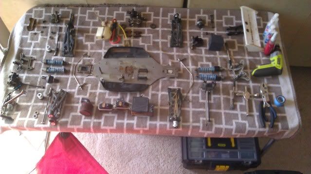

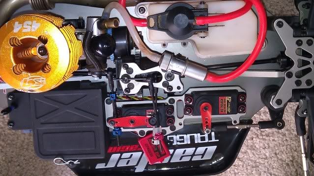

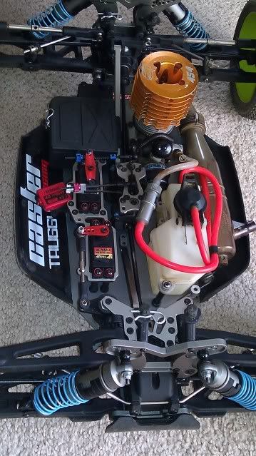

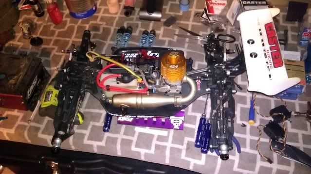

A few days ago I began to tear the truck apart to put in fresh diff and shock oil and to repair/replace anything broken or striped. I also wanted to inspect all the plastics for cracks or signs of wear. I am being lazy so I have not cleaned the parts yet, will probably do that tonight. Here is what I have done so far:
I also plan to install HITEC 7954 servos (throttle/steering), lipo batt., and dynamite pro throttle linkage kit.
When I took the truck out last I ran 35 weight oil all around. For my track that seemed a little stiff. For the rebuild, I will run 35 up front and 30 in the rear.
For the diffs I am going with 5k/10k/3k. Ride height will be set at 38mm front and 40mm rear. I will run 2* toe out and 2* camber in front and 3* toe in and 2* camber in the rear. We'll see how this works out.

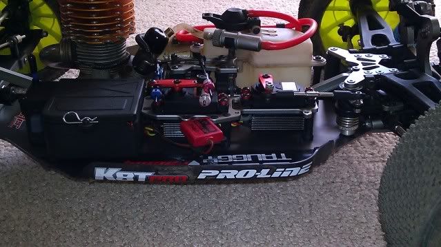

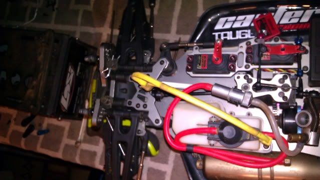

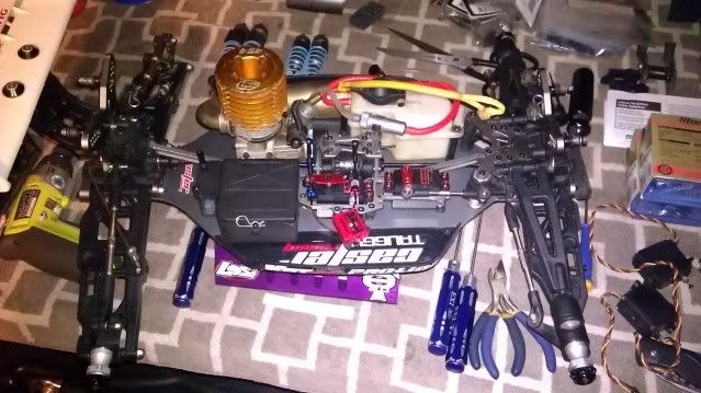

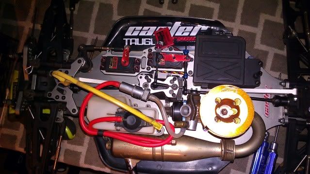

Well, I started the rebuild of the truggy tonight and I am almost finished. It is getting pretty late over here so I am going to call it a night but not without giving everyone some pics of the rebuilt truggy:

You have an extra hole in the front side of your radio tray by your steering servo. I had that added to the design of the new truggy for athe reason. The front of the tray has too much flex with strong servos and will reduce your steering. Put an aluminum post there and drill a hole for it on your chassis. Steering will be way more responsive. Without this mod the truck seems to push one direction and not the other.

Okay, Iwill do that. Thanks for the heads up!

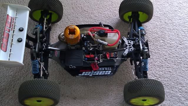

I  finished putting her back together this morning. If the rain stops, I will take her out to the track for some practice runs. Here are a few more pics:

Nice looking truck..

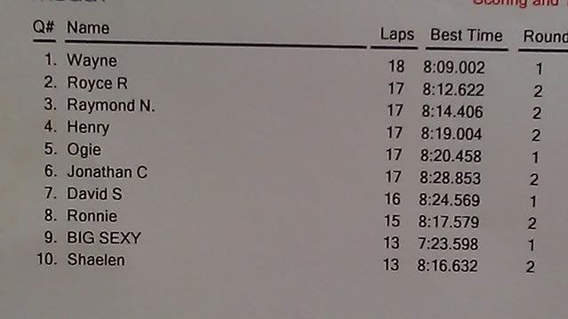

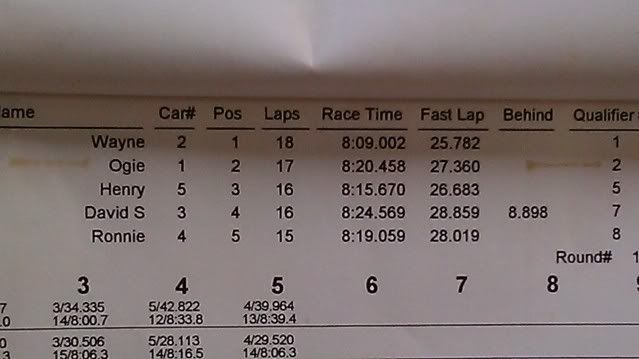

Yesterday was a very successful practice day. I was able to get to know the truck a little and make quick adjustments to her at the track. The handling and steering on this truck is unreal. The K8T is very responsive to every little input you make while steering. Right now, I have to drive slower because of this; however, once I get use to it, I will be able to run it faster.

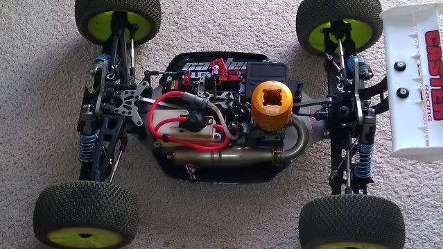

Just finished the new look for the 2012 racing season with my K8T:

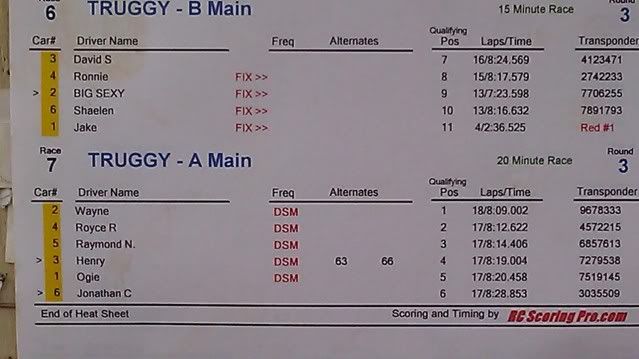

Had another good day at the track today. I'm becoming a little more comfortable with my K8T and the setup changes I made from the first vid worked
out pretty good. I'll be sharing my setup very soon, just want to do some more fine tuning. Here is a vid from my 2nd run:
