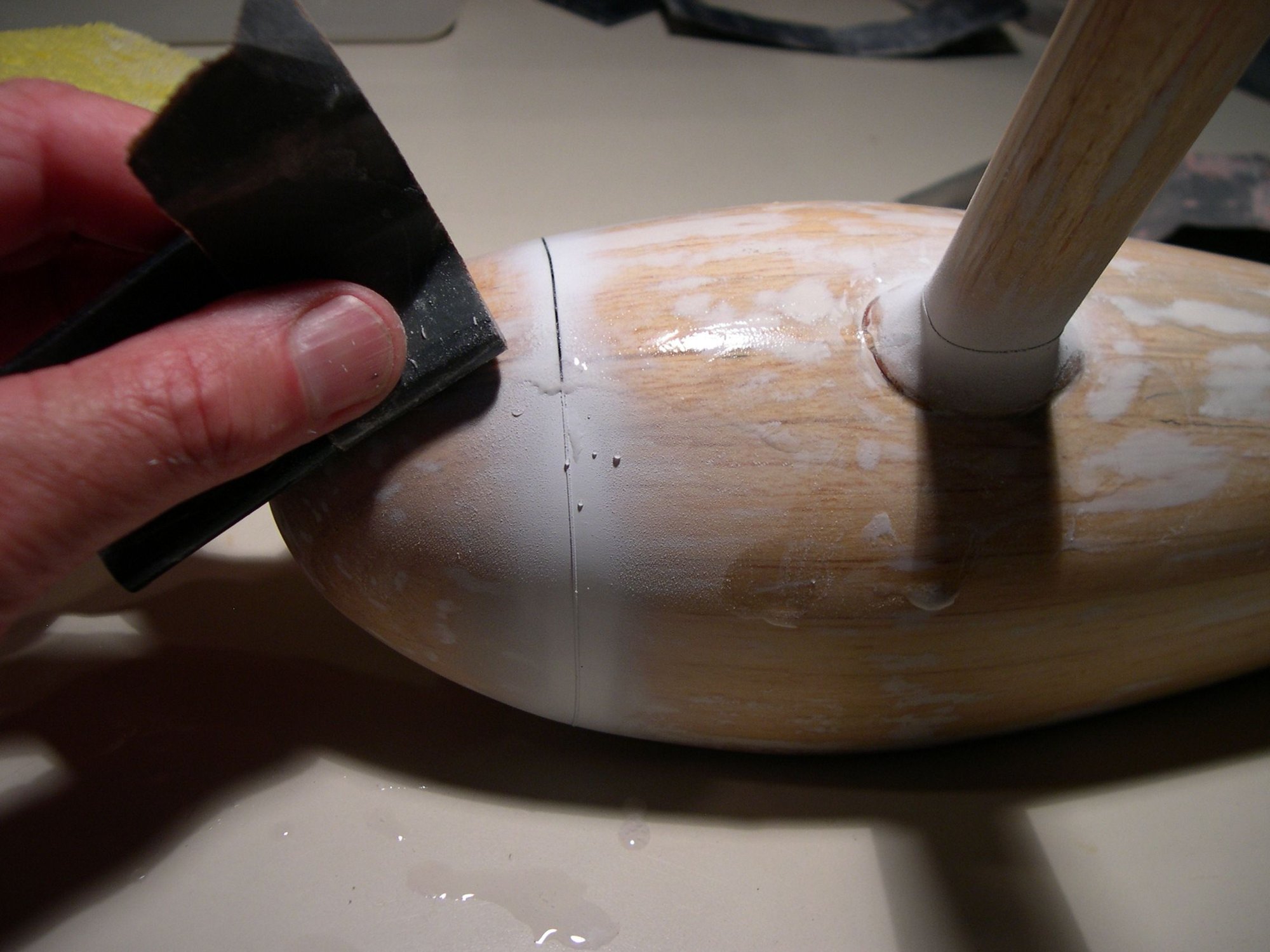

With the heavy sanding / shaping work on the cowling finished, a little cosmetic spackling w/ House Bondo and a last outer glassing w/ 3/4 oz. cloth should be the end of this stage. Six millimeters were taken off the aft end of the cowling perimeter and its looking better & better. At some point, the forward edge of the fuse will get rounded and the cowl will overlap it by 1/4" and that should get the side profile right on the money. Before that takes place, the
carburetor scoop needs to be fabricated and attached, then the cowl top gun troughs.
The static display blue foam spinner got 3 layers of panty hose draped and resined over it and will be put aside until the static display prop gets fabricated. G.

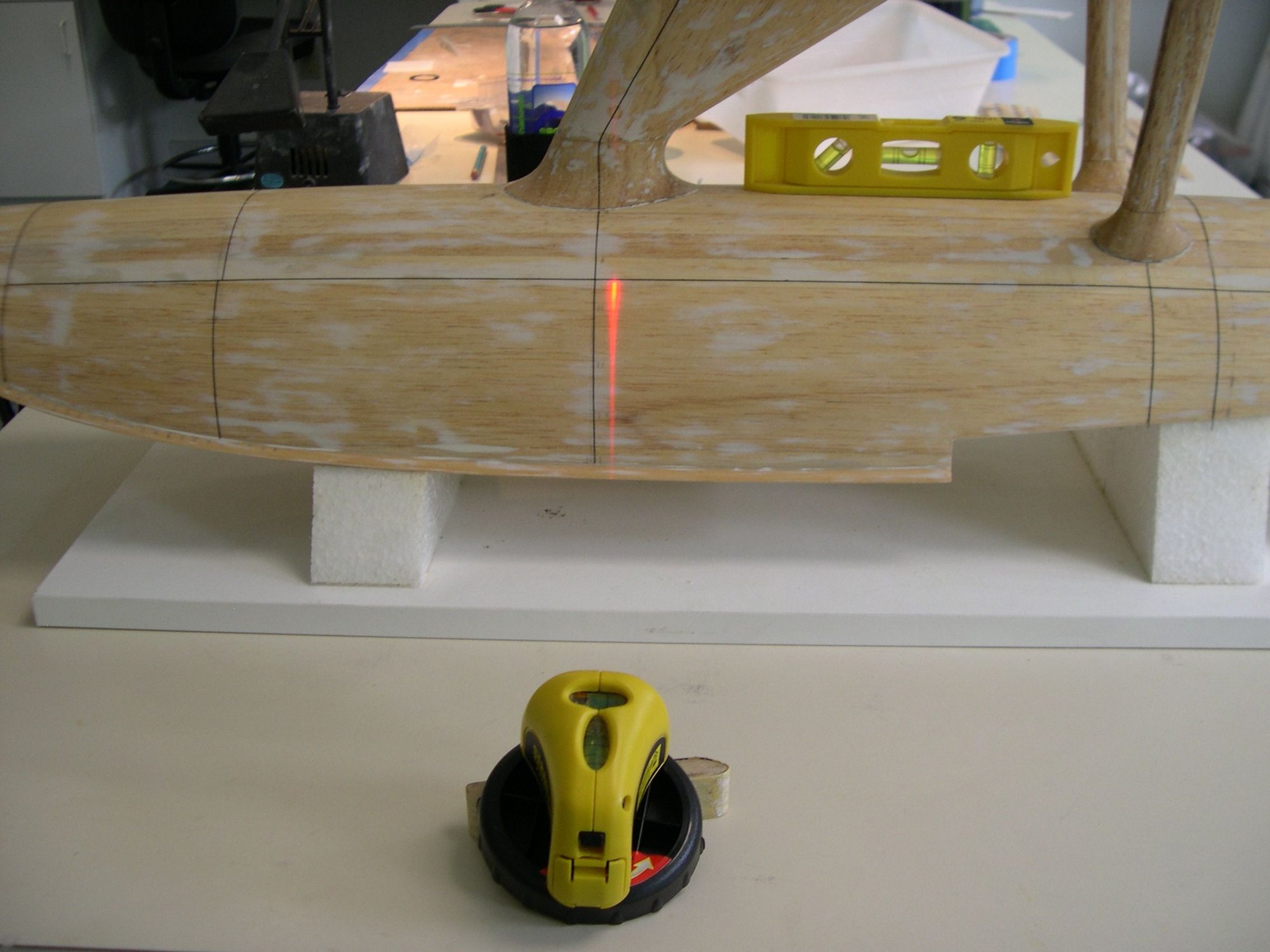

With the cowling fitted to the fuse, the temporary marker locations of the nose gun ports were revised and forward ends cut off and set back for the bondo rhinoplasti work-up. A sharpened brass tube was used to make the nostrils that would later house the machine guns. Once hollowed out, the brass tube was vaselined just where the bondo was going to be applied over it and once hardened, the tube was easily removed. Cutting and sanding got it to where it resembled the look I was after. In my opinion, the bondo approach worked much better than balsa or basswood in this step, providing good definition and symmetry.
Drawn lines were carried forth onto the cowling to delineate the gun troughs and the cutting was done with a deft touch using a Dremel saw bit. With a brass tube wrapped in sandpaper, the troughs were final sanded to the correct half-round depth and then glassed w/ 3/4 oz. cloth to finish it off. Next step...... lower carb intake fabrication. G.

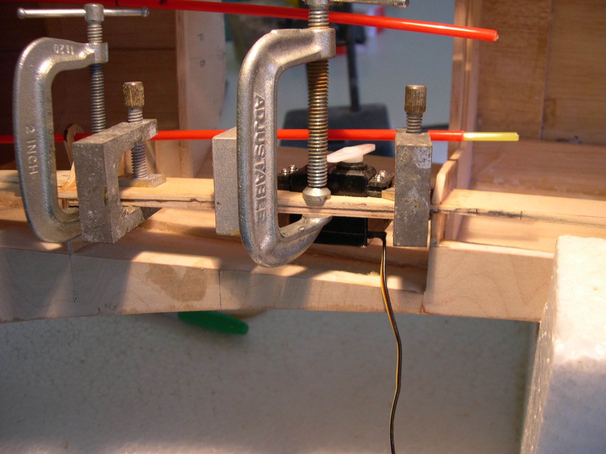

Default Elevator servo installation..
Something as mundane as servo installation doesn't warrant any light to be shed on it but in this situation, a little forethought and some ingenuity would come in handy. Every bit of radio gear had to be shoved as far forward as possible to decrease nose weight and lessen the overall wing loading. With the motor box taking up enough real estate and the water rudder servo as yet to be installed right behind it on the upper wing surface near the main spar, the only slick place to mount the elevator and rudder servo was on ( in ) the main fuse "crutch" just aft of the intended water rudder servo location on top of the wing.
Photo 1: Inner crutch servo cut-out for elevator made and mounting holes marked. ( Note ply bracket slid in place further aft, to be cemented in place when everything is in position & lined up.
2: Matching ply sandwich piece made and ready to be cemented in place on backside of crutch. ( Note maple blocks already cemented in place, pre-drilled and threaded.) Enough meat was taken out of the crutch to
begin with so something had to go back. ( Lightening holes drilled in to help minimize weight. )
3: I couldn't so much as fit a pin-drill holder in such a narrow space so I drilled a short length of birch dowel, tapped a bit into it and hand-drilled the servo mounting holes.
4: With the reinforcement piece carefully coated in epoxy, the servo was dropped in, raised up slightly to slide the assembly behind the crutch and the servo screws tightened to line everything up and draw the
assembly together. At that point, it was clamped and left to dry.
5: Finished installation. Procedure repeated on starboard crutch for rudder servo.

Nice work! The dowel hand drill is a clever solution, I'll have to remember that one.

My description of "tapped" was quite literal and not the presumed interpretation. Once I used a particular sized drill bit to make the receiving hole in the short length of
dowel, I removed the drill bit from my DeWalt, placed the bit point down into a block of wood, slide the hole of the dowel over the drill's back end and lightly "tap" it down until the dowel moved no further. There's enough of a friction fit to keep the drill bit from spinning freely inside the dowel when the hand drilling begins. Afterward, the bit is removed from the dowel using pliers. Sorry if I misrepresented myself. G.

Hey gang, back again despite work and heat......two elements that get in the way of completing this project. Though I was hoping to get everything done in time for my club's annual John Nicolaci Memorial Float Fly at Mary's Pond in Rochester, Ma. on Aug. 18th, it just could not be ready in time. With what needs to be done to finish this project, it will be a two-pronged approach. It will most likely be airworthy by mid Oct., the detailed, all-out finished product will be realized only after a bare bones outfitting for flight trials. That essentially means a painted plane, no cockpit detail or pilot, no weathering or "eye candy" detailing. That will all come after sea trials and ultimately flight trials to see if it is pilot friendly or a real bear.
The enclosed photos show a glassed, primed & ready fuse, as well as the 1/64th panel taping w/ epoxy primer, sanded away to reveal panel lines. Problem is when painted, all that work is virtually invisible and at some point, masking off the side walls of the joint lines and spraying a slightly darker shade of JN grey to make these panel lines a bit more pronounced is in order, at least in my estimation. More to come. G.
BTW: My wife ( who does these postings ) would like any help in figuring out how to post these photos in a smaller format as these are much bigger than need be. She claims " They keep changing things around on me!" Thanks.
