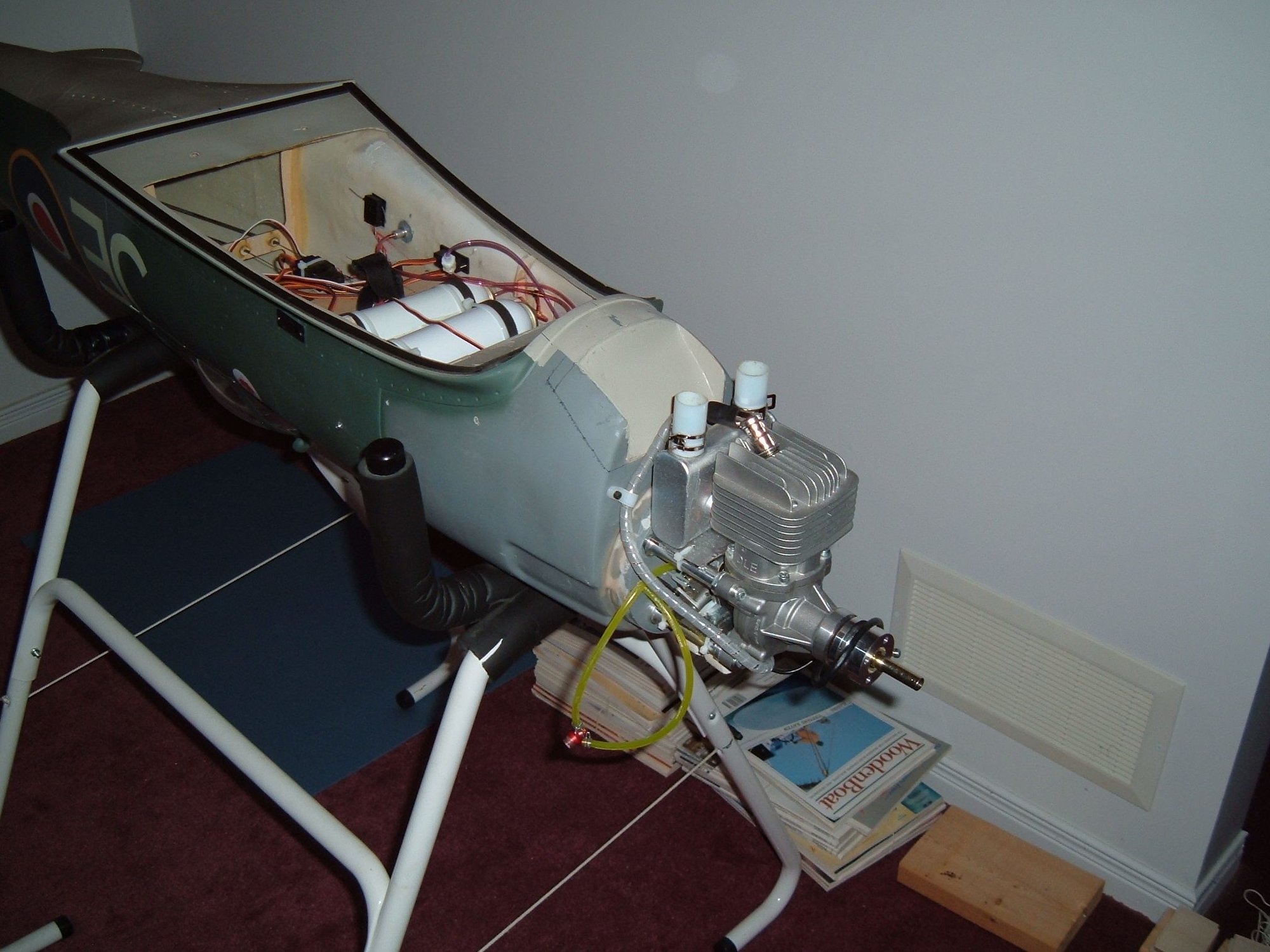

To meet 143mm CG, I had to add 6lbs of lead which I concealed in the nose chin. With the cowl removed no dead weight lead is visible, so one would think that no lead was required to meet CG.

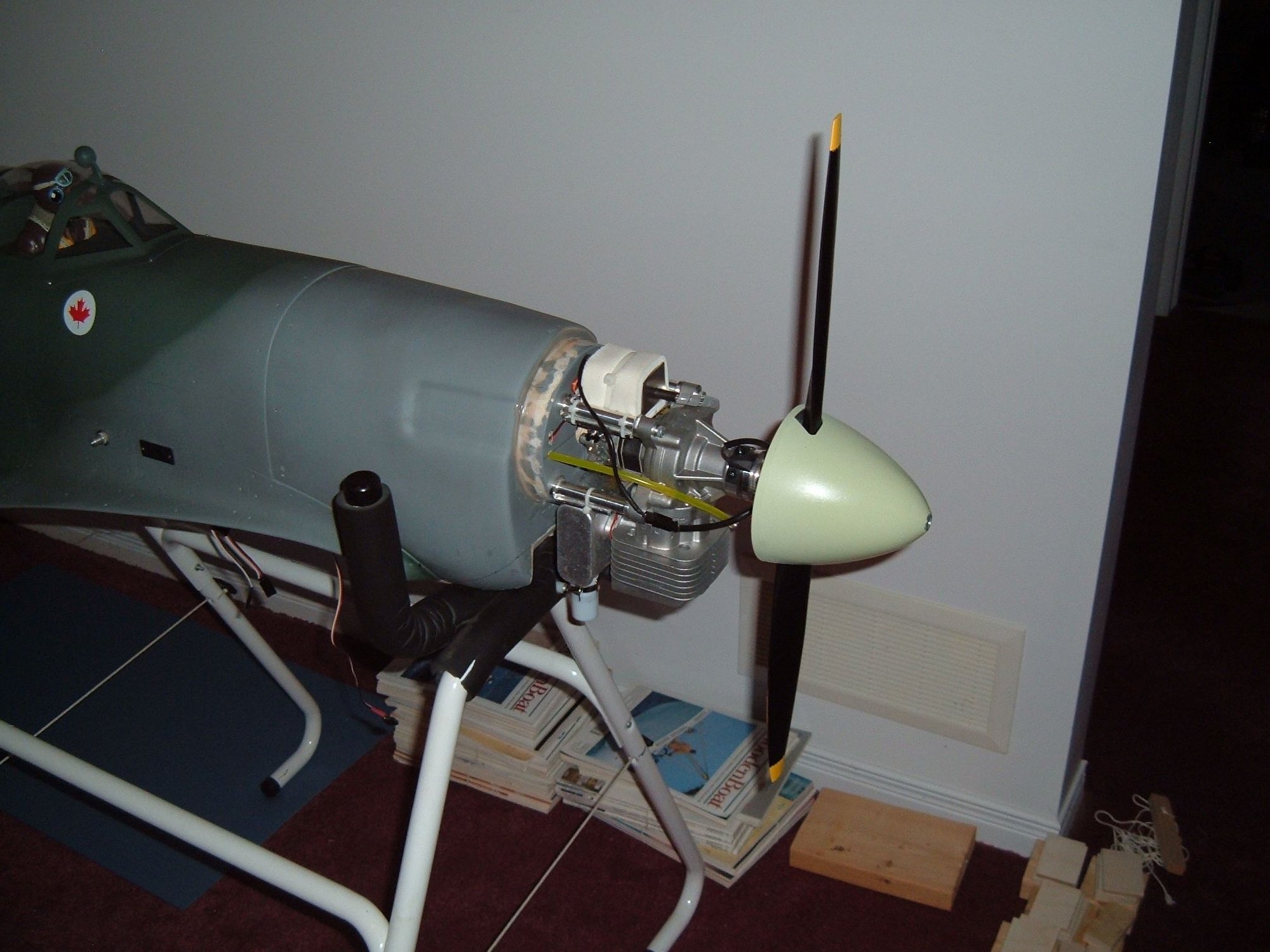

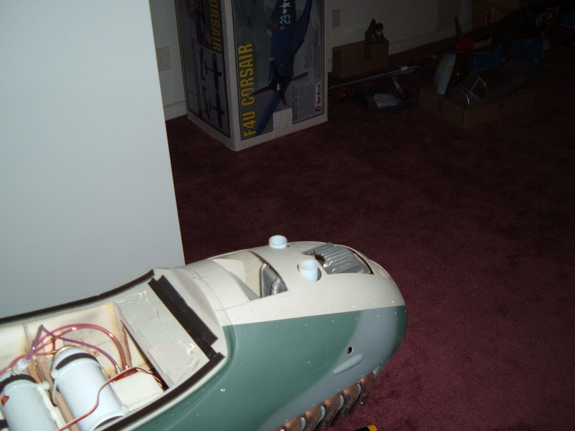

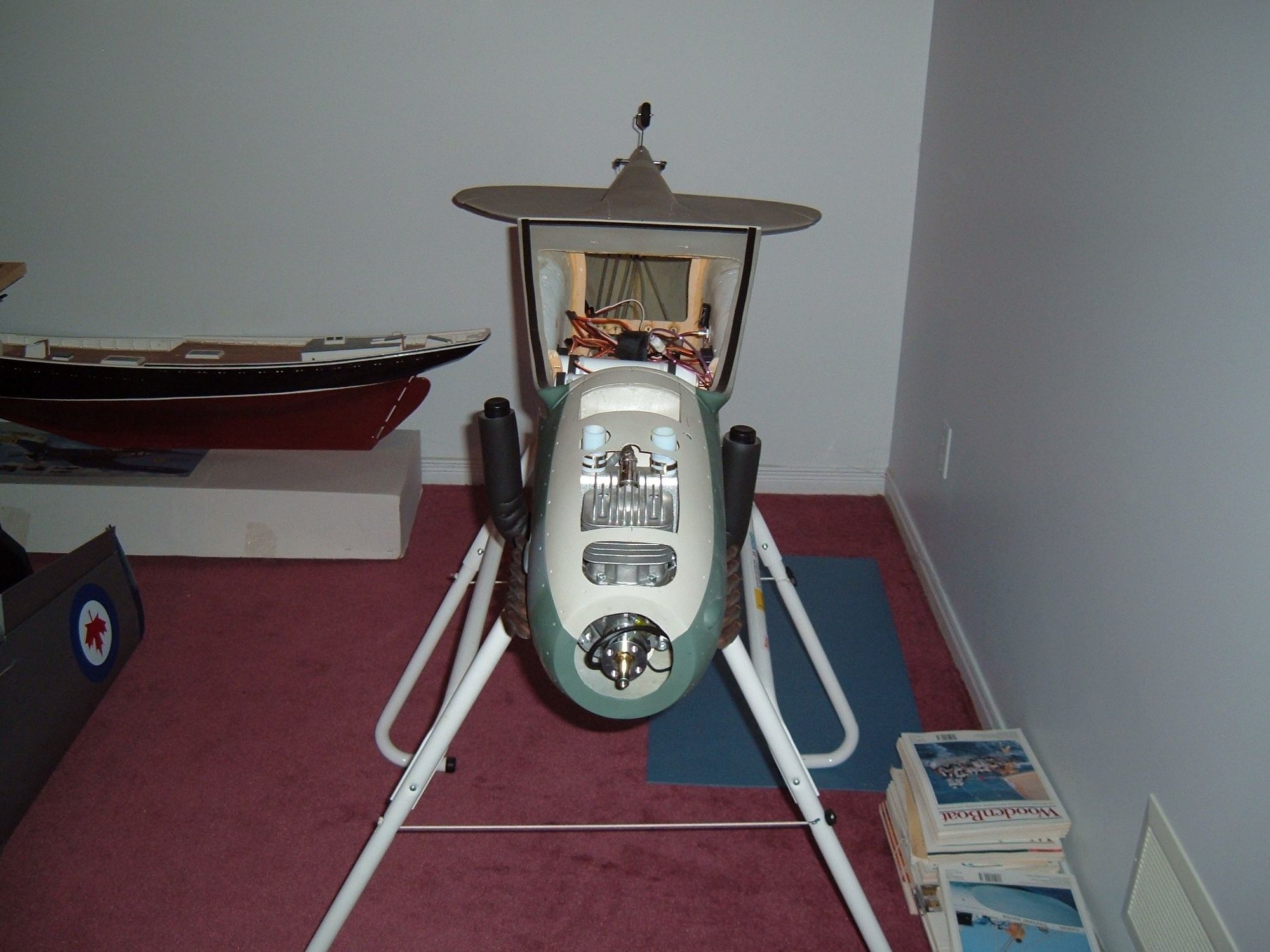

I'm not complaining about the 6lbs of deadweight I added to meet what I chose as the CG, 143mm which is 10mm forward from what the manual states, I was just relaying where I placed and concealed the deadweight that resulted in a neat clean installation.
The 6lbs of lead is hidden in the nose chin.
The ramp under which the lead is hidden makes an efficient hot air outlet.
Air inlet outlet configuration.
Neat clean looking installation.
