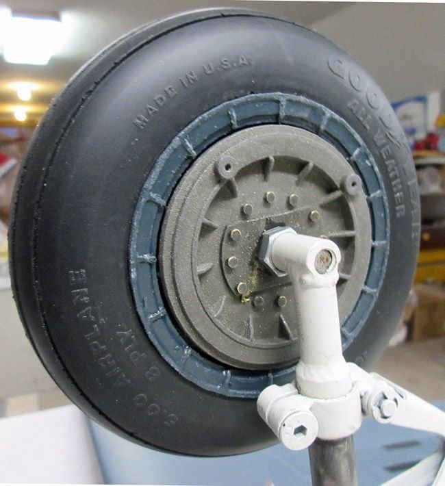

Robart makes the wheels too. The H9 set was painted white. You can buy the H9 wheels or go to the Robart site or the Tower Hobby site.

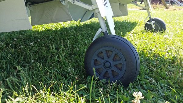

Thanks chris,i like silly power most of the plastic wheels have not held up well with my 30cc and larger models. although the aluminum wheels are expensive i think they will be a nice upgrade.

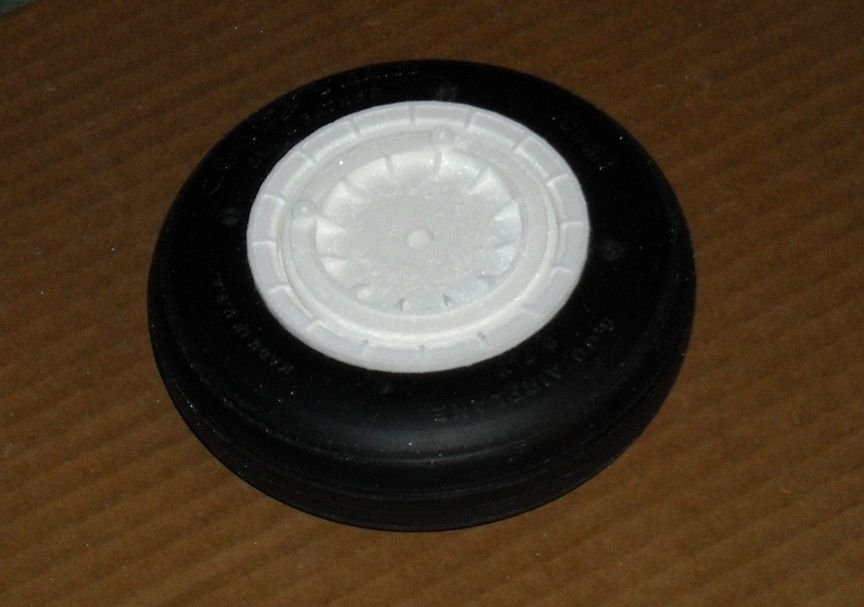

I still have the first set of plastic wheels and foam tires on my Corsair actually. All I had to do was replace a screw/nut that fell off once. Pretty durable and look ok. I like the aluminum wheels with the machined details but they are heavy. I have a Robart set for a P-51, looks cool.

these corsair wheels seem to be holding up ok so far but i had one fail on my TF FW190. the plastic hub shattered on a hop while landing causing it to go on its nose and broke a prop. maybe they have these corsair plastic wheels sorted out. the aluminum wheels look sweet but they are pricey. i think ESM had a set that were a little more affordable.i looked @ VQ but i dont think they stock them any more.

The best FW 190 wheels I have seen, and own, are from Sierra. Machined aluminum with simple details and good looking tires for the most part. Again, pricy, but worth the scale look.
I think it’s hit or miss with the stock TF wheels on the giant scale planes.

If you guys want a Corsair wheel that is both very scale and light then I may be able to help out. I have several customers for whom I have designed 3d printed wheel hubs, Corsair and Skyraider thus far. They are 3d printed from nylon and have proven to be very durable while in use on 35-40 pound Ziroli designs. The Corsair wheels are designed to fit the 5" diameter tires available from Robart. They are not cheap, the price is probably very similar to that of a nice set of machined aluminum wheels. However, they are more scale than anything else currently on the market and they are lighter which is a nice bonus on an airplane where the gear is retracting aft. Food for thought anyway. These would be suitable for Hellcats as well.
