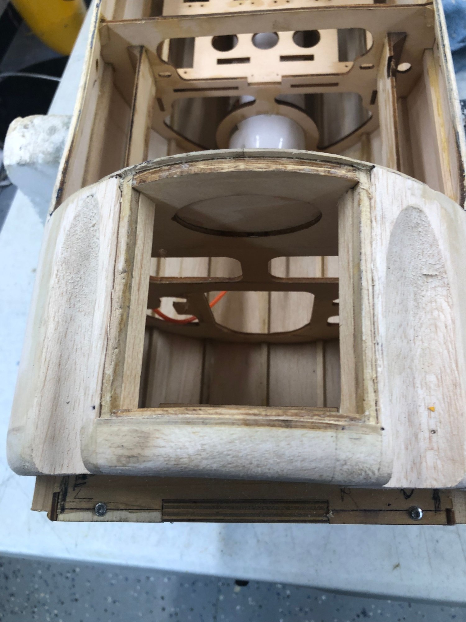

Got a hatch made today to access batteries and ignition module

Looking great!

Engine swap progress, you can see the custom engine mount for the FG84. Its made to allow the whole power unit to come out with 5 bolts. Im using the same concept to install the DLE 61. The plane flies fine with zero thrust offset.
