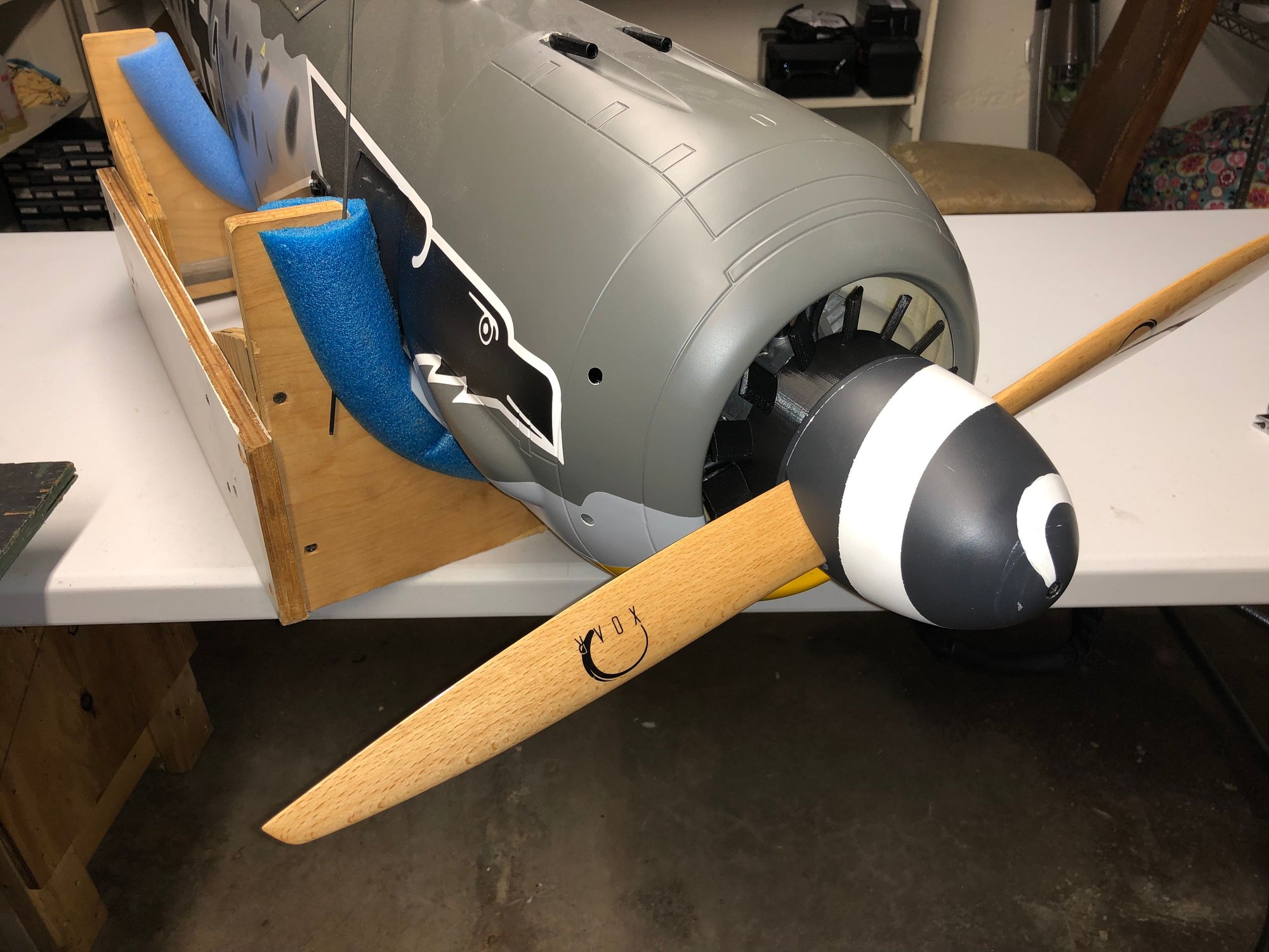

Not positive on the fit but the gear for the SisT FW has been mentioned before. I have this gear also but have not committed to cutting into the wing to find out. I'm planning on using them and changing the dihedral to the scale angle too.
I have decided to transfer the FG 85 RE-MOD engine from the Corsair to the TF FW. I'll cover that installation later on if anyone is interested.

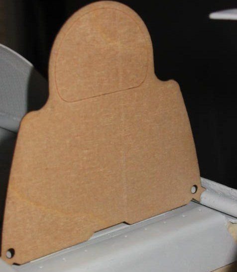

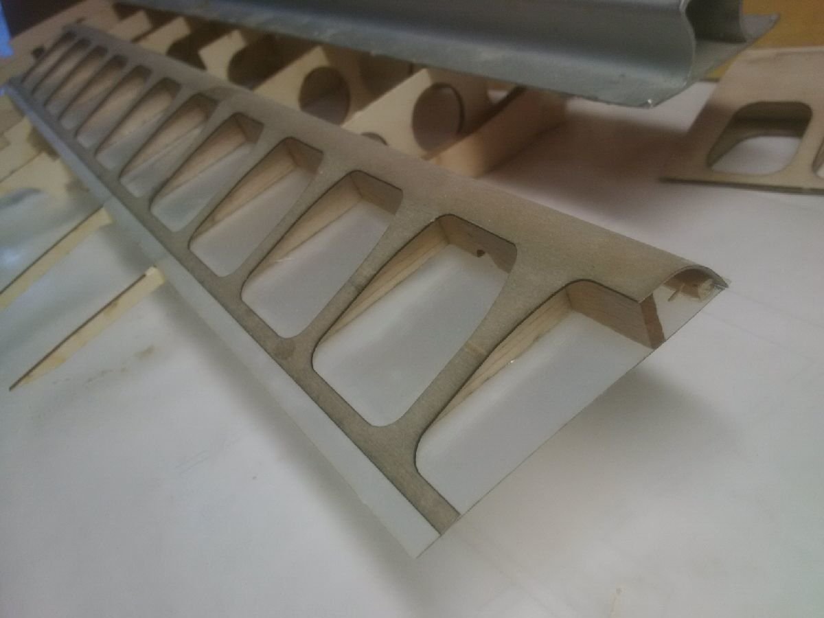

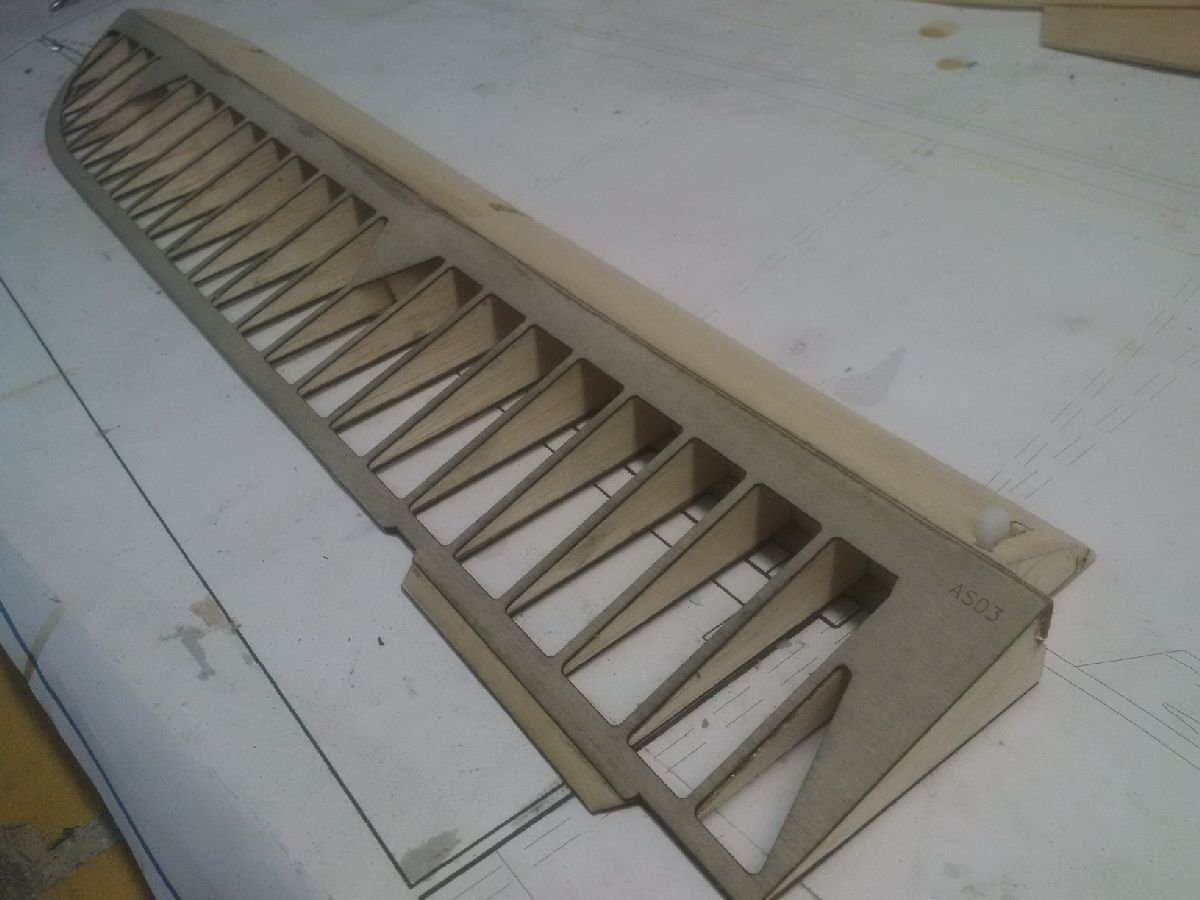

Hi All,
A new batch of 1/5 scale surfaces/weight redux kits for the Fw190 A or D model
are now available from fliteskin.com
Elevators
Flaps:
Ailerons
Rudder
Cockpit parts

Jose are these parts a direct replacement for the TF model?

Chris,
These were for the SisT originally but they are super close. DO you still have the 190 TF?
JG

Yes I have the TF arf and the original set of laser cut parts for the SisT kit too.

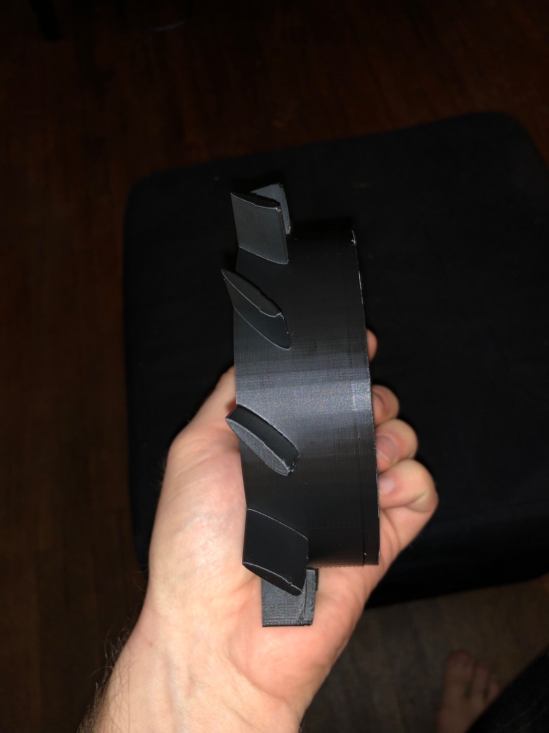

Made to order custom to your dimensions! Printed in high temperature ABS. $50 shipped.

Hi Nitroandgas,
Neat Fan! I have been printing those for TF Pilots for just over two years now. Quite impressed, that you can print them in ABS without warping. I use BDP which is a bit more temperature stable than ABS and a lot less toxic when printing.
Two small details to maybe improve your Design:
1. mine has a small lip to align the fan properly. The spinner backplate fits tightly onto the fan and its perfectly centered. Its also an indicator that the fan is perfectly round which is sometimes an issue with FDM printers.
2. I would definitly add some bridges to the bottom. You have a lot of mass on your fan (its a lot thicker and longer than my design) and I would be quite worried about centrifugal forces. You will have temperatures around 60-80 up front there and using ABS this could become an Issue...
Rev

I like the cooling fan idea....just wondering if it my fail and fall apart at high RPM's? Balance issues to boot?

Hi,
I use a special material called BDP to print the fans. They are printed solid so there is no "air" inside them. They are just as tough as an injection molded model.
The fan itself is usually balanced quite well but obviously it always makes sense to balance the complete spinner/Prop/Fan assembly once before running. Some of my fans have been running for two seasons now without issues.
Rev

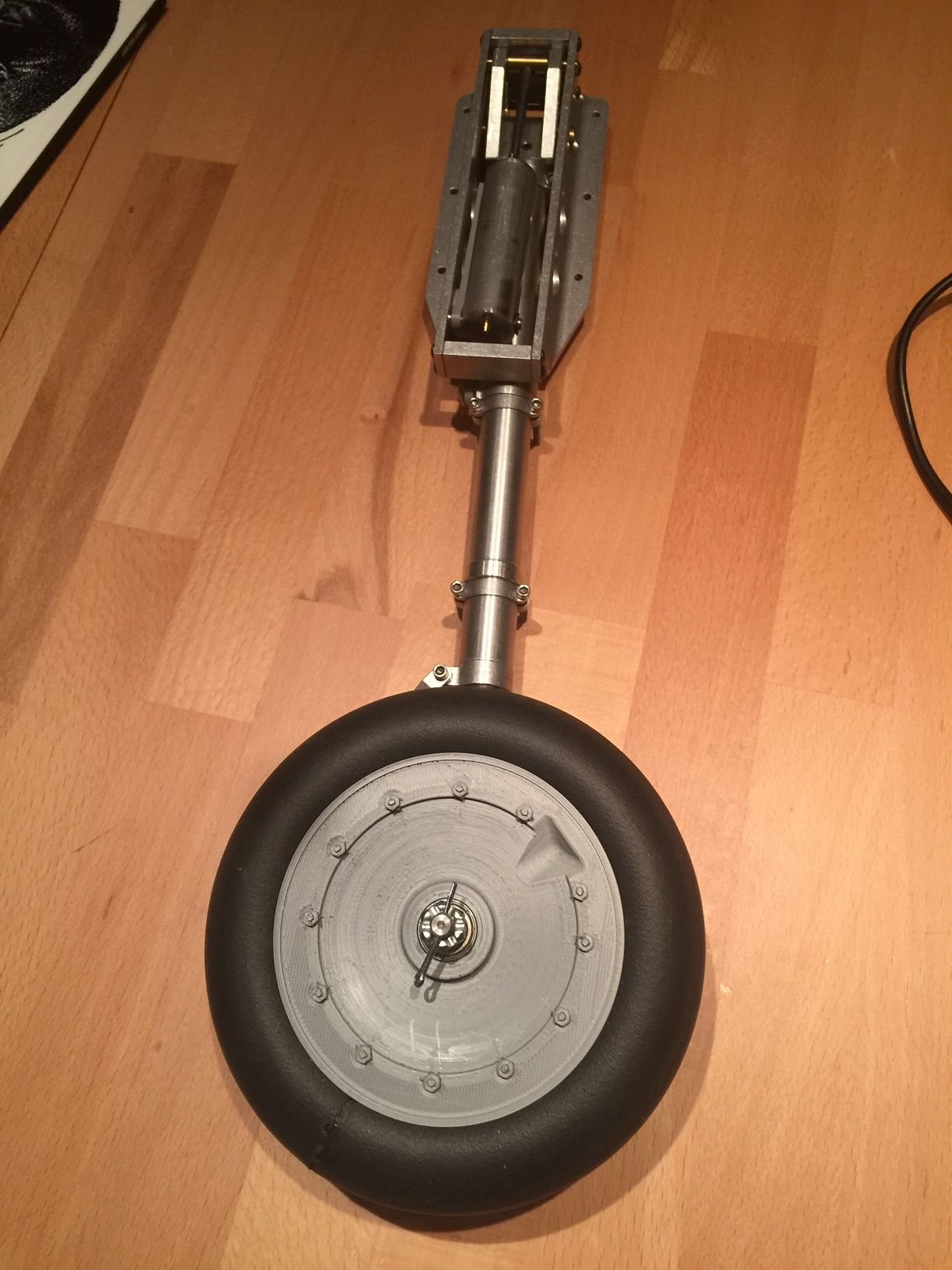

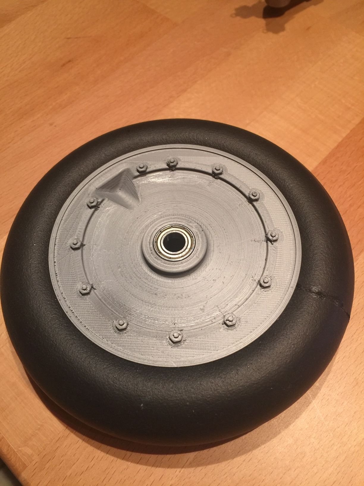

So a quick question... I have been fooling around with an Idea and it seems to work very well.
Just curious, is there any requirement for some FW-190 wheels? They are ball raced (for a 1/4in axle), 5,3in in diameter and weigh 6,9oz. Theres still some detail cleaning to do to remove some printing flush (like with plastic model kits).
I have an idea on how to get the rear to look a bit nicer but apart from that they are ready to go...
Rev

Rev, I don't know on the need or demand for such wheels, but I do know that to smooth out 3D printed parts there is a modeler named Damon (DAG) who sells engines via Atwood Aviation. He gives his engine crankcases an acetone bath. Not sure if it is acetone sprayed on or dipped, but it smooths out the rough 3D printer paths well. You may want to experiment. Or contact DAG as he generously shares the knowledge he has. Leo

Thanks for your answer. I have been in the 3D printing hobby for over six years ;-). Acetone mist is used to smooth out ABS prints. It only works with this type of plastic. Problem with ABS is that its highly toxic when printing, has a nasty tendancy to warp and the Acetone smoothing process is not only highly flammable but toxic too. Something you do not want to do very often as a hobbyist. Apart from that, it is an enviromental desaster in production and recycling.
I print with a material called DBP. Its 100% eco friendly, tough as nails and has a very high "glass-temperature*" of 100C. (PLA is somewhere around 55-60C, ABS 90-100). The only two downsides are 1. its expensive and 2. it cant be smoothed with ABS mist.
*The temperature the material becomes soft
