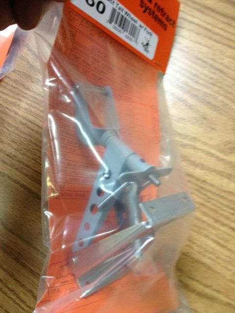

The electric tail wheel retract unit WILLNOTFITwithout major surgery on the rear of the fuselage. I just received the manual teil gear retract and that one jiust about fits. It'll be actuated by a separate servo mixed with the retract channel, and adjusted to only retract with the wheel half way pulled up.

The electric tail wheel retract unit WILL NOT FIT without major surgery on the rear of the fuselage. I just received the manual teil gear retract and that one jiust about fits. It'll be actuated by a separate servo mixed with the retract channel, and adjusted to only retract with the wheel half way pulled up.
Are we speaking of the same part#? I looked in the TF FW 190 GS manual & the opening for the pushrod looks ample to clear the jackscrew. Unless there is not room to swing the assembly into place, I fail to see why "major surgury" would be required.
What makes this option attractive to me is the sequencing of the TW retract from the main retract electronic control board. The scale-like speed of the jackscrew retract action is also a big plus.
Worst case scenerio is to remove the jackscrew & mount it forward where the servo would be located. the same pushrod that would connect the servo/TW could be used as a mechanical connection between the jackscrew/TW.
Once the cost of the additional servo is subtracted from the set-up, the added cost of the jackscrew/TW assembly would be down to less than $50. Having the sequencing VIA the electronic control board as well as the more scale like retract speed would be worth it to me.
Adding some sort of speed control to the servo set-up would further reduce the cost difference.
I talked to Robart, & the control board can not be used to control a servo.

SrTelemaster: There isn't room to get the jackscrew motor into the fuselage due to it's length. Maybe relocating it forward might work.
Even installing the mechanical tailwheel unit requires "some hammering" according the the review in this month's Model Aviation review article.
Even installing the mechanical tailwheel unit requires ''some hammering'' according the the review in this month's Model Aviation review article.
If one goes the servo route, what can be done to control the speed of the retraction & what would be the cost? Sequencing would be nice, but speed control is a very important feature.
If I can get the electric retract system for say $50 more than a mech retract/servo/speed control set-up I would probably opt for the added bonus of utilizing the control board to actuate the TW & having the slow retract speed & sequencing.
#899
RE: TF FW190 GIANT ARF
ORIGINAL: pettit
Some high $$$ transmitters have a ''slow down'' feature and McDaniel R/C makes something called a ''Go-Slow'' that slows down a servo
The "Go Slow" is $39.95.
By the time I purchase the mechanical TW, a servo & the Go Slow, I'll have almost as much in as the jackscrew actuated TW.
Looks like remote location of the jackscrew in the wing saddle is the best option for me.
