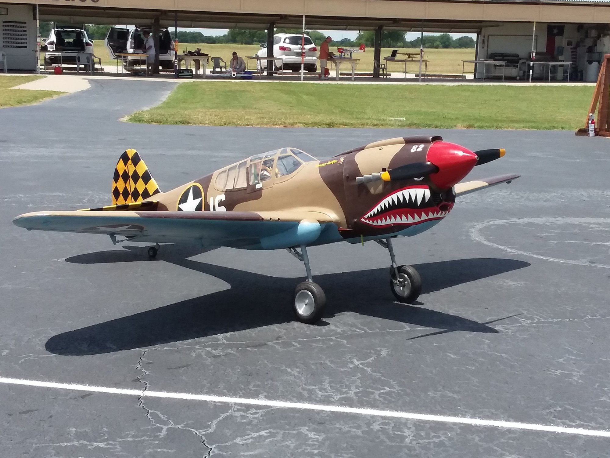

Default Tf p-40 w/dle-61
My Girl.

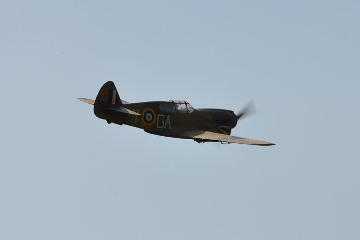

Maiden flight on the Ziroli P40 a few weeks ago, excellent, but over-propped on the zdz 80 with a 28 x 10. I wish to use a three blader, any recommendations

2 inches less diameter to go to a 3-blade. Try Aircraft International as they have a nice selection. Beila looks more scale but Mejzlik tends to fly faster. Desert Aircraft is a good source foe Mejzlik props.

Try 25x8-10 OR 26X8 . It depends on the prop . A light prop won't over load the engine Also props with tips like a knife will rev more vs a square tip prop. Another is it also depends on whether the engine is broken in or not. If new use the lightest 25 inch props .

thanks gents, the engine is well used with loads of hps...... most of the lads here use 26 x 8 two bladers which seem about right. So were looking at a 24 x ? for a three blader.

28x10 is abit much prop especially if the engine is new and the prop heavy . 27x8 or 26x10 two blade is better.

I run a Mejzlik 24x12x3 on my Ziroli Corsair with a DA 85. This plane loves that prop.

25x8 3 blade or if you like 24x10. Chances are you wouldn't like the 24x10 , performance may be lacking. Engine will rev up but forward speed may not be there. If you can see if someone at your field can loan you a 24 to try out. Try a few props and see which is best for your airframe.
