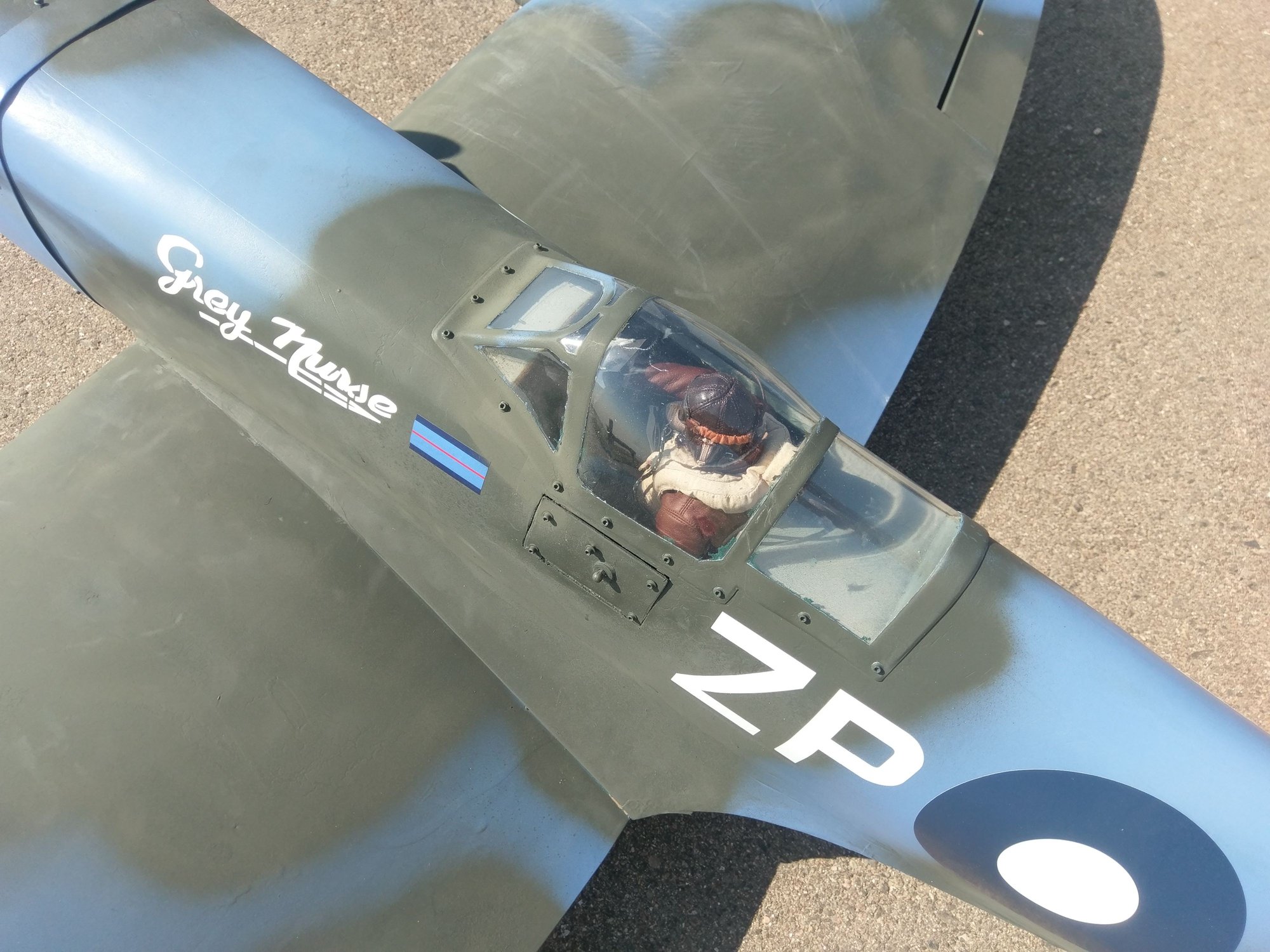

Looks brilliant chaps... but that canopy? WT'?
Shurely they can do better than that.
Old 06-05-2018, 09:45 AM
  #498
Katniss
Katniss's Avatar
Join Date: Nov 2013
Location: Colorado
Posts: 270
In the photo above, I hadn't taken the painter's tape off yet when snapping the picture.

No critisism on your work Katniss, more aimed at TF to supply such a moulded- soap type of canopy. The fit and finish of the real thing is shoddy to say the least.Shoukld be very easy to fake.
