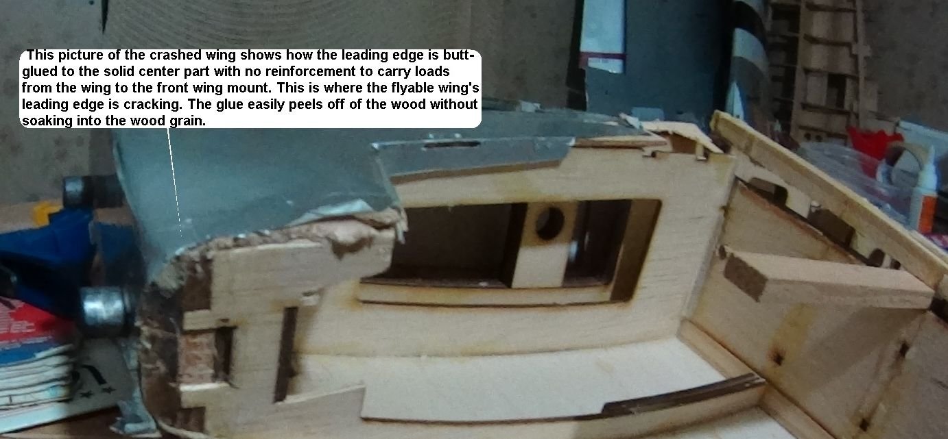

I haven't even broken in the DA 60 and my Mustang has serious cracks in the wing center section and on the left side of the fuse at the rear of the wing, just under the canopy.. I had saved a damaged wing from my first Mustang so I put some strain on the wing to see what happens. The wing in front of the spars separated from the spar structure, coming apart easily. I can see all the way through this area and found no broken wood, only separated parts, AND NO GLUE!! There is no load carry through from the wing leading edge to back behind the spars, the front and rear wing structure is free to separate. The wing spars were not glued to the wing joiner, only laying under the wing skin, waiting for enough 'G' force to tear the wing off in flight. I have two of these wings and they BOTH have the same issue! Glassing the wing center section to upgrade these wings for safe flight is NECESSARY!
The fuselage crack became evident as a tear in the film covering. Close inspection shows the left side fuse skin is cracking down to the wing mounts, the only possible repair is to glass the fuse. This second plane only has 60 flights since brand new, and had 1 dead stick landing in tall brush that damaged the left gear mount on about the 5th flight. I had to cut out the original fake wood gear mounts and replaced them with aircraft grade plywood, the parts are easily removed with a hot knife and a little prying gets them out intact to use as a pattern for real wood parts, no further gear mount problems.
I have retired this plane until I can rebuild it properly. BIG DISAPPOINTMENT!! I can post pictures if anyone wants to see this.

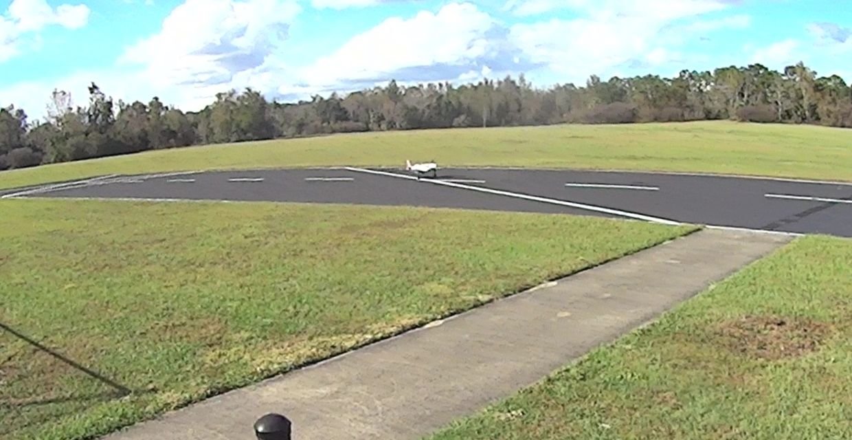

hi sjhanc ...amazing photo.

Wing cracking.

Pictures of the wing structure taken of a wing that experienced a soft crash into tree tops, then fell into thick brush. Repairable, but the parts cost as much as a new plane kit. I clamped the wing leading and trailing edge to show the lack of any parts connecting the front of the wing to the rear structure. The wing sheeting is the ONLY structural component joining the front to the rear, and neither side is adequately attached to the wing spars. The wing's structural integrity relies on the approx. 3/32" thick skin sheeting.

Picture of the back side of the wing spar.

A picture of the wing structure where the flyable wing leading edge is cracked.
In my opinion, glassing the wing center section is required for safe flight. The glass cloth should be at least 2 oz. per yard to make up for the strength lost in the factory method of construction. Too bad a full kit is not offered, this would be a premium quality model with builder control of glues and construction methods, and substitution of good wood for the sub-standard wood for certain structural parts.
The only fix for the fuselage is a full glass covering. This Model as delivered IS NOT capable of handling aerobatics, should be flown slowly, and NO INVERTED maneuvers ALLOWED. No bouncy landings, either.
I know I'm being critical, but my military job was Aircraft Technical Inspector, trained to LOOK for this stuff in full size aircraft. I had to butt heads with maintenance officers, mechanics, and pilots many times over RED 'X' safety of flight issues with planes they wanted to just hop in and fly. I always refused to sign off on my inspections until it was repaired or adjusted properly, I always won the argument.

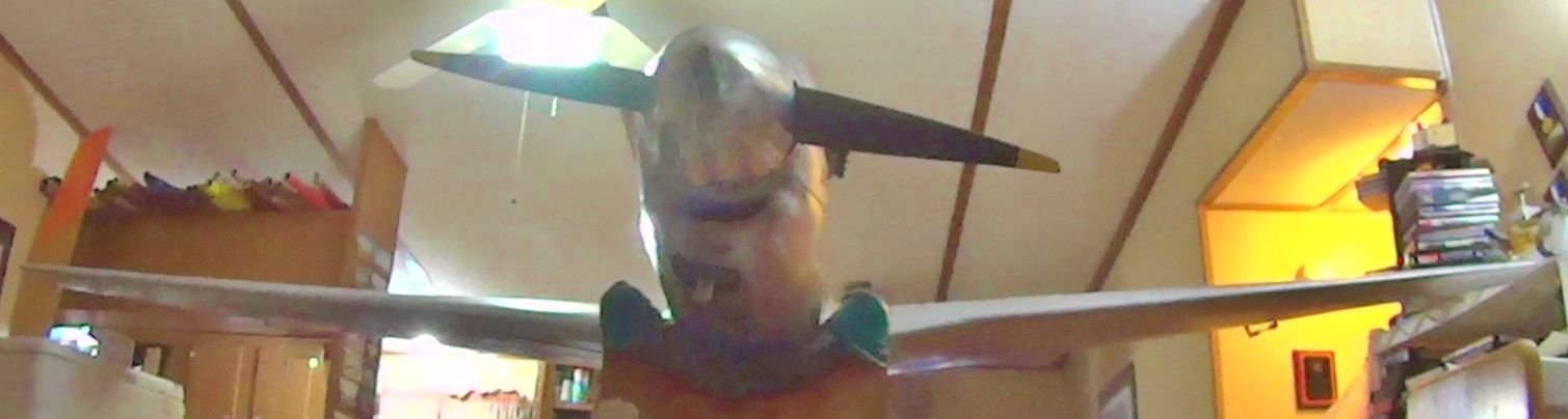

These pictures are of my James Bates P 51 B. Sorry about the poor quality, I am down to only one camera, and it is low resolution. I will post better pics when I can get my best friend Bill to go out with me and take some flying shots. I can report that it is a fine flying model, at least as good as the H9 P 51. The stall happens at about the same low speed as the H9 model with a slightly sharper break after it is forced to stall with the engine at idle holding up elevator. Maneuvers are fast and smooth, I have done most of the maneuver list I use at scale events.
I took it out to fly about 2 weeks ago for a single test flight. It went well for the entire flight but got left gear mount damage when it hit a dirt mound (fire ants or lawn rats) on the roll-out in the grass. It was easily repaired with spare wood parts and a new upper strut tube, no actual wing damage. After an inspection finding no issues I got a break in the weather and took it out for a second flight a week later. This time I landed on the black top runway and the final landing was very nice. I quit after this flight due to cold weather late in the day.
At 26 lbs. plus fuel it is lighter than my other Mustangs and acceleration from slow speeds is quicker. It also holds its speed better during pull-ups to vertical flight or rolls, I can pull it over at the top for the dive, the others slow to almost stall speed, then I have to do a stall turn to come down. The take off run was long on the first flight, needing up trim to fly level. After it was trimmed the next take off was much shorter. The engine is still breaking in, its previous use in my other two Mustangs was not enough to finish the break in.
My engine cooling methods were refined for this plane, it is the cleanest I have done so far. No overheating issues were encountered after a ten minute + flight with 3 touch and go landings before the nice final to a full stop. It is winter in Florida now, opportunities for flying are only a few hours per week between cold fronts. The ambient temp on the two days I got to fly it was in the low 80 degrees cooling rapidly as the sun went down. My only complaint is the spark plug and its lead sticking out to spoil its profile. I have posted pictures of the engine cooling baffles in previous posts in this thread.
I was concerned about weight build-up when applying the glass finish so I didn't go for a completely smooth surface, a little of the glass cloth weave can be seen close up. I used Rustoleum titanium silver primer-paint for the final paint job, it is shiny when applied so I rubbed the shine off with 4-aught steel wool to flatten the shine on most of the model, some panels were intentionally left shiny for a more scale like finish. I will be starting another build of this model soon to do a better job on the final finish.
I balanced the plane on the plan's indicated CG, it is completely stable in flight so I won't experiment with CG locations and will build the next one the same. I will do the cockpit and canopy when it makes it past 20 flights.
