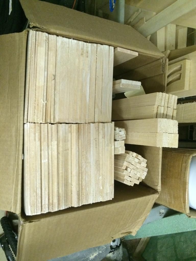

Since the pancakes are getting closer to being done and the F-14 needs a bunch of CAD time and Money to finish it, i started planning the next project back in may.. I'm a FW-190 nut, so why not do the Premier 190 in the form of the TA-152H and then take a known performer in scale competition and good flyer and make it (better?) bigger by blowing it up 125%! It didn't help either than Evan twisted my arm a bit when he found out my evil plans and offered to buy two...
First up was getting the anderson plans and enlarging them 125%. This gives an airplane with the following dimensions:
142.5" wingspan
107.5" Long
Maybe 125% is a bit to big? NEVER! plus its a three piece wing, so it makes it doable
I also took a few nights to draw up a VERY detailed set of CNC machined main landing gear struts for the TA-152 as the Sierra gear just wouldn't look right IMO on this thing. Price wise, they will be within $100-200 of the Sierra gear and will have ALL of the gear door mounting bosses and detail you would see on the real strut machined into them.
For reference, i'm using the following two books:
And purchases this "blue-print" DVD set off ebay, it contains a good bit of prints, but not a complete set like you would expect by reading their description of it:
Then I took the plans, had then scanned and began converting some of the parts into CAD for laser cutting. Basically all of the wing parts are laser cut, while the fuselage parts and vertical stab parts were hand cut. The Horizontal stab ribs were modified to allow a 2 piece removable stab and cut on my CNC router. The stab was then built (over 2 months ago!) in about a 2 night stint.
Then using some 1/4" Luan underlayment all of the fuselage and cowl bulkheads were cut:
Then the balsa tail parts and thin ply portions were cut out to give a complete fuselage and tail section short kit:
I also received my laser cut wing ribs a few weeks ago.. The balsa ribs are 3/16" with a 1/8" ply and 1/16" ply doublers to "sandwhich" the ribs:
And a HUGE box of balsa arrived as well as some 1/4"x1" and 1/2"x1" Spruce for the wing spars:
That pretty much brings everyone up to date.. I'm waiting on the wing tubes and sockets to arrive, then I can begin building up the first wing panels so I can have all of the sub-assemblies needed for the fuselage.
Which brings me to the next bit of the project.. Since Evan is getting two and i'm building my own, i'm going to detail and mold the fuselage (which means Fiberglass short kits will be available, pricing already determined ) . In order to help offset some of the costs of the tooling and the landing gear design, i'm thinking of doing a kickstart project to help offset this cost. In this kickstart project, will be a few different rewards (a pair of 1/4 and 1/5 Rivet "burners), DVD how-to series of Detailed (much more detailed than what i put on youtube or build logs) plug construction, detailing, molding, vacuum bagging etc, and of course some TA-152 short kits (and short kits with landing gear)... If any of you guys are interested, i'd like to hear as the interest dictates whether i take the time to do them or not.
Also since the Pancakes are not done yet, this is a project that gets attention while the pancakes have stuff drying on them, so it will probably be early to mid fall before things Really start to progress onwards (i was hoping for late august, but life (mostly work) keeps getting in the way).
