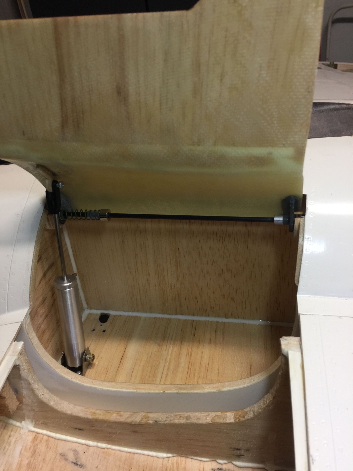

I couldn’t find door cylinders online to fit my inner gear door needs so I had Sierra Giant Scale make me a set: 1/2X2 inch. They’re perfect. Darrell at Sierra does beautiful work.
if you look closely you can see where I mounted this cylinder first. It was too close to the hingline allowing flex. Bottom picture shows how new position results in much better triangulation.

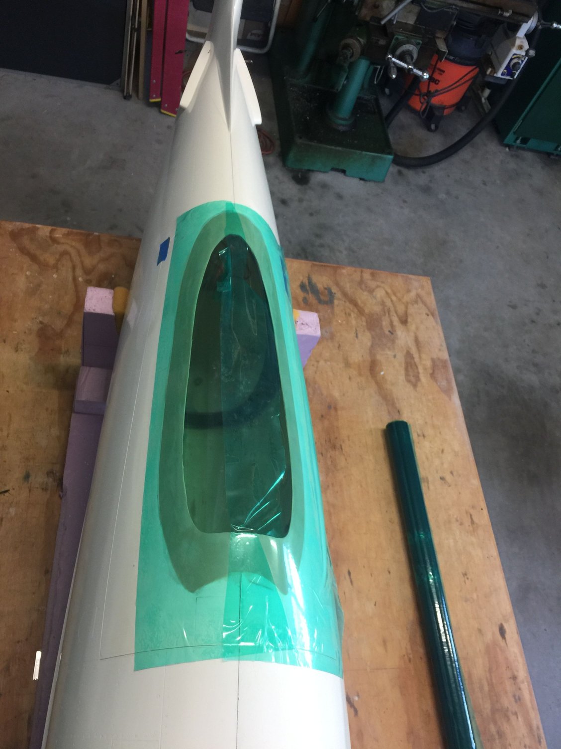

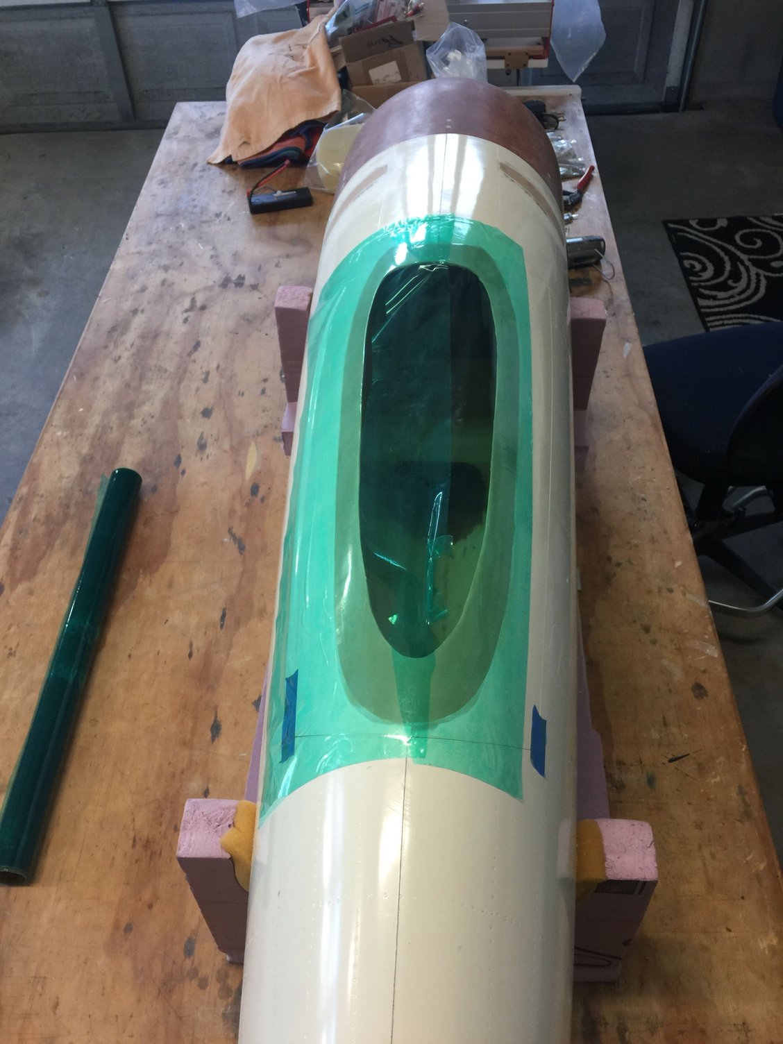

Well, after 4 years the day has finally arrived. It’s time to close the hole in the fuselage for the smaller canopy. I have been dreading this literally for years! Didn’t really know how to approach it but I think I figured it out: I used some very nice 1/32 basswood sheet to back up the hole. I covered this wood with release tape then glued it in place.

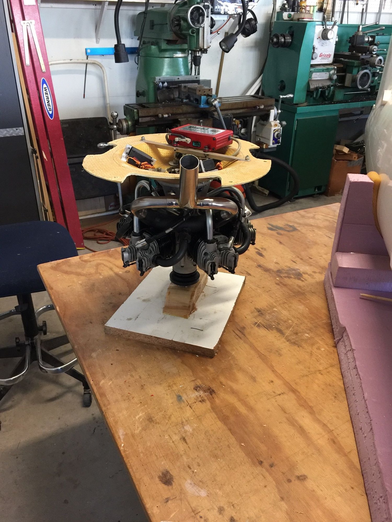

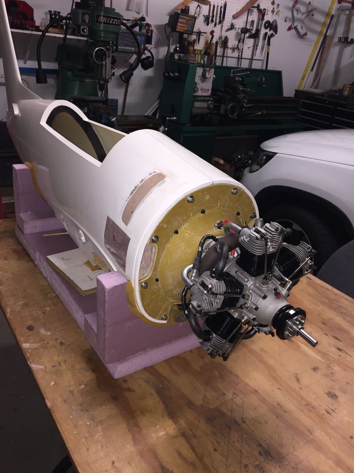

Took a break from spinner work to install a bulkhead in back (the one on top). With the motor on and holding the plane in the cradle I could flex the tail more than I liked. Detlef said this would happen!! This aircraft with this engine is going to be FURIOUS at speed so it’s best not to take any chances.
This small bulkhead is made from the same material as the rest: carbon-sandwiched foam. Super light and amazingly strong when installed. (Actually, the tailwheel bulkhead is carbon sandwiched ply).

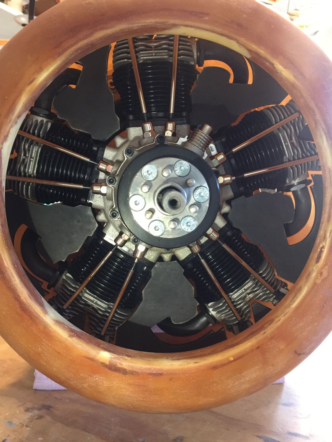

I ordered 6 oz bias cut carbon cloth and cut in to 1/4 wedges. I then laid them in place dry and wet them out with a brush. There’s just no way I could do a vacuum layup on this component. An important final step on every layup is to repeatedly scrape the brush dry and blot the layup until no more resin will come out. Yields surprisingly good results. This whole process would not be possible without the supple bias cut cloth.
#295
My Feedback: (7)
I’m pretty happy with the outcome. Took some wet sanding to get smooth and a bunch of pinhole work yet to do. It’s huge but only weighs 7 ounces. FYI- starting from outside in: 2 layers 3oz bias glass then 3 layers 6oz bias carbon. I think that’s just right, structurally. Around 2mm wall thickness.
