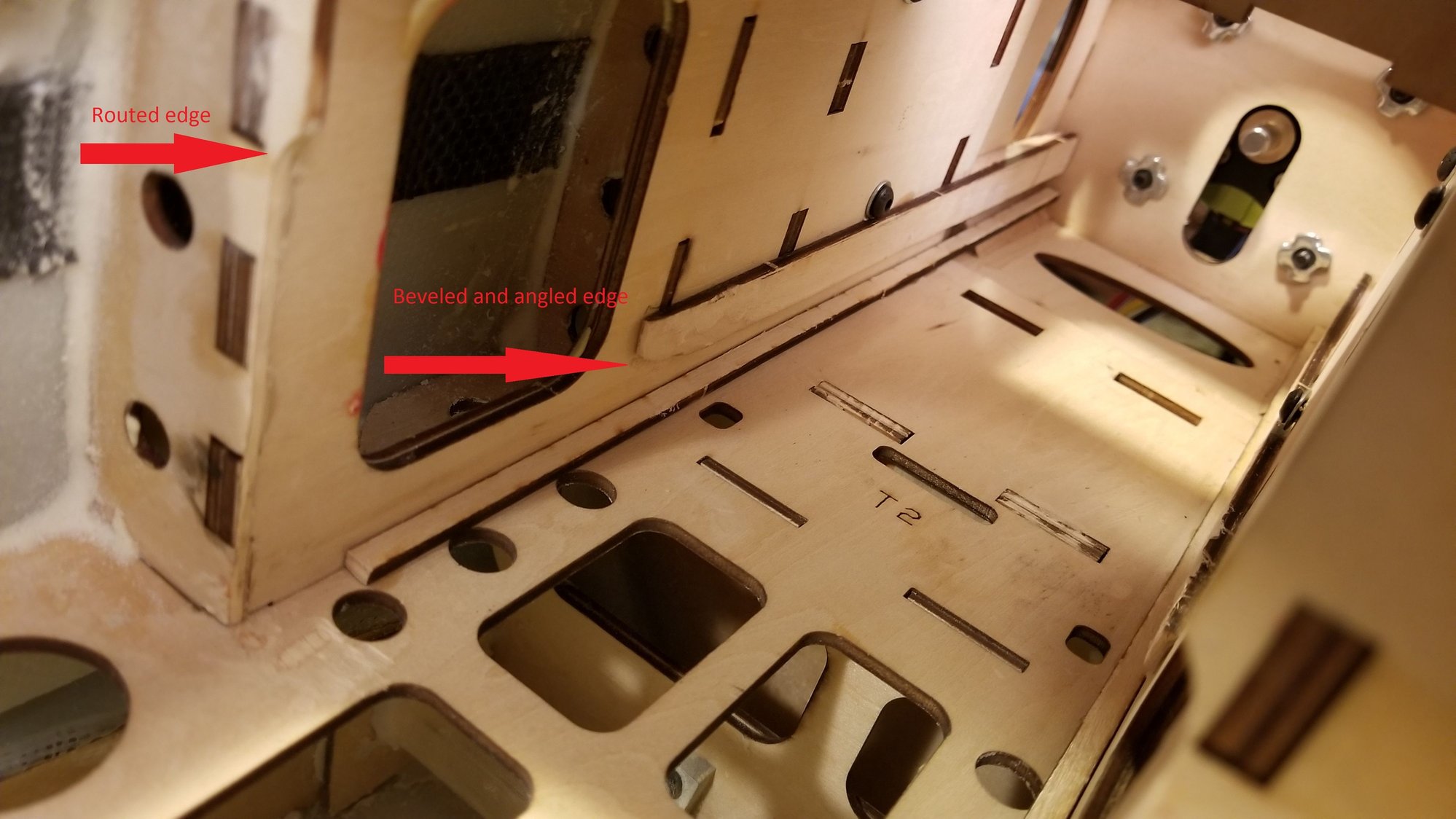

Most of the build has been completed for some time, but I thought I would share a couple tidbits which may help new builders.
For the battery tray placement, there are a lot of ways to lay out the strips, but I found that the small narrow strip in the bottom, and the larger strip on top with clearance for the tray gave me the most satisfaction. I also beveled the back edge of the uppermost strip to allow the tray to slide in at an angle, makes it so much easier.

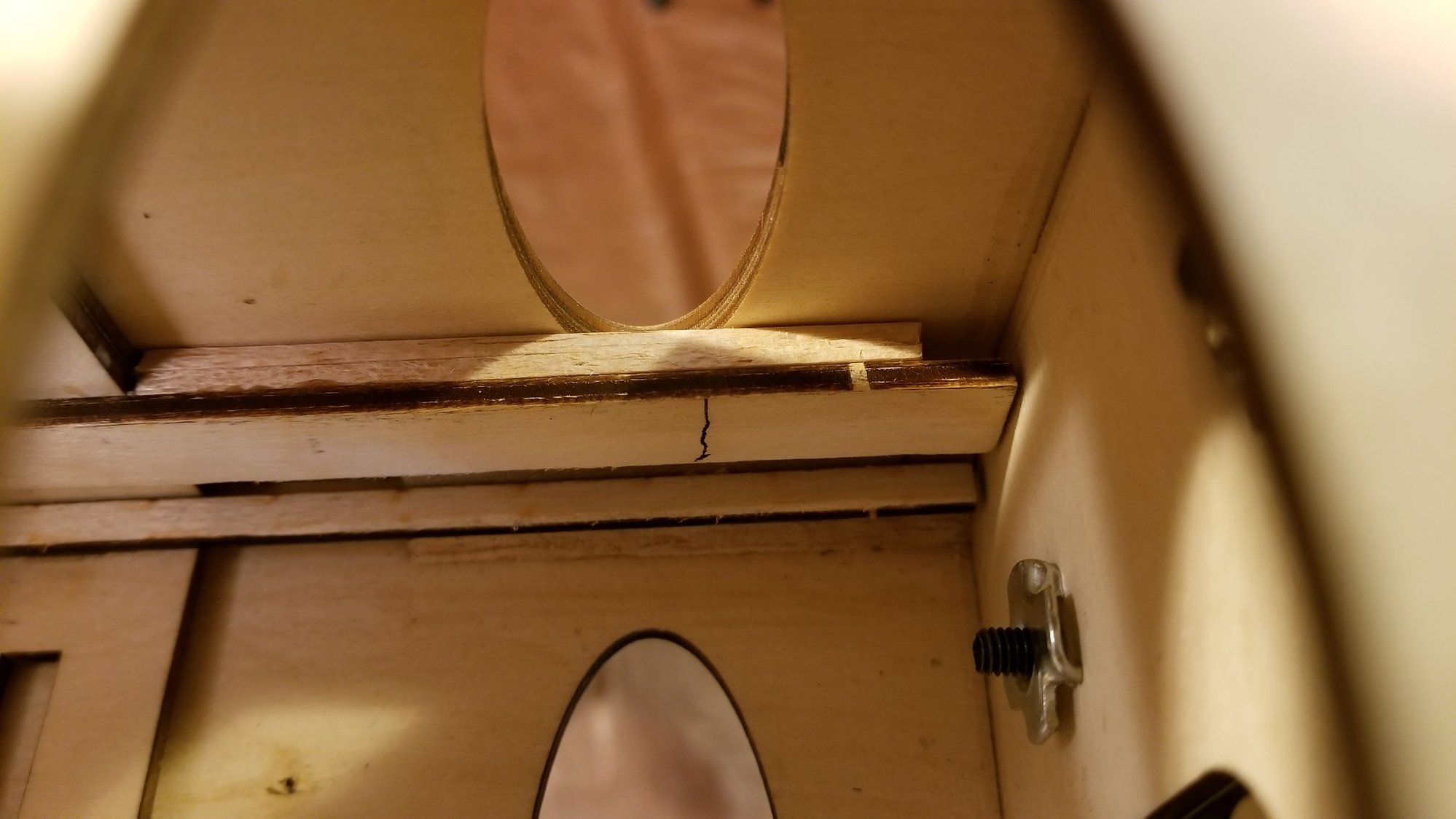

I also added further support up front so when inverted, there is more to hold the large batteries.

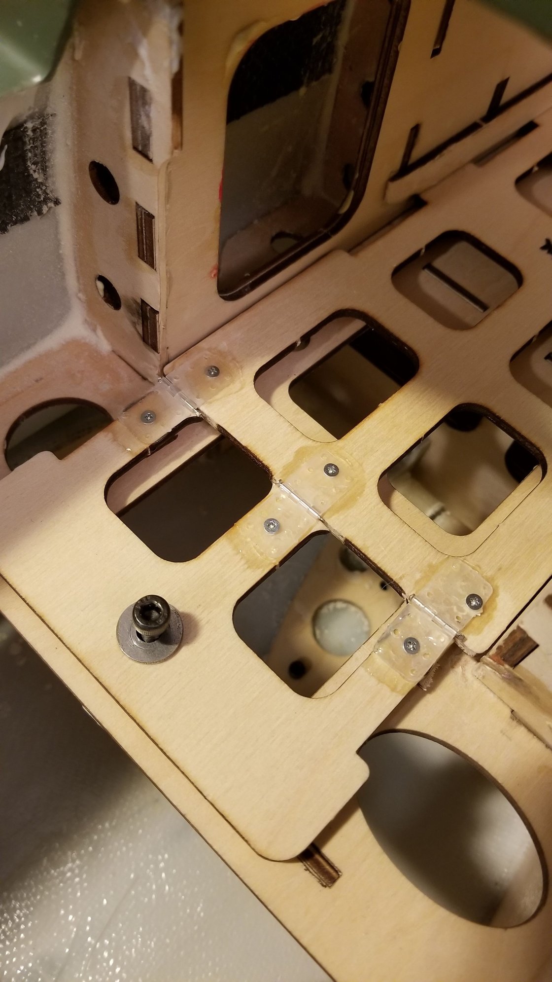

I hinged the back portion of the tray so that I could fold it, and lift it over all my electronics and power box. Yea, might be a bit of overkill, but that tray will only flex so much!
I decided to bolt rather than glue the motor box to the firewall with button head 4mmx16 screws. 15mm would also fit. The button head on the inside sits flush with the battery support strip so it wont be punching into your (well-secured) batteries.
BTW, with the side strips in place, there was only about 87mm width for batteries, and I found that my Zippy compacts 5s-5000 fit just fine, but my Zippy Flighmax 5000 were just too tight and wide.
Not too long I hope for the maiden, just a bit of soldering for the battery extensions, and some sort of duct upfront thru the scoop to aid in cooling.
Cheers, DSA
Bevel top strip and dremel-off/widen bulkhead
Extra support for front of top rail when you go inverted!
Hinged battery tray for easier removal....
...to clear the electronics.
Button heads on the inside don't poke out any further than the strip.
Nuts on the outside, with locktite.
