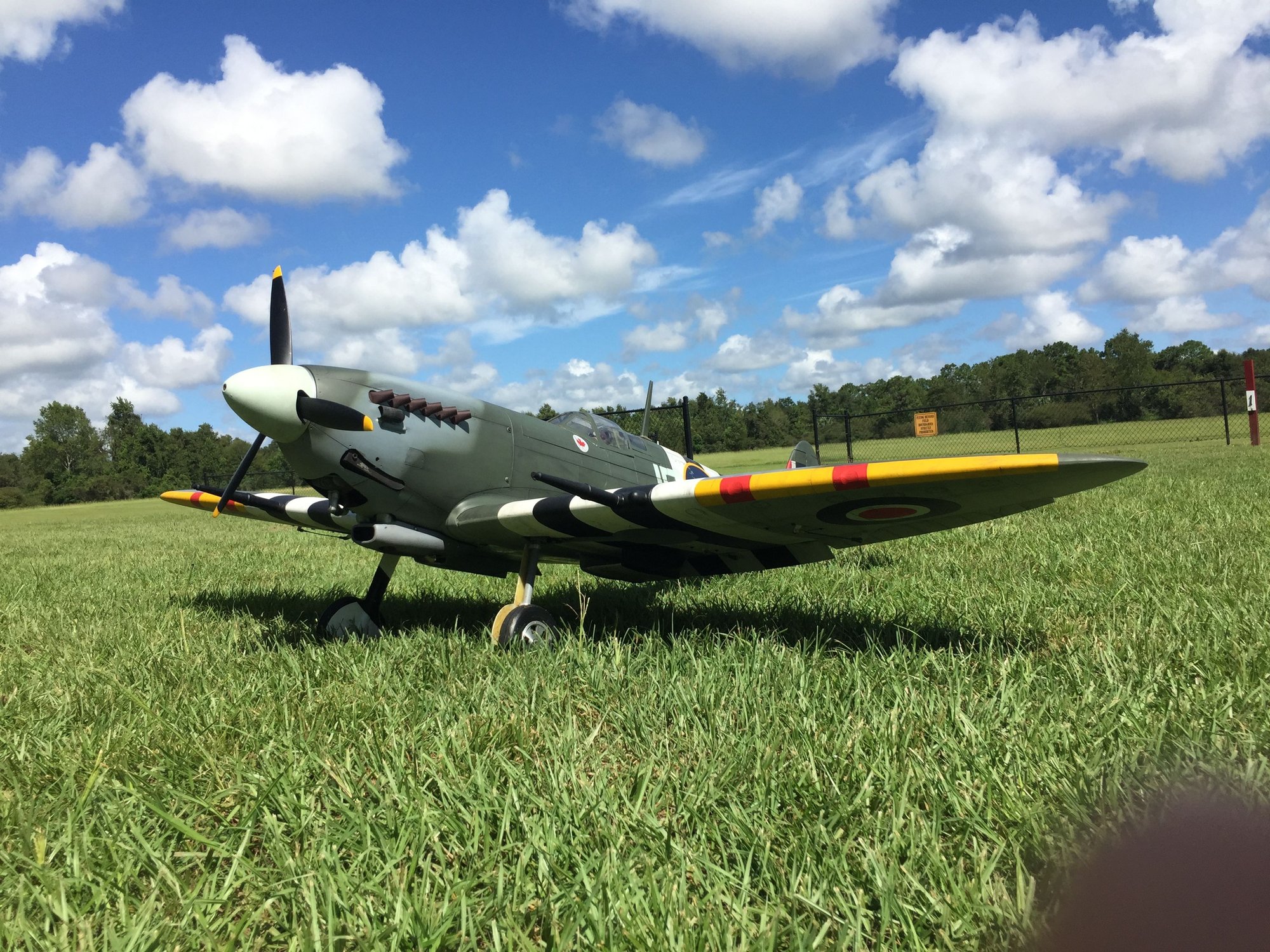

Das44, can't help you much. Never got the cg with gear down. I can tell you there is not much trim change from gear up or down. Got a couple of flights in today. Total of 20 flights on the plane now. Here are some pictures from the field.
