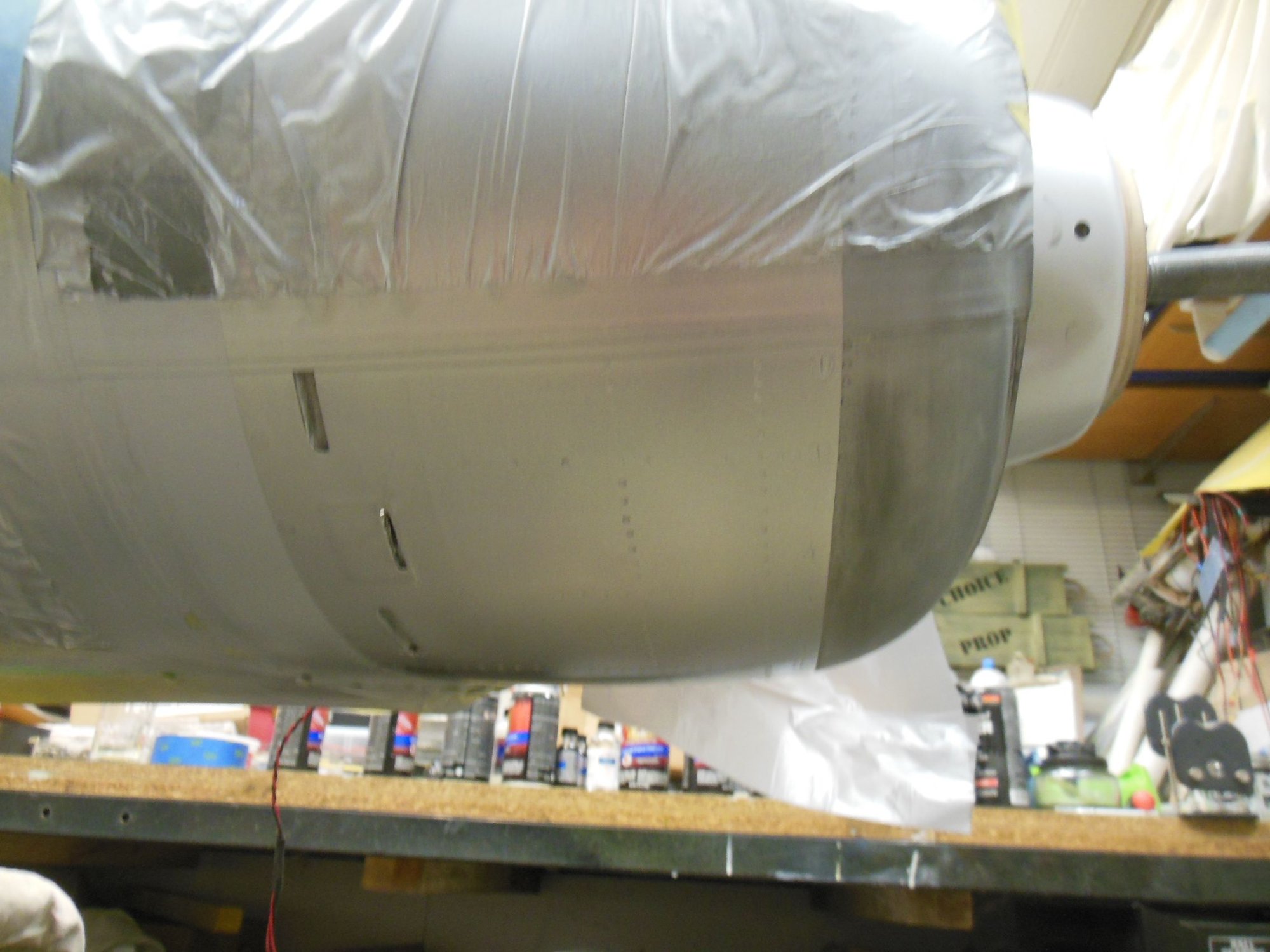

Basic paint base. first coat, black. Then I used several different shades of aluminum for the different panels.

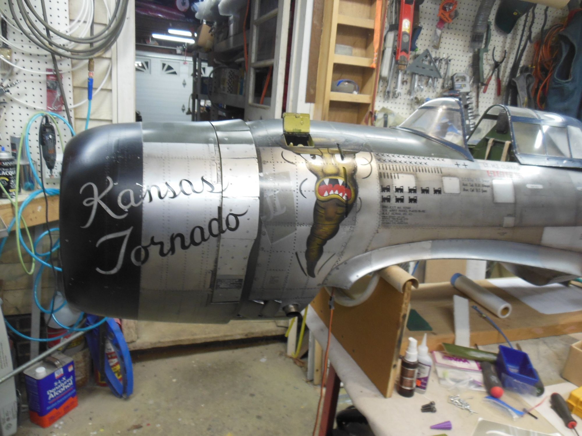

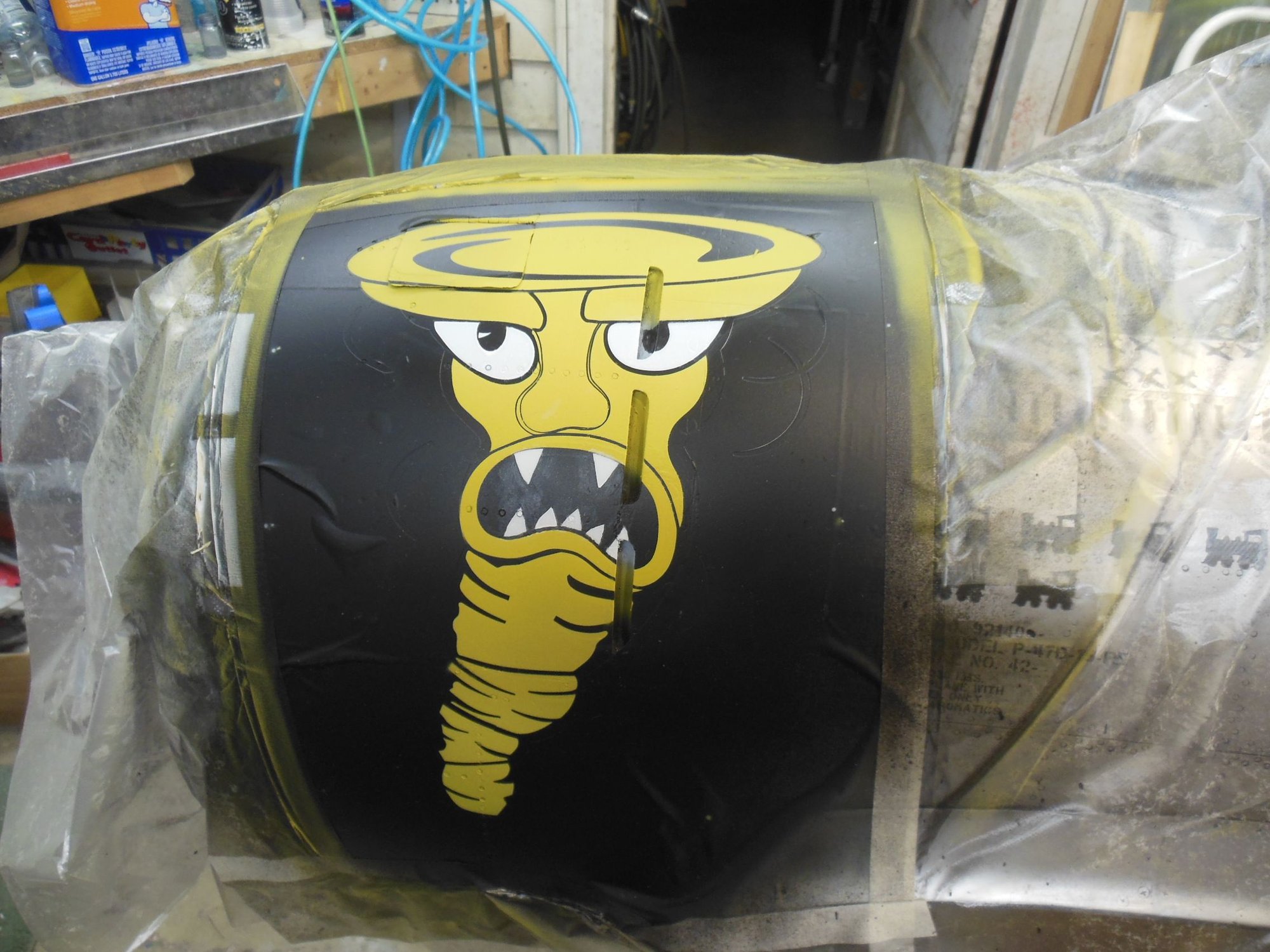

More painting. The Tornado goes on then the weathering.

Repairing the exhaust trim where the waste gates were. Graham did a wonderful job on this.

Nose art restoration.

Originally Posted by f4u1 pilot View Post
Nice work Gary! who's paint masks are you using? I like the clear mask and index markings.Looks like it won't be long before it's flying again!
Graham in the UK did the original build. I was provided the masks and graphics from the company he uses so they matched. Flightline does an outstanding job.

Having said all that, although the index holes are very nice and would no doubt make it easy on a flat surface, they didn't help much on this compound surface. After the first mask, I had to cut the rest apart to get good alignment. No big deal, just very tiedious. Overall I love the Flightline material and craftsmanship. I highly recommend them. They also supply lots of support information for location.
