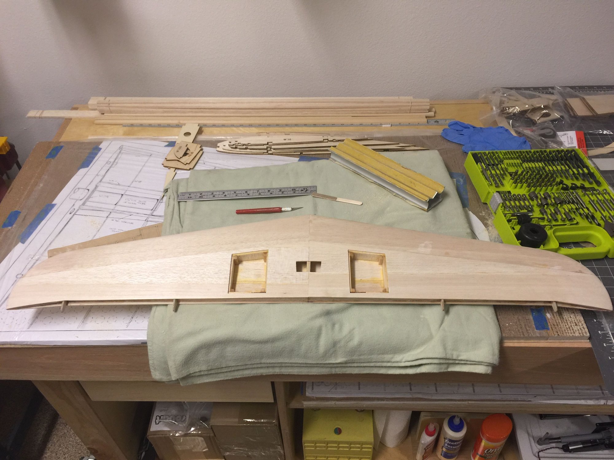

Hi Folks, I'm still here and have been making some progress. I need to get caught up on posts. By the way, I did some closer looking at my SBD books and see the hinges. I was focused on the actuating arms and totally missed the hinges. Thanks for not embarrassing me.
I decided to move on an build the stab. I used the same servo approach that Sam used and I figured if I changed my mind, I could just close up the two servo pockets.

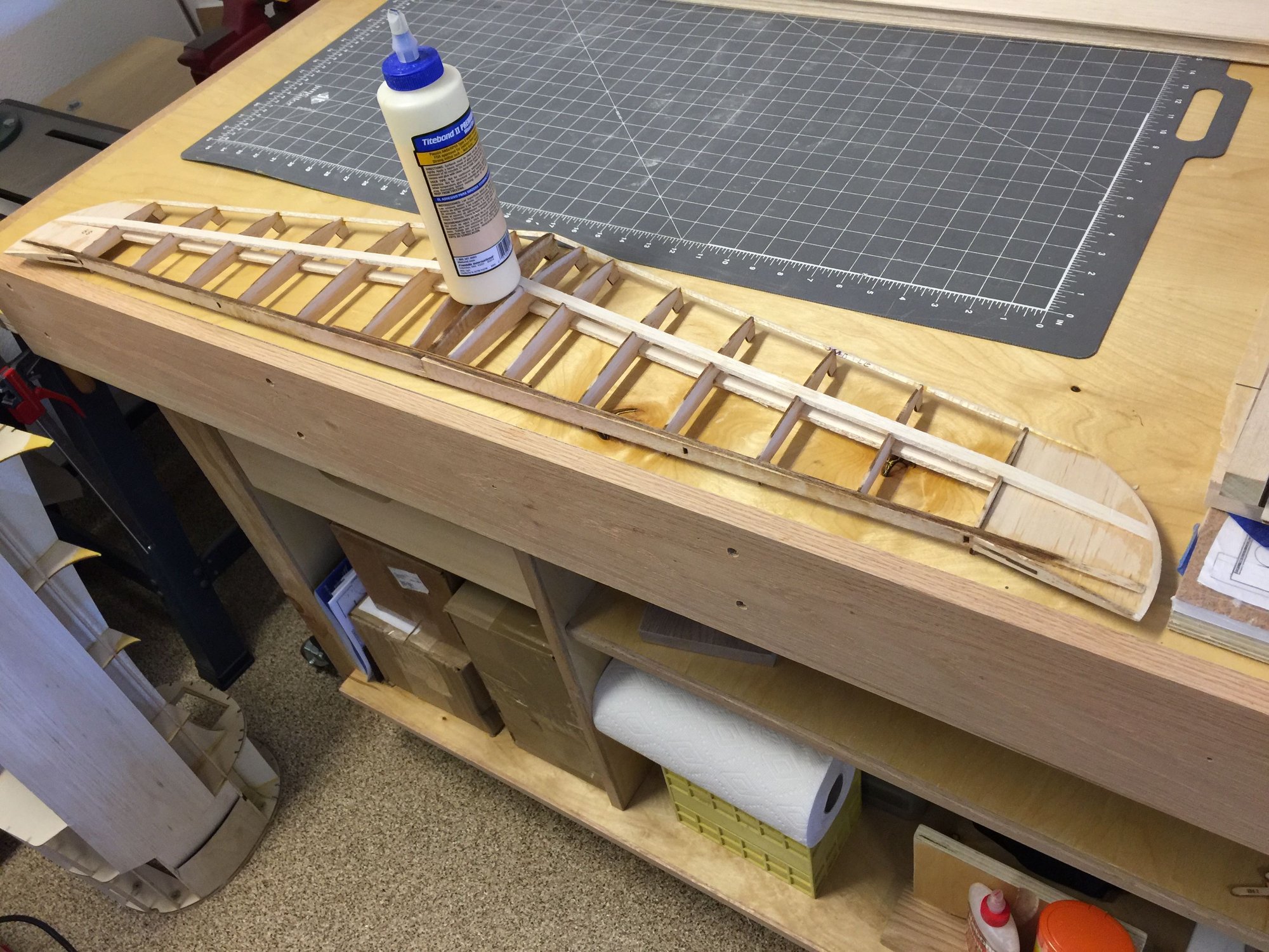

The wing assembly was straight forward. I put in the same shear webbing out to the tip as Sam did. I found some of the ribs to fight back on alignment. In the past, I would have probably pinned the rib ends down in place, but after thinking more about this, it's only like constraining a spring, and it's only bound to relieve itself in a twist later on. So I prefer looser joint with parts that lie naturally aligned. I think I'm the last one to figure this out. (Hey, I'm not sure why these pictures are posting so huge. Let me know how to resize these - thanks)

Basic framing completed and sheers added on both sides of the main spar.
Getting the flaps and brakes prep'd for the wings. Used the same approach that was used for the center flap. The Nelson hinge was scuffed and epoxied with a layer of 1/32" ply on top.
Rib placement was changed to the scale positions.
Sheeting added from main spar back.
Used Robart 3/4" 331 control horns attached to a ply base and set in epoxy against the main aileron spars.
G10 hinge points were added to the elevator and sandwiched between plywood. I did my best to get this set in epoxy and attached to the spars.
Beginning to layout the servo trays and hatches. I have seen more recent orientation of the servos on the side for the aileron servo. It's either this or going with way of a low profile servo as there is not much room toward the tip of the wing. I also moved the servo location out to mate with the control horn placement. A little closer to scale. I added to the wire tube.
