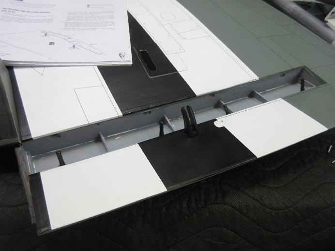

Finally started the assembly.
Actually read the instructions.
Wings:
A plastic bag with the 4 control horns and hardware.
Some 20mm long screws to secure the control horns to the flaps and 30mm for the ailerons.
Horns and pin hinges are nice quality.
They used screws as hinges on the pin hinges so, in theory, you could remove them.
Put oil on the center of the hinges to keep out the epoxy.
Need to put the horns on first before epoxying the flaps to the wing as little room for access with a hex driver (need a metric for it).
Initially, thought the hinges were epoxied but they aren't.
Impressed by how many hinges on the ailerons.
Hinged the flaps/ailerons and, after the epoxy hardened, they were epoxied to the wings.
I held the control horns while applying the epoxy as it's easy to get epoxy on the wing, flaps and aileron's surfaces.
I still had to use alcohol to clean up all the surfaces of oil and epoxy.
Filled the radiator vents with spray foam as, sooner or later, I'll land with the gear up and this will prevent from damaging the radiators: (may come off the wing but will be in one piece).
One of the radiators was deformed but it shouldn't be noticeable under the wing.

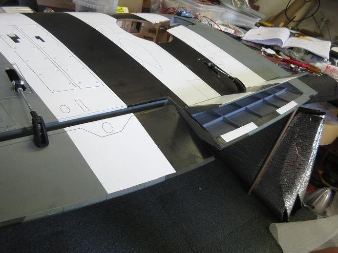

wings (cont)
Made 4 extensions for the flaps and ailerons.
Right wing install of servos and hardware and adjusted with receiver.
Set ailerons about 3/4" and about 45 degrees on the flaps.
Made 2 Y extensions to lead to each wing half for flaps and ailerons.
This is a 2 piece wing where the each wing connects to the side of the fuse versus the bottom.
Left wing completed.
In case I do something stupid, heavy duty FG cloth from my local auto shop and some finishing resin.
Let that 'cook' overnight.
Actually, until Monday since I'm going to a local flyin on Saturday plus railroading on Sunday.

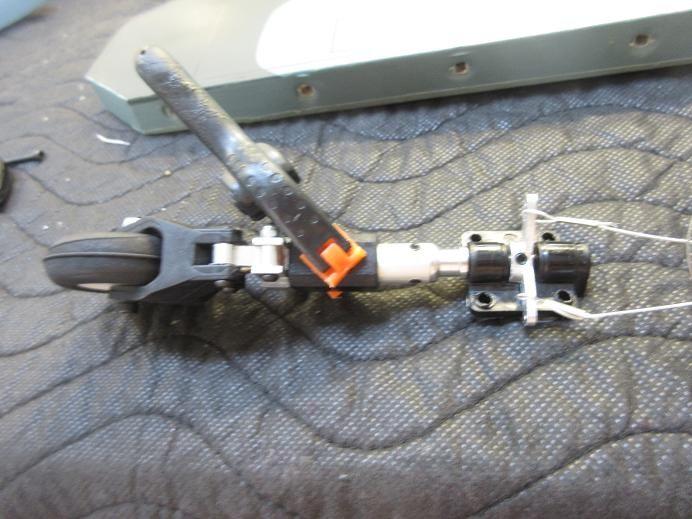

Tail wheel:
I see a few had their tail wheel supports break off so I'm replacing the original 4 bolts with longer hex head bolts that will go into the fuse former. Had to used a drill bit CA'ed into some brass tubing to be able to drill holes into the existing holes and into the fuse former. Will also be putting extra epoxy and cloth around that area.
Figured it would be easiest to, first, add the tail gear and pull wires to the black plastic support before re-attaching it into the fuse.
There's a two piece black plastic provided that is CA'ed to the tail wheel oleo.

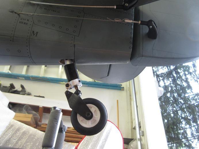

Tail wheel:
Glassed that area and put larger hex head screws that went through the fuse former.
The instructions show just looping the pull/pull wires directly to the tail wheel control arm:
There is no room to make adjustments at the servo end so clevises with adjustable ends were used at both tail wheel end and servo end.
This holds, also, for the rudder.

Tail wheel:
Clevises and hatch in last two pictures.

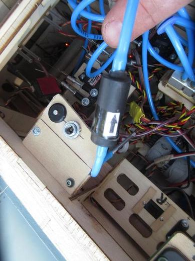

Velcro'ed the receiver to the same tray that the air tank is on.
Since it's difficult to insert any wires into the tray'ed receiver, the last two servos (gear and choke) were connected.
The air tank to a festo fastener was also connected.
One air line to the air valve was connected and placed into it's spot on the servo tray.
Needed my hot air gun to soften the blue air line to get it on the nipples.
Presently, I'm leaving the other air lines off that go to the wings as it appears I can make them extra long with the festo fittings resting by the fuse where the wings join. Hopefully, I can, then, easily just connect the wing air lines where the wings join versus trying to route them through all the tail surface rods/wires. Same with the flap/aileron connections.

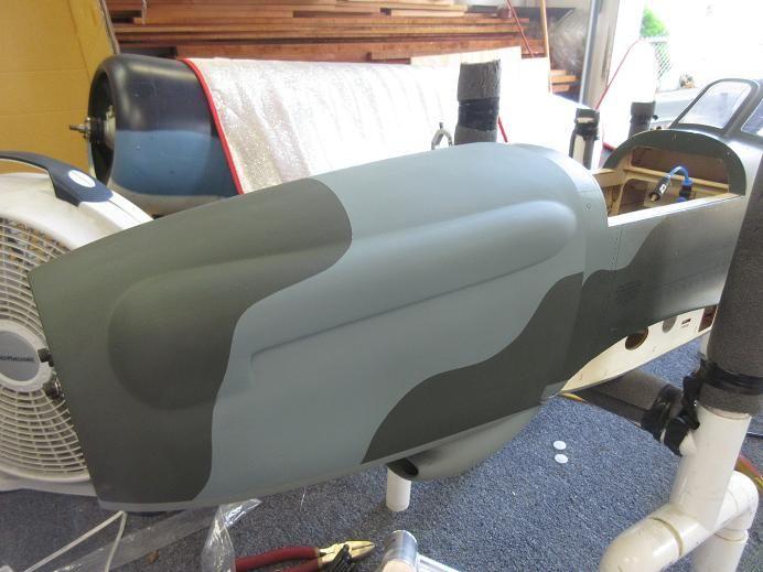

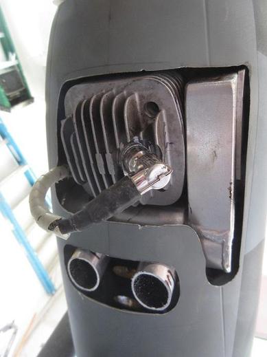

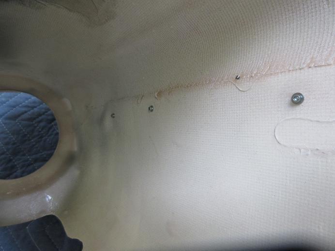

Engine area (cont)
Engine:
Instead of adding another fire wall, I used some DLE engine mounts plus half of the ARF's supplied mounts to get the proper distance for the spinner to align with the cowl.
Never used mounts that long in the past: hope the engine doesn't vibrate.
Cowl.
Took multiply mountings to get all the holes cut out for the engine head, side muffler and exhaust pipes.
Used a pop cycle stick for gaping the spinner to the cowl.
The exhaust pipes were cut to just extend past the cowl.
Also, cut a hole in the back of the cowl for air exit.
I'm figuring the holes should be enough as I've never had an engine over heat as long as the head is sticking out of the cowl.

Gear:
I cut the blue air lines 24" and 28" for the back and front nipples on the retracts.
They provide nice metric bolts and the blind nuts are already installed so one gets a good, secure mount of the retracts.
Time to assemble to check the retracts.
The remaining blue air line was cut in half so I had two long lines so the T festo fittings could be located by the wings.
I'm thinking this will be easier to connect the air lines versus trying to route them up through the fuse for each time at the field.
Both wheels were 'toe out'.
There are two small set screws for rotational adjustment.
There's a large bolt which, initially, I thought was for rotational adjustment but not true.
I had to add the gear doors to keep the door collars from rotating and inhibiting the retracts from going into the UP position.

Retract test:
I used an HS-645 to throw the supplied kit air valve. It is very stiffl and needs power plus the instructions says such. I used a metal clevis and a ball link for the linkage to the air valve. They supply a stiff wire and one of those easy connects where there is a set screw that holds a wire in a hole.
After filling up the tank with air, the retracts worked great but I noticed the robart air gauge going down to zero.
Initially, I thought I had a leak but, quickly realized, that with the supplied one way valve, this is going to happen.
I'll have to route the gauge on the other side of the one way valve.
Well, she's on her feet and she looks pretty good.
After putting the plane on the ground, now there's too much toe in. Must be some slop in the set screw for the oleos.

Cowl update:
While 'cleaning up' the work bench, I found a set of DLE standoffs. The standoffs were under a box. I now have any extra set as I thought I needed them for the engine mount.
Since the DLE standoffs were included plus the extra standoffs that are half lengths, plus the fact that the included mounting bolts just happen to be the right length to secure the engine and 1/2 length standoffs to the full length DLE standoffs, I'm guessing this is how the engine is to be mounted (even though the instruction book doesn't show it).
Fake exhausts:
I sanded away excess molding along the inside of the black exhaust pipes and cut some 3/32" thick ply and epoxied the ply into the back of the exhaust pipes. This will give me a mechanical as well as glue bond to the cowl.

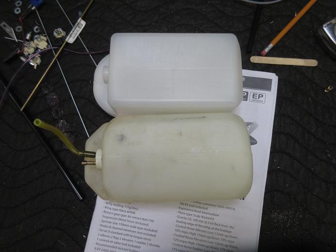

Fuel tank:
I'm sure the kit came with a fuel stopper but can't find it. The tank is a 'near' identical to dubro's 32 oz so a new one will be made.

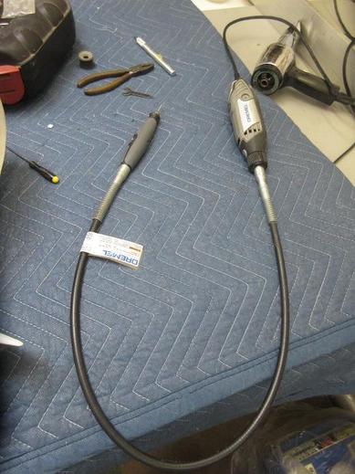

Cowl:
Had to use the flexible dremel extension to drill holes from the inside of the cowl.
Three hex head servo screws on each side should keep the exhaust stacks from falling off!

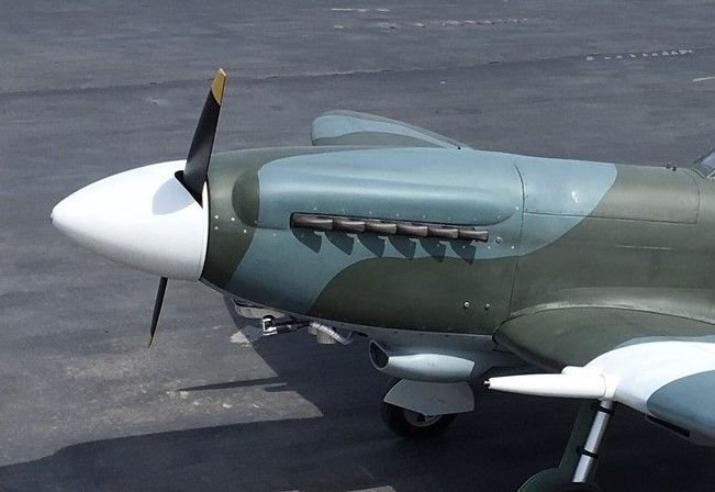

Good luck on your Maiden. Be aware that the carb is deep inside the cowl, which can cause some heat soak issues. I had to add some airflow to get air to it. On a hot day it's difficult to get air inside there. Your cutouts around the cylinder and muffler are tight, it may not provide much airflow to the carb. If it runs good with cowl off, but starts running poorly after a few minutes with it on you'll know it's heat soak. I don't have photos, but I added some holes right in front of the exhaust stacks and opened up the back of the scoop even more.
I noticed this plane flies nice, but when there is any turbulence it sure bounces around. In part because it's light, but the other issue is those large scoops. I pulled mine off and painted on some "virtual" scoops. It tracks better and is faster.

The standard stand offs should provide plenty of length. Your cowl should slide on farther, it actually overlaps the front of the hatch. For some reason you don't have yours slid on all the way.
I guess you'll have the "long nose" version.

That pictures is nice as it shows where the bottom of the cowl wraps around the LE of the wing.
It sure balanced nice with the engine way out 1 1/4" farther.
I haven't mounted the cowl yet so I maybe removing the extra standoffs. I need to see if the top hatch is removable with the cowl over it. Also, looking at the cowl mounting page, looking at their measurements, it appears the cowl is suppose to be farther out. It's late now, I'll re-check all that, tomorrow.
