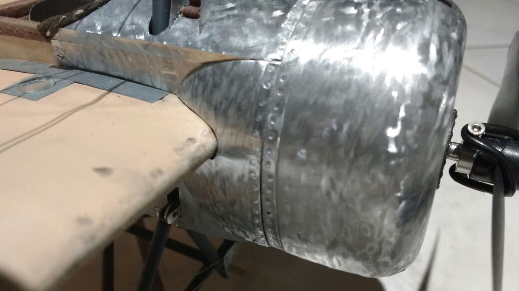

Some dremel work and magic happens!

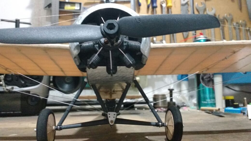

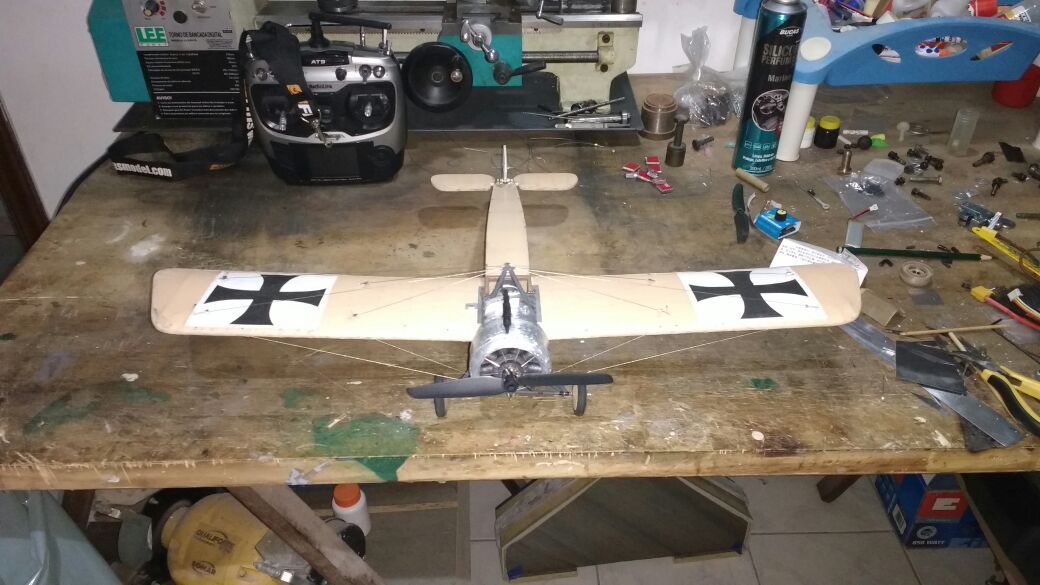

Got the tail completelly linked today...
Also, put everything together to check if everything is ok and what the CG is like currently....

Hello guys...
Had to stop working on the fokker 3 months ago to work on another model, now i'm getting back to the eindecker....
Today i made the side metal exhaust cover...
started with a square roofing alluminium and hammered it a lot with different kinds of hammers and dies to get the right compound shape...
Still need to sand it down to remover hammer marks and make the simulated jeweling effect, but all the metal parts are done now...
Only thing i still must fabricate is the machine gun... than just link the ailerons and it will be ready to go!

Alright guys.. ready for maiden here!
Finished everything... it ended up weighing 205 grams ready to fly!
40 grams of those 205 grams are dead weight i had to add to the nose to get CG close to where i wanted it to be (1/3 of mac) but even with those amount of dead weight i couldn't set cg at 1/3.. its somewhere behind those 1/3.. probably it will be tail heavy, but theres nothing else i can do!
Tested the motor and for my surprise i'm getting only 90 grams of thrust with a 6x3 prop... so power to weight ratio is ver critical...
With all those negative factors i'm not sure it will fly... probably it won't even survive first flight, so, at least i took lots of pictures so that i can remain on my memories hehehe...
