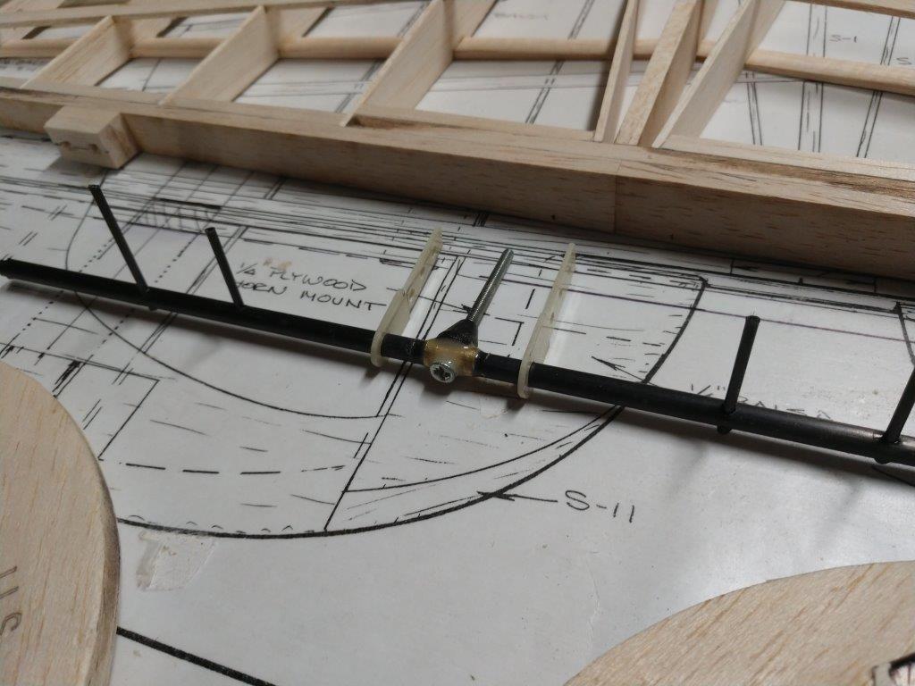

My Models
Ratings
My Feedback
Also followed Ziroli's recommendation of the making the elevator coupler out of 1/4" music wire. Fabricated a servo arm and silver soldered it to the wire. The brass tubing was installed as a hinge for the wire to rotate in. All this was looking good and worked great until I tested the servo arm with some force. The silver solder failed (and yes, I know how to correctly silver solder). I used a lot of force in the tests - probably more than the elevators would ever endure, but I just didn't have a good feeling about the soldered joint.
tgking44 is offline
Reply With Quote
Old 07-02-2018, 08:07 PM
  #33
tgking44
Join Date: Sep 2004
Location: Charlotte, NC
Posts: 107
Gallery
My Gallery
Models
My Models
Ratings
My Feedback
So... I fabricated a new elevator coupler. This one is made out of carbon fiber tubes and a Nelson Hobbies control horn. Very similar to what CARF Models uses in their P-47. It passed all of my exaggerated tests and is 1/3 the weight of the 1/4" wire. It may look silly and overkill, but my gut tells me it'll work (hope I'm right).

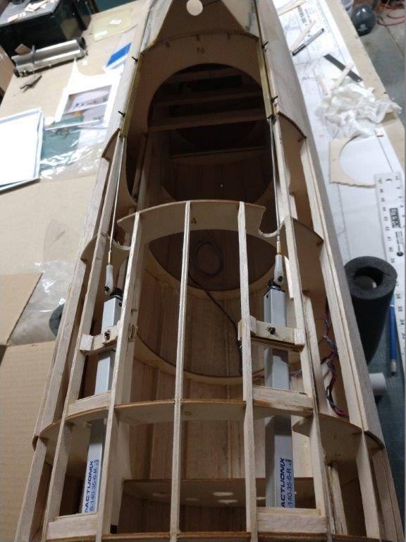

Installed 2 linear servos for the sliding canopy. With 6" of travel, they're ideal for this application. Required some tinkering to get the geometry right, but I'm happy with how it turned out. It works great.

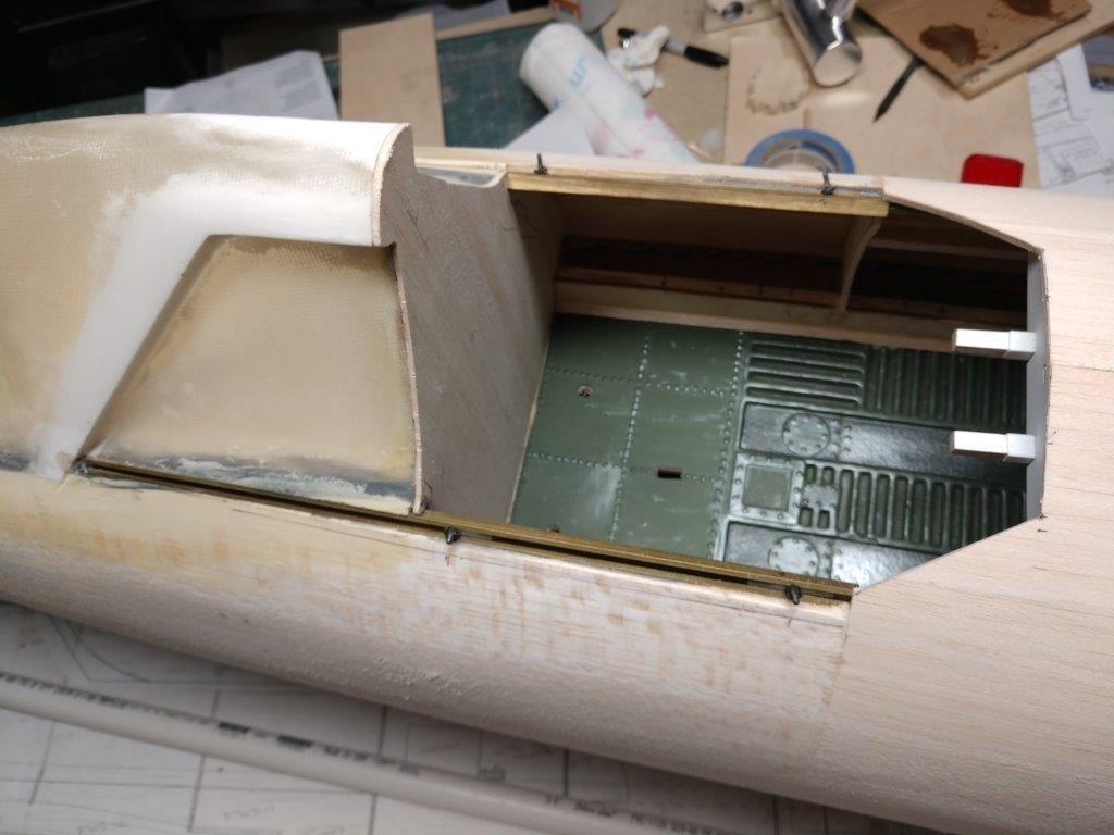

A few pics to update. Slow, but steady progress. Closed up most of the fuse, but had to install the cockpit floor first. The rest of the cockpit walls and details will be added later... just the floor had to be installed before I closed up around it. Also made further progress on the removable firewall. The concept is to have a "system" that includes the engine box, firewall, tank and all electronics in one self contained, removable piece.
