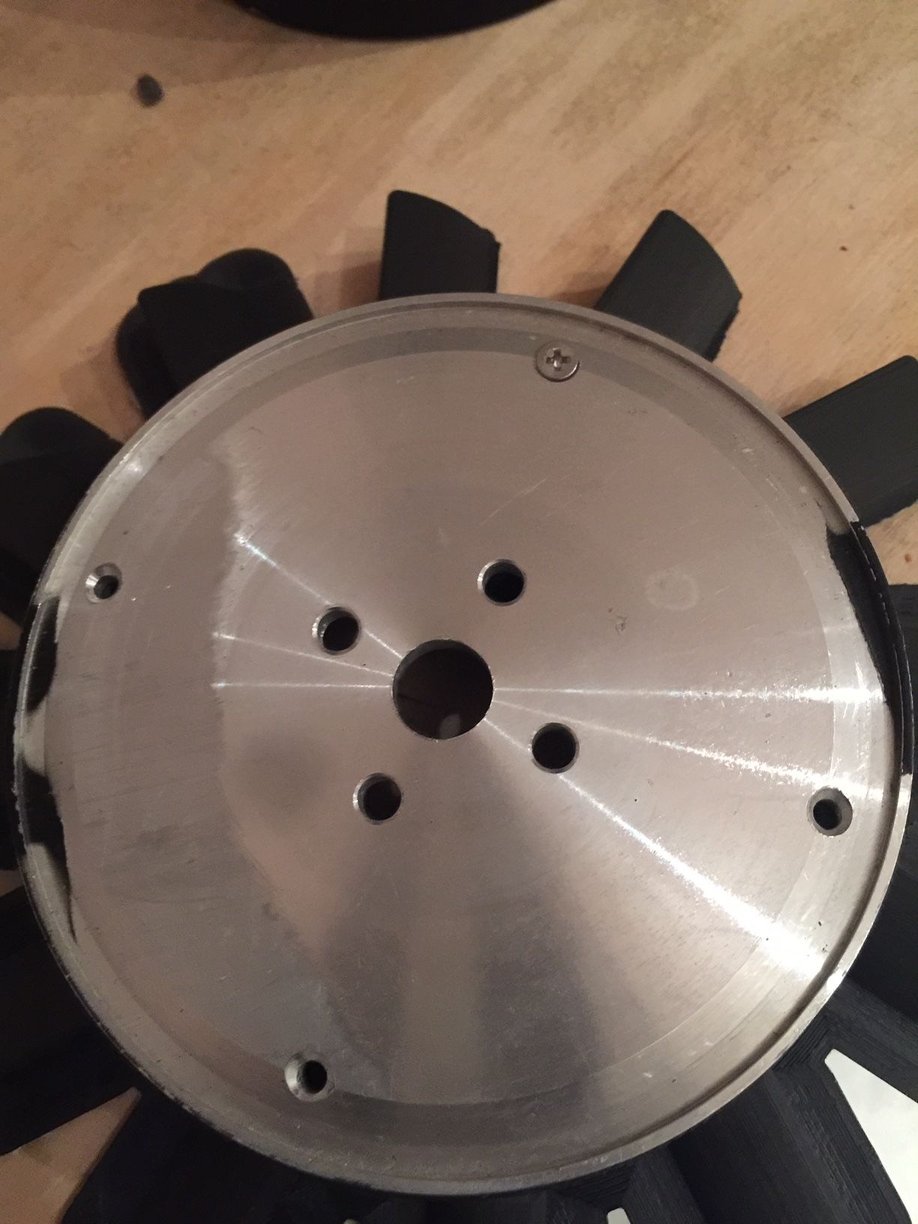

Hi,
I am not a company, I just drew them up for the topflite and toprc fw's because I needed them myself. I print them in a special heat resistant material that does not warp like ABS and is a lot more heat resistant (95C) than PLA. Problem is the material called Greentec BDP is quite expensive so the fans cost 40.- a piece plus shipping. I can ship worldwide for 10.-.
They bolt directly to the back of the original spinner (both topflite and toprrc) and the toprrc Fan has 175mm diameter leaving around 3mm clearance to the cowl opening.

Hi guys,
your fans should be arriving soon. I sent them straight off the buildplate so theres a bit of cleanup to do before bolting it to the backplate.
Remove the flash around the outer edges of the fan. Its only 0.4mm thick so its easy to remove. Carefully sand the edges with 300grit sandpaper after removing the flash
Please remove the support grid on the underside of the fan. You can do this by hand. DO NOT damage or remove the bridges! It should look like the picture above after you removed it.
Press the spinner backplate into the fan (its a deliberate tight fit) and use the fan as a template to drill four holes
Using countersunk screws, fasten the fan to the backplate. Make sure you use washers and locknuts on the back!
If anyone is having any issues, drop me a PM!
Rev
