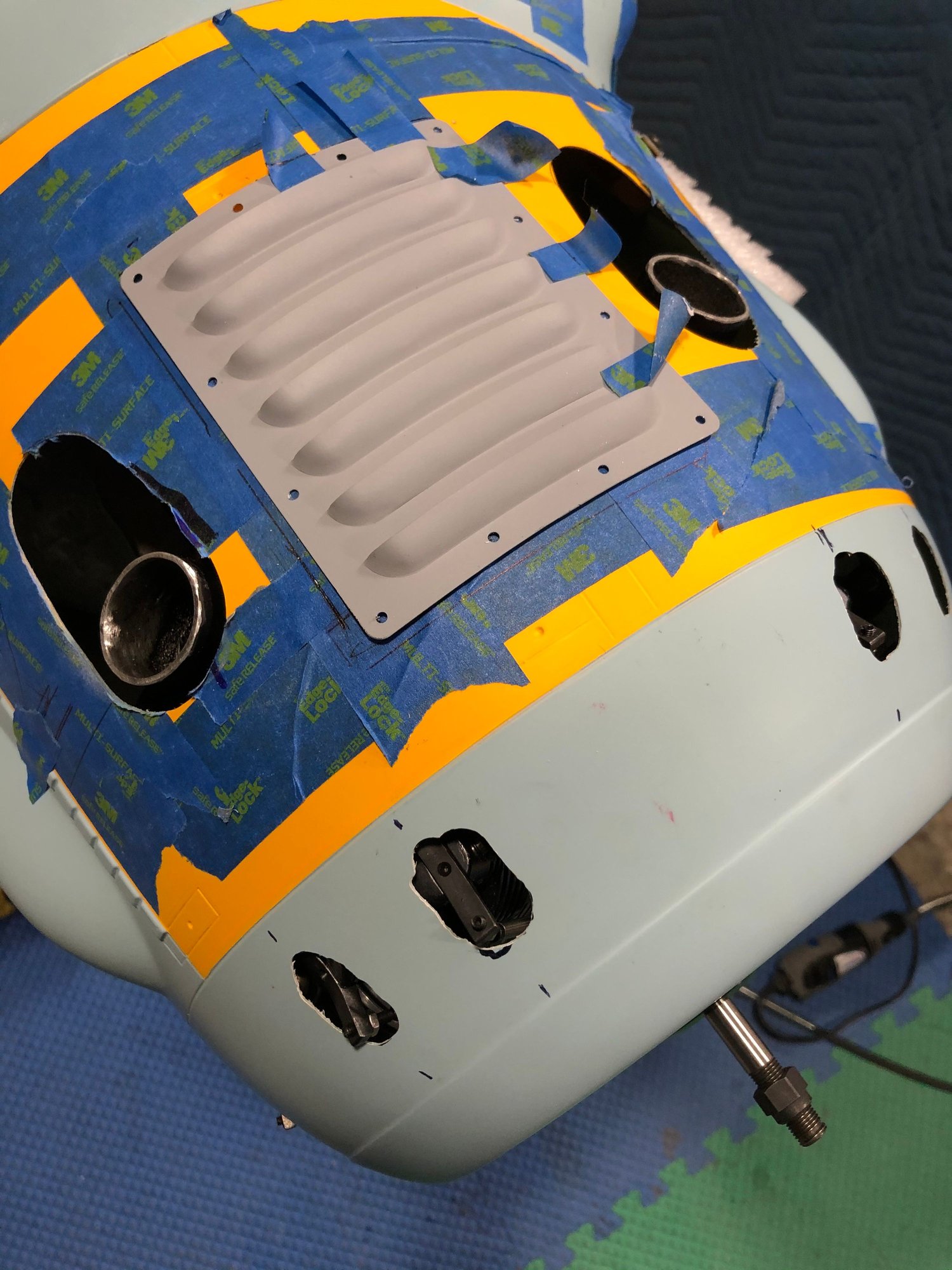

Decided to add two smaller vents on top of cowl

From what I understand the vents like the ones you use are not very effective since the space is so small between the slats lots of interference drag as the air tries to figure the way out.

Actually the vents are very affective....the openings are very large and the slats are angled as to create a negative pressure which reduces drag on the front side and easy air flow on the exit side, very affective

That should be close to a 3:1 ratio of venting
