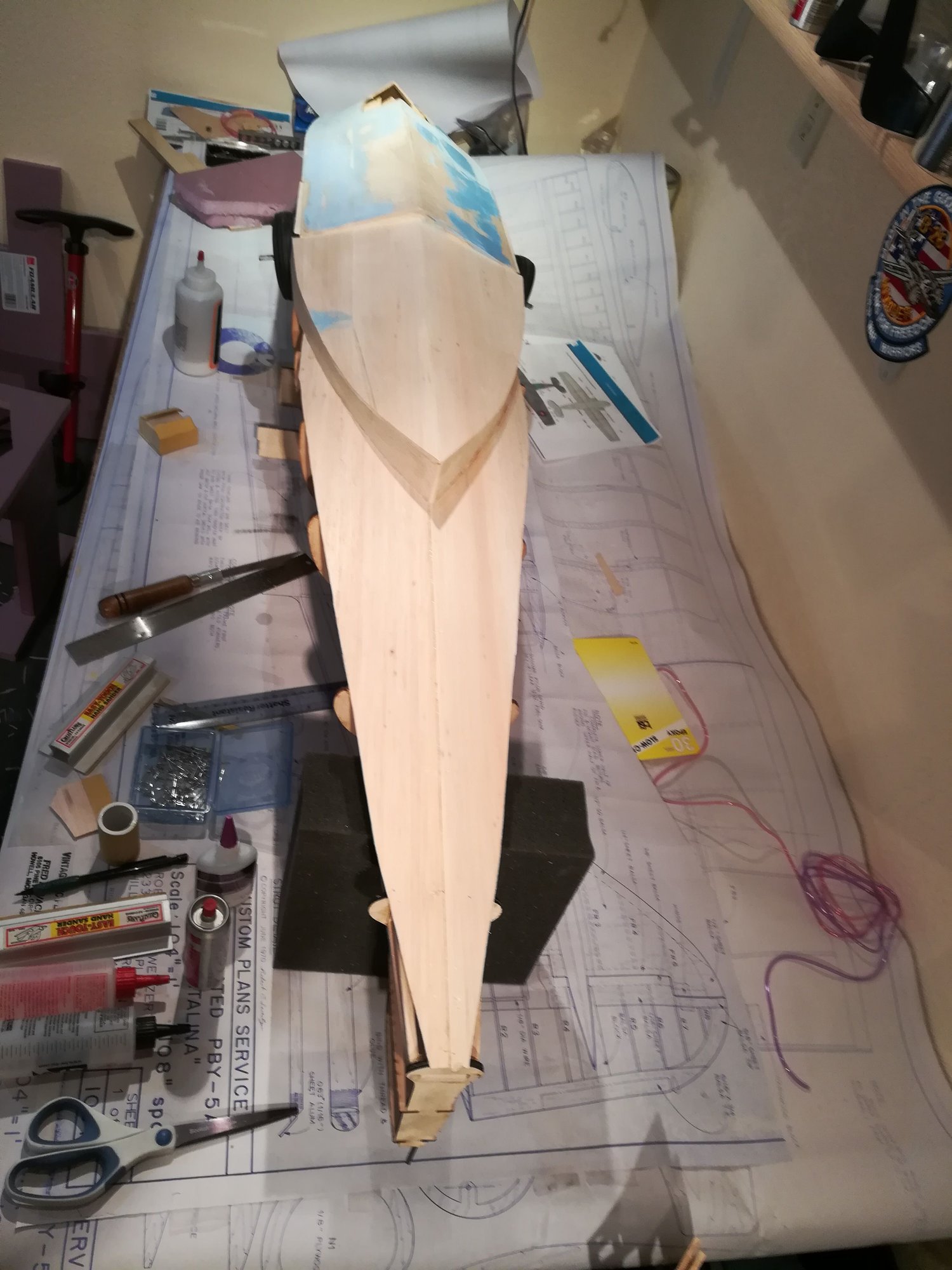

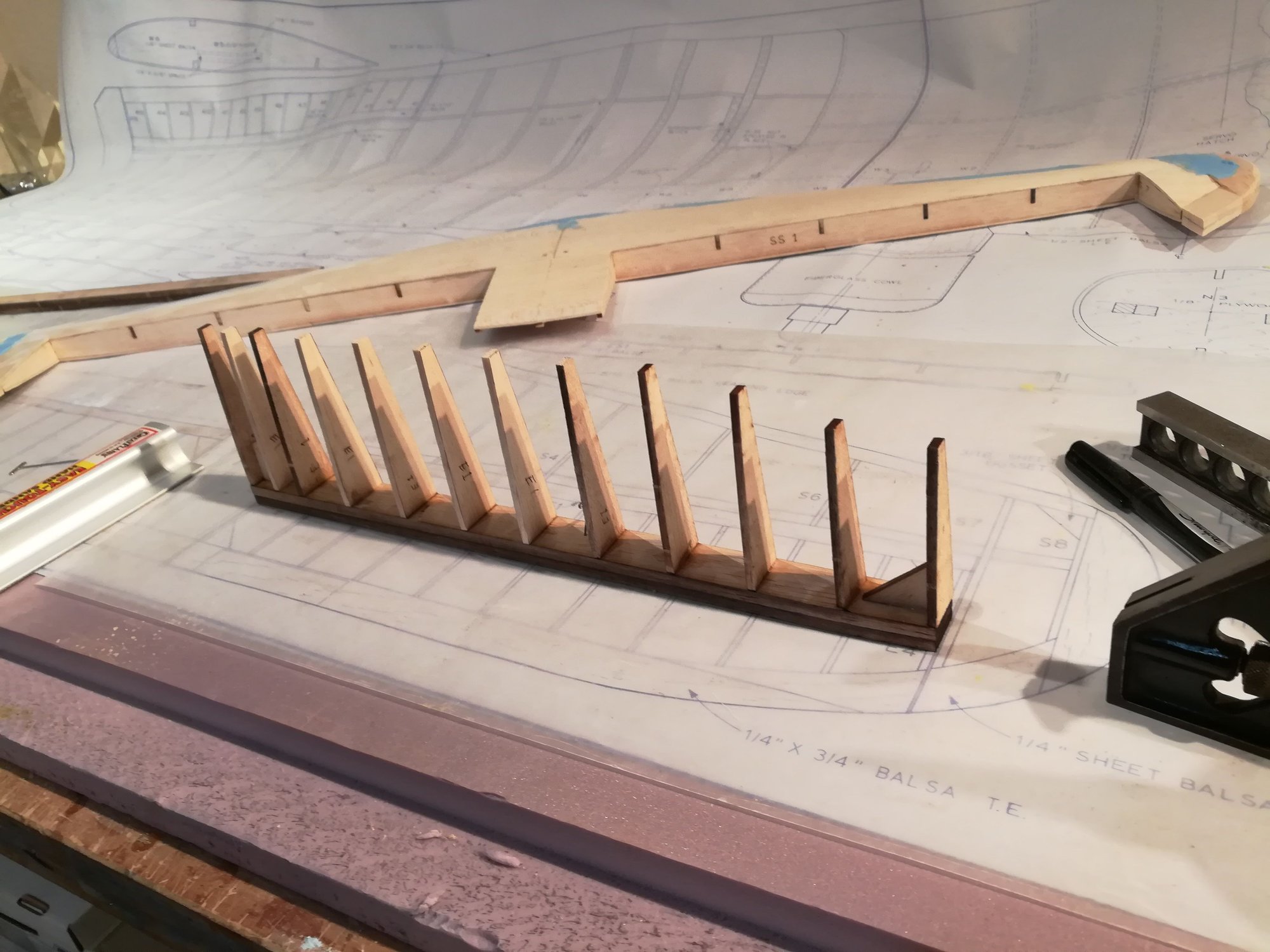

Finished sheeting the bottom of the fuse (the hull that rides in the water and the tail boom. To sheet the bottom of the tail boom, I first made a template out of cardboard. The rest of the fuse is much too curved in its shape to be sheeted, so will have to plank it. I hate planking

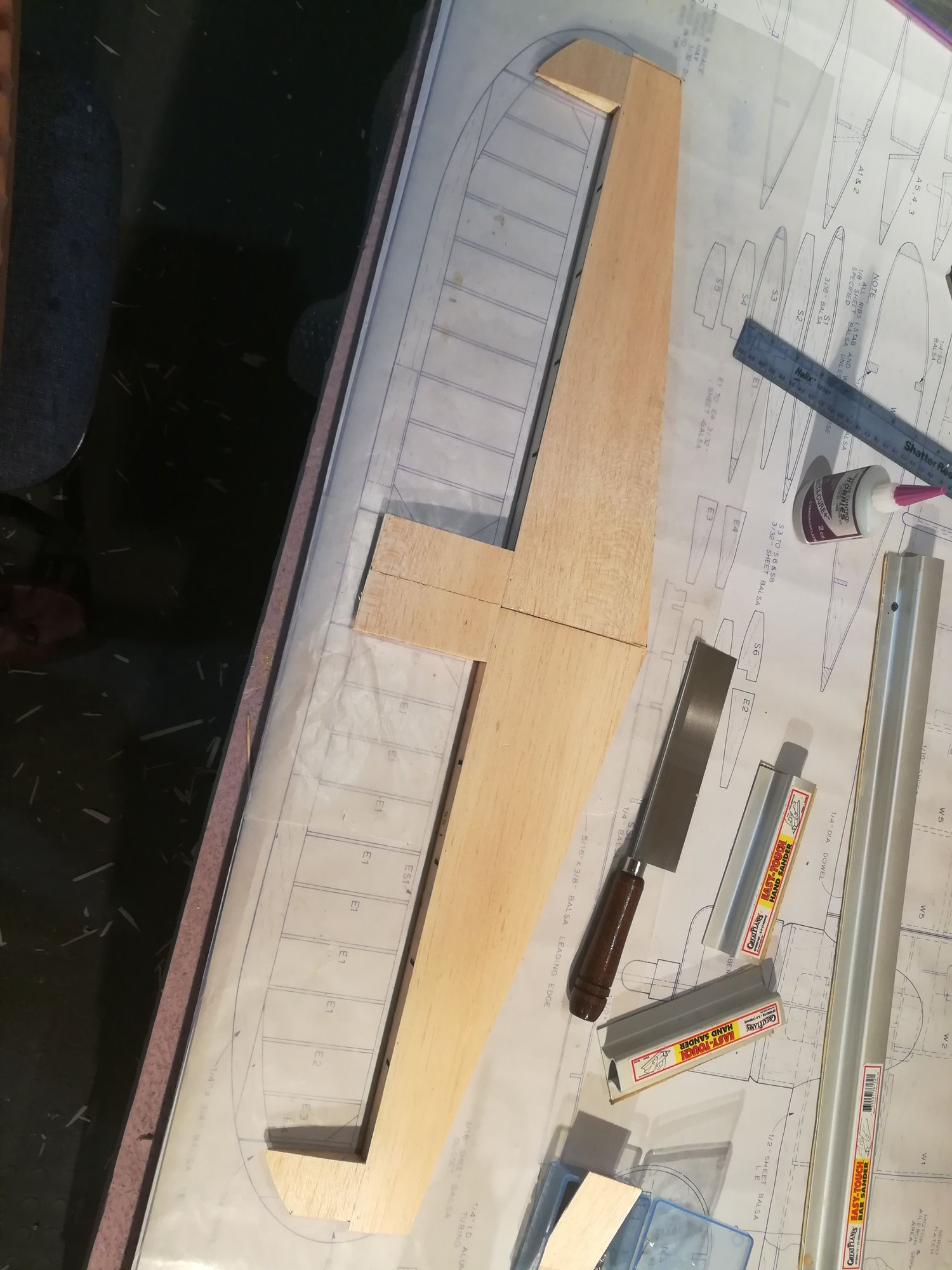

Meanwhile, the horizontal stab has been coming together too.

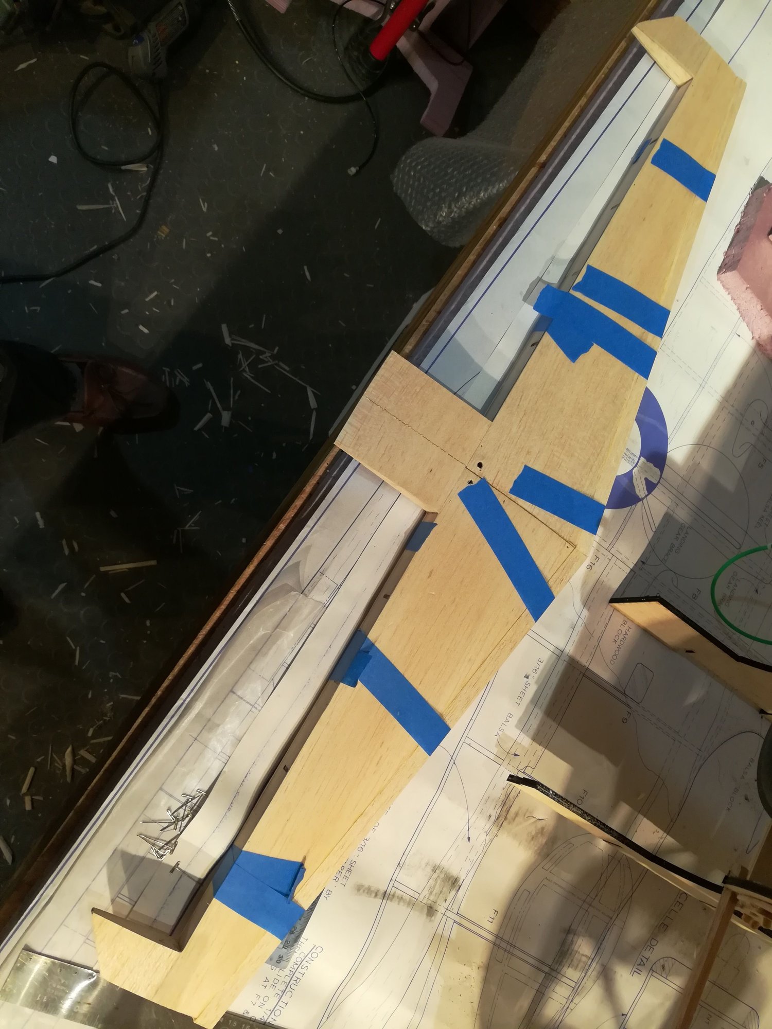

Finished the balsa blocks around the stab. Did some fill and sanding. Built the elevators and started sanding to shape. Right elevator is hinged and you can see the hinge mounting blocks in both elevators.

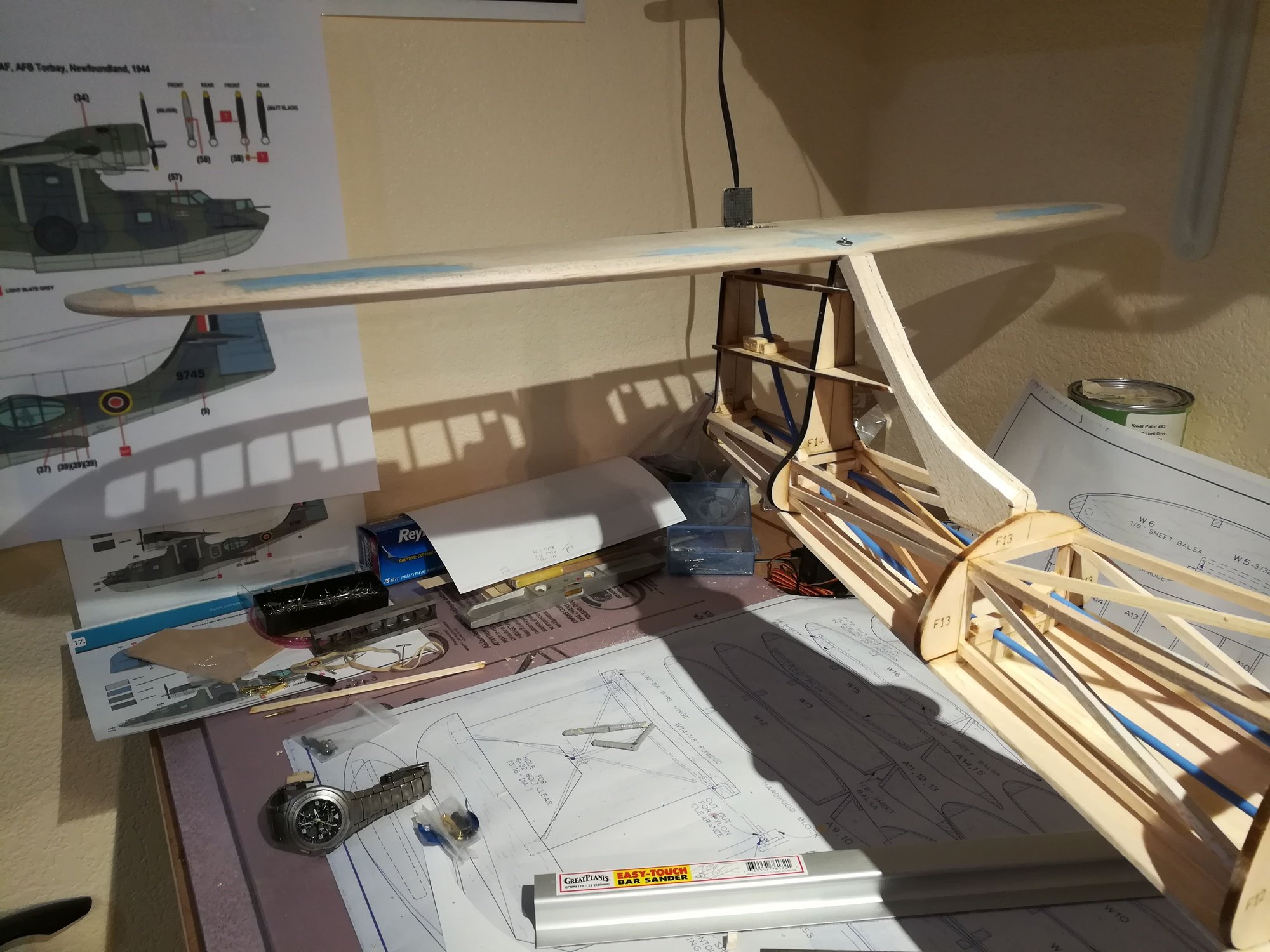

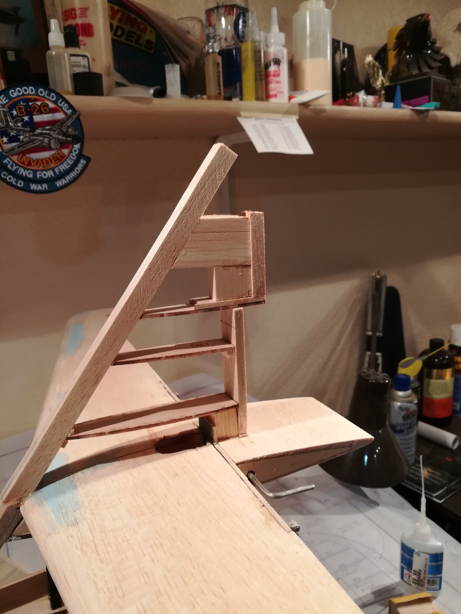

The PBY presents an interesting opportunity for elevator control. The elevator pivot line is in the rudder (not vert stabilizer). This limits how to control it. The plans offer no suggestion for operating the elevator. If you put the hinge line against the horizontal stab this would be easier. But I want scale movement of all the control surfaces.To accomplish this, the only way is to have the elevator control routed into the horizontal stab. Unfortunately this will have to go through the h-stab spar, which will have to be cut in half!
To support the elevator control, the spar will need to be modified with an opening 1/4" wide running top to bottom of the spar. Obviously this will destroy the spar's primary function. The only space to reinforce the spar is inside the v-stab. A plate of ply and carbon fiber in will be used to carry loads around the opening. The spar will be cut to allow the plate to be recessed into the spar and to fit in the original space. Here's a couple of picts. The CF is facing forward in the second picture.

Ran the pushrods for the elevator and rudder. Mounted the H-stab with screws for now.

The rudder has a 3 step pattern to it, where it mates to the V-stab. It also has a cutout for the H-stab as the rudder wraps around the H-stab. Adding to this complexity, I discovered that the plans are slightly, but materially, smaller than the cut parts. As the rudder must fit like a puzzle piece with the V-stab, I opted to build in free hand, section by section to get it to mate properly. I'm showing it over the plans just so you can see what I am building.

Looking at how the rudder fits, I can't see how it will be able to move left and right.
am I missing something or is there trimming that needs to be done on the rudder?

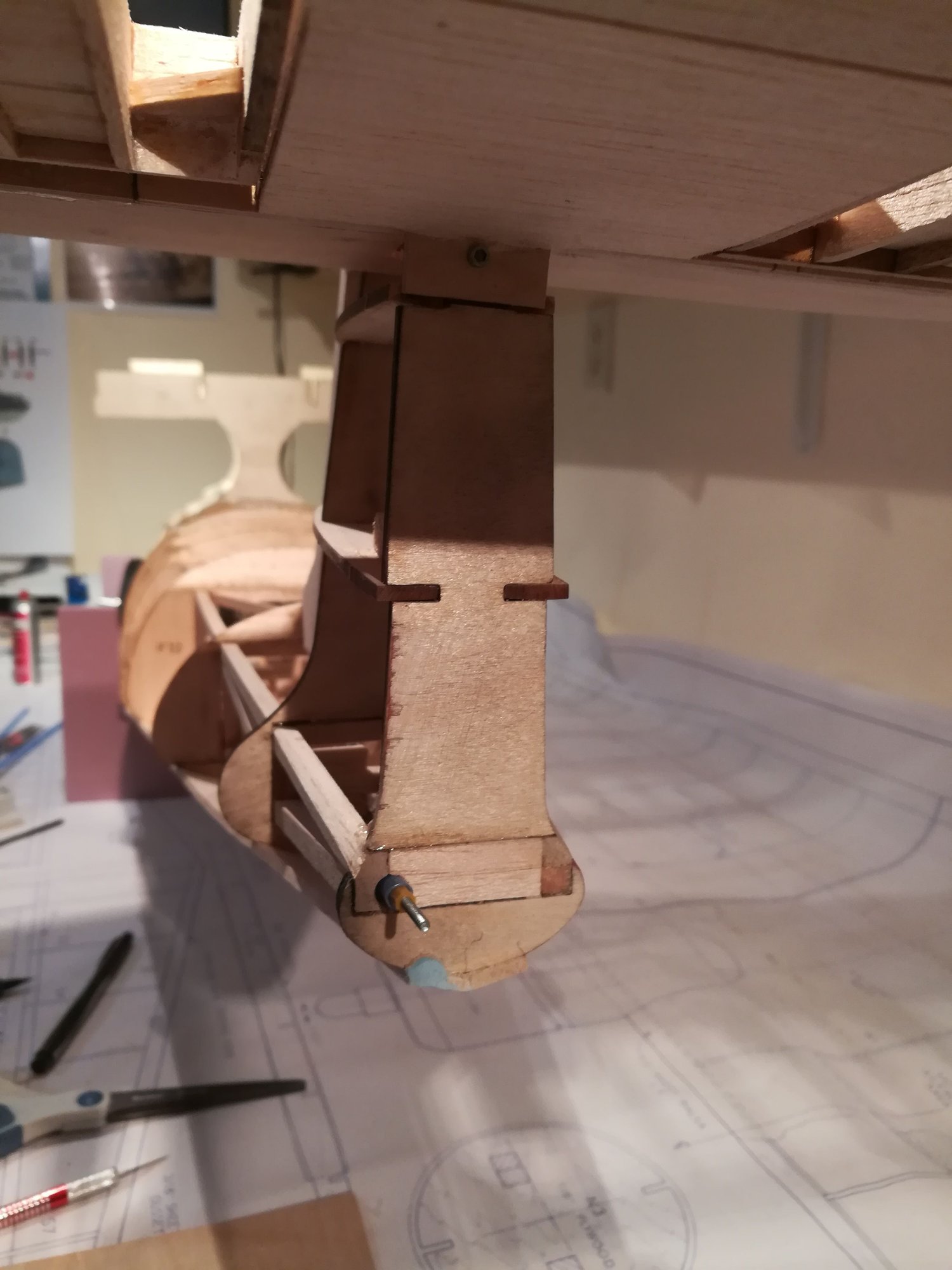

As for stiffening the opening left by F7. There are now 1/4" ply rails running lengthwise in the opening at the top and bottom of the fuse between F5 and F8. At the top are 2 rails 1" wide each at the bottom are 2 rails 2" wide each. There are then 1.5" wide x 1/4" thick ply rails across the fuse tying the left and right 2" wide rails together forming a box that the landing gear is mounted to and providing stiffening for the lower part of the fuse. Also, F7 still exists below the bottom 2" wide rails. This means that for the bottom 1/4 of the fuse the only thing that has been removed between F5 and F8 are the 1/4" sq balsa rails. For the upper area of F7, there are the 1" wide x 1/4" thick rails that you can see. I have since installed diagonal braces into the pylon and installed the part of F7 that is above the gear. See the next post where I talk about this.

A friend of mine Bill is a kit designer (he makes some nice fiberglass kits, see SCALE RC AIRPLANES) and was reviewing my alterations. He pointed out that the ply rail at the top end of the gear support could fail in a hard landing. Looking at it i agree.
So, I have added diagonal bracing above the 1/4" ply and installed the section of F7 that fit above the gear (in the pylon). Net result is that the landing loads can be transmitted to the pylon and wing. Also, this will significantly stiffen the upper area between F5 and F8.
You are correct, more trimming. Here's a photo of the trimming complete to allow the rudder full movement.
An issue with this rudder is that it is hinged only at the top and bottom. Flight and torsion loads are transmitted through the trailing edge (yuck). To deal with this, I have added carbon fiber cloth to both sides of the rudder TE. It's quite strong now!
