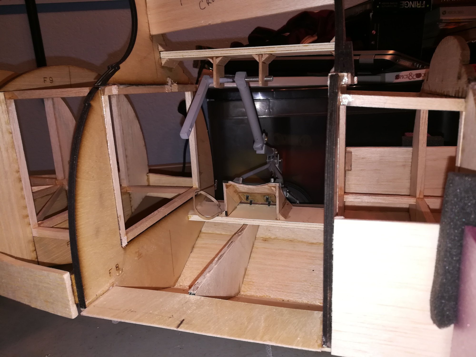

The Vintage plan was drawn in 1970 and planned on fixed gear. No provision for retracts. To put them in, most of F7 will need to be removed. Unfortunately F7 also carries much of the load between the wing and fuse. F5 and F8 will need to be updated to accomplish the same goal, but latter. Let's get the gear in first.

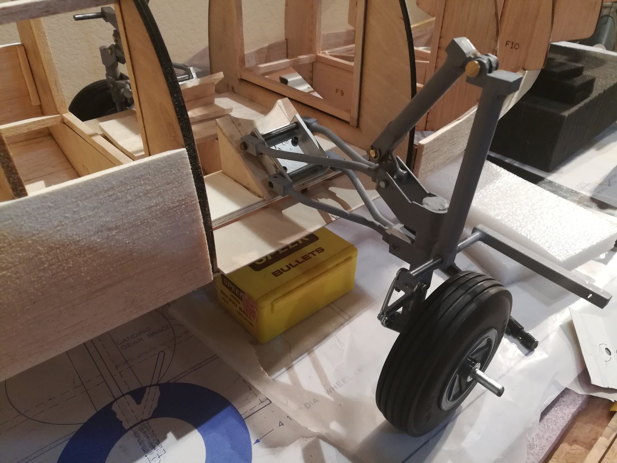

Here's the retract just mocked up as I design the necessary mounts. Finding retracts was a challenge with Century Jet out of business. I got a set from G&P Sales.

Partially complete permanent mount.

Continued work on the main landing gear. Views showing the underside of the mount.

Mounting the load bearing arm. Also retracts the gear.

Complete the other side and check that it all works!

If you look at the load bearing strut, you can see it is driven by a torque rod with a long arm. That torque rod and ply mounts take all the landing loads and the asymmetric loads of raising and lowering the gear. Me thinks the holes in the ply will wear in an oblong shape rather sooner than later. Here's a close-up view of the mount.

To prevent the wearing and make the gear easier to move I am doubling the width of the ply mounts and adding stainless steel bearings at each end. The end closest to the lever arm has a needle bearing and the other end has a ball bearing.

For anyone who wants to use the same gear and setup you will need to modify the lever arm/torque rod. The instructions that came with the gear indicate that they were to be set up to _not_ fully retract. Doing so would result in the locking arm on the gear moving into an over center position and locking in a position that the air cylinder would be unable to move. This fuse is slightly larger, so I am able to have the gear travel through it's full range of motion. The instructions also say that you will need to full stroke of the air cylinder to get 90% of the movement. This leads to a problem for me as I need 100% movement of the gear. So you need to shorten the lever arm length.

After a couple hours of figuring out alignment and positioning to get full motion of the gear I have them both working well.
