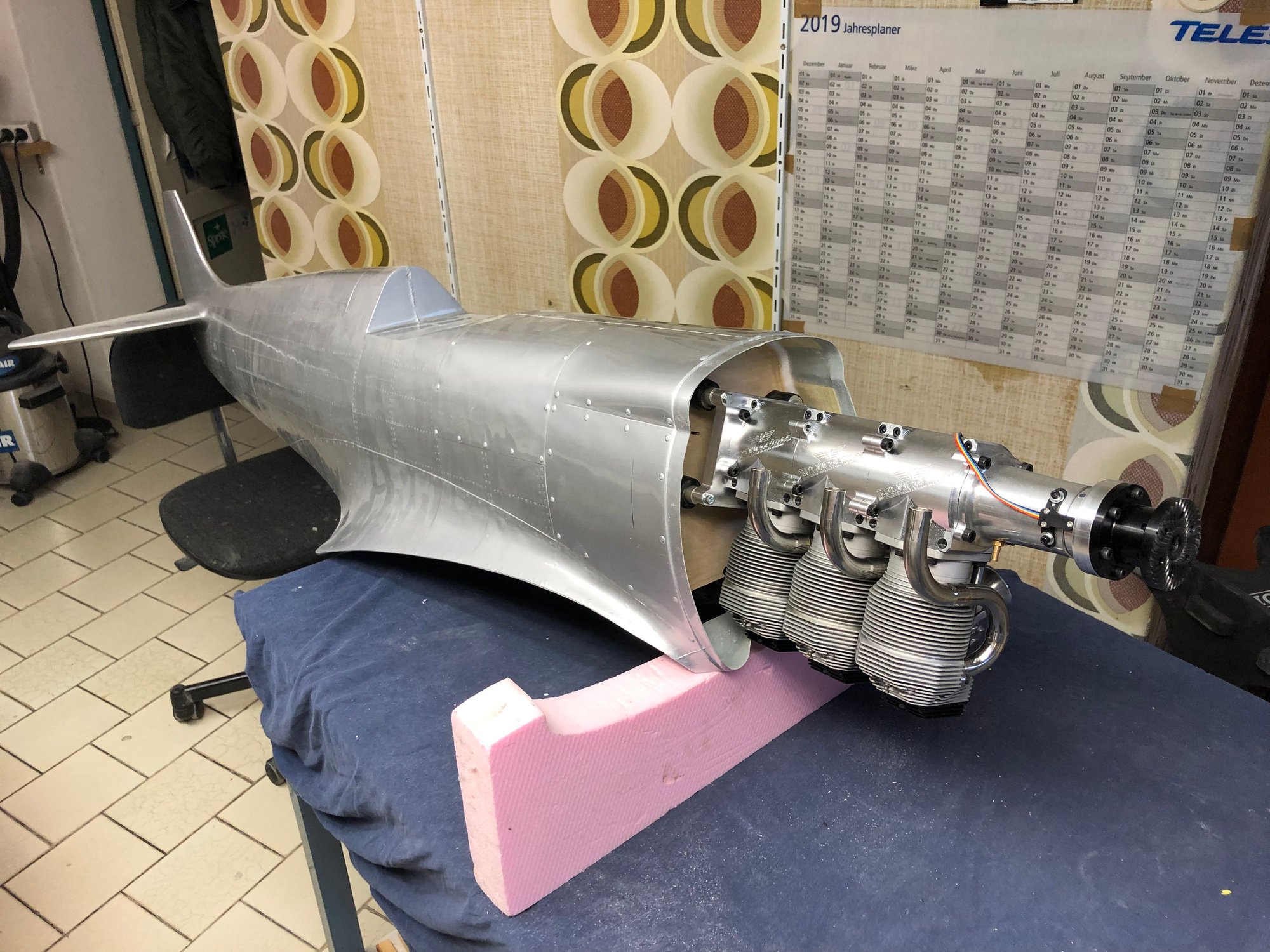

Looks great Tom. The install kit seems to make the job very easy. I will be interested to see how you deal with the cooling on this one.

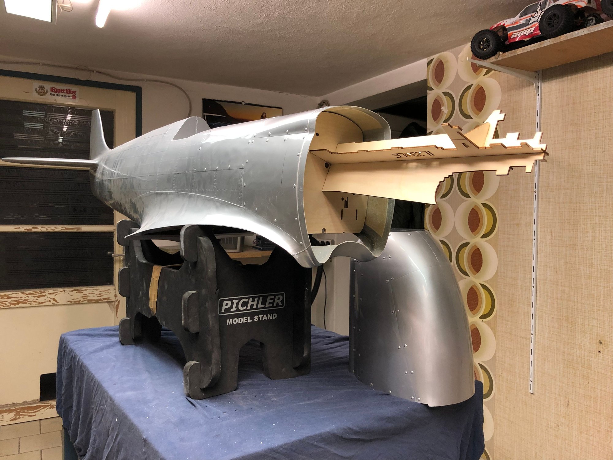

Hi Tom,
Cool build! I see the new pipe for the IL230 engine. Is that pipe compatible with the IL150 also? Thats the first time Ive seen a pipe for these engines.

this is the silencer from the Galloping ghost/Strega. We make it fit for the spitfire.
Also the plan is to offer the same silencer for the IL150 and Il155.

Glad to see the exhaust diverted to the side opposite the carbs

Hope they sound good !
We will have bigger exit pipes to get more sound from the engine. Also we will have a functional exhaust system optional.

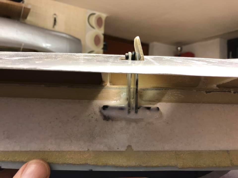

How i did the Flap linkage:

How i did the flaps :

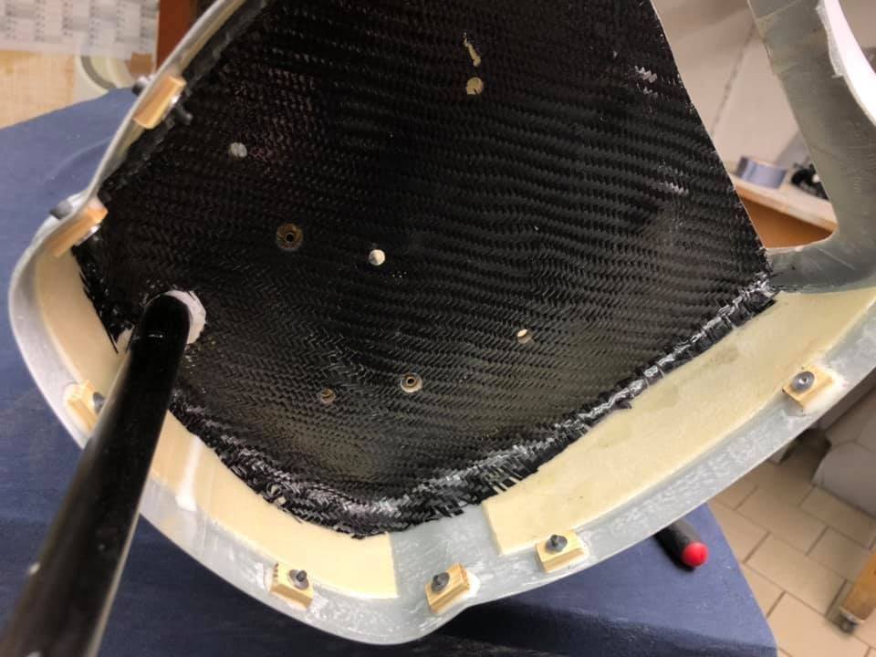

Support for the cowling ( will be cut in 2 parts because of the baffels), a layer of glass for the nose edge of the wing, and the fuel/smoke tanks with carbon holder

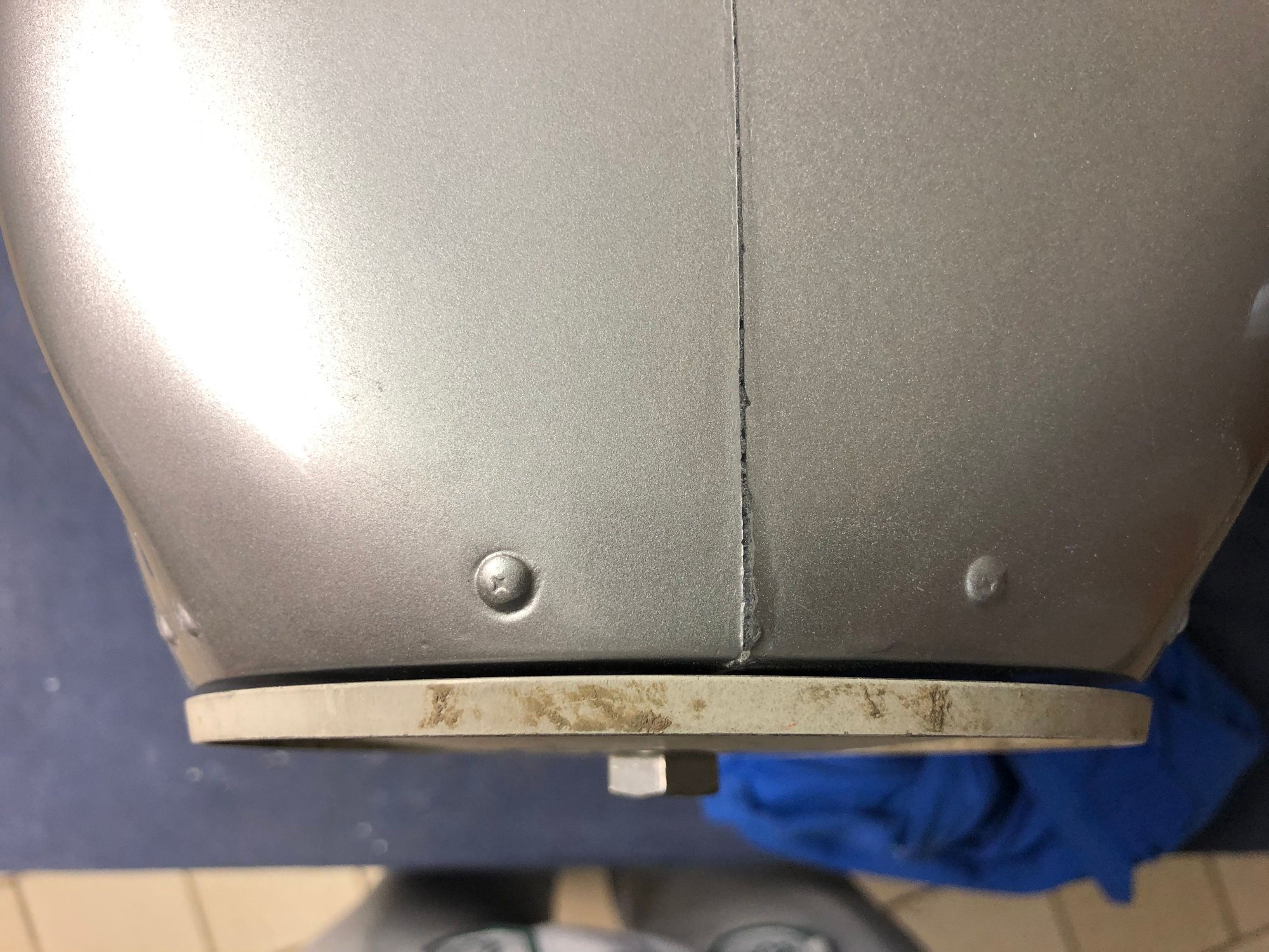

Cutted the cowling and the silencer took place. Now I have to find out where to make the exit pipes in future
