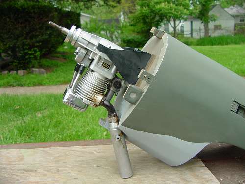

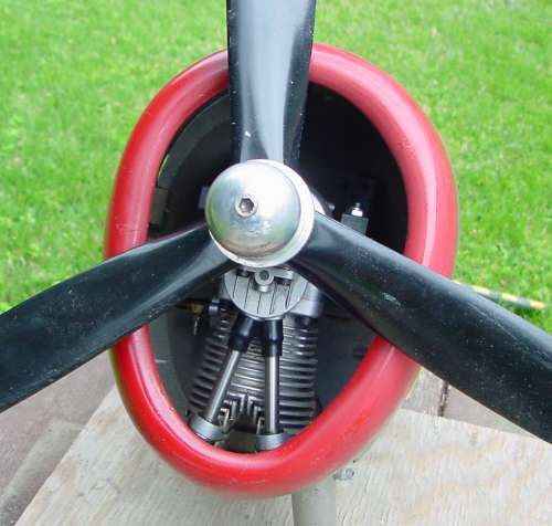

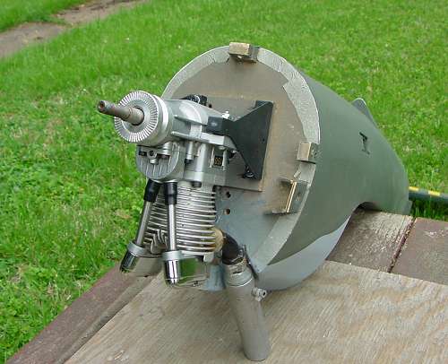

Here are some pics of mine with a Saito 150 installed. It is still in the restoration stages so no flight report on the 150's performance yet.
Prop is a Graupner 15x8 three blade. I am a bit worried about the stock muffler ripping the head off if I do a wheels up landing.

Paul It s looking great, keep them photos comin'. The 150 looks Just right on the fire wall photo. I did the same paint on my three blade!
Scott B.
