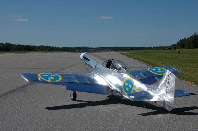

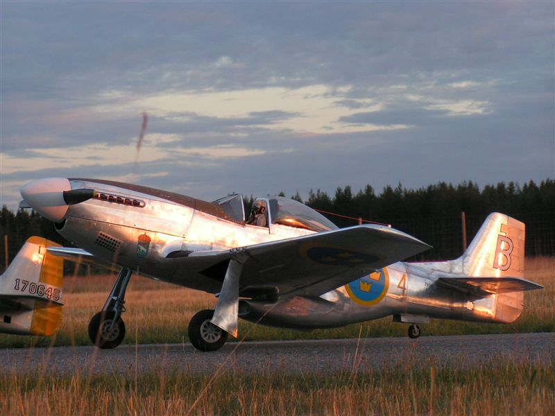

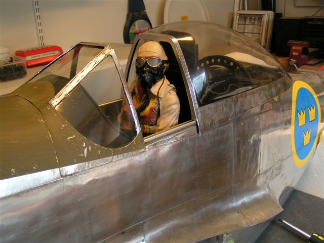

I think it's worth the price. I started building first week of januari 04 with 300 hours put into it.
Started up engine today worked great. Waiting for good wether this weekend for first flight.
Tobbe

Tobbe,
VERY nice!!! What did you cover it in?? Can you still see the panel lines and rivets etc through whatever it is?
Also, did you buy the Comp-ARF kit or an older FiberClassics kit?
Finally, which retracts did you use??
Mark

It's covered with Flair Aluclad and yes you can see everyting, rivets panellines. The great thing is that there are not a singel panel that's not dented just like the real thing. I bought the Composite-arf. I've got it to my frontdoor in a week. It's made for germanmade retracts but I rebuilt it for Robart 85 offset retracts.
Tobbe

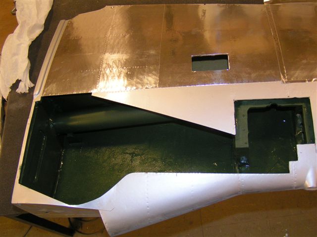

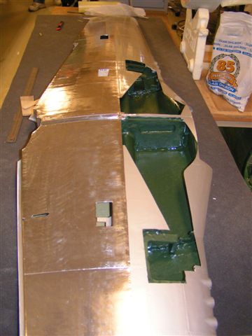

I am just starting to build one also, and have already found out that the wing ribs are not in the same location from panel to panel. I'm installing Sierra retracts and wheels.
it is not a drop in fit either. You definiatly have to engineer a lot of things. I am installing a 3W 75cc engine in this one. It's a shame that such a nice set of molds would up in the hands of people who don't care enough to provide a good set of instructions and hardware to go along with it. Also they were supposed to come out with drop tanks, sliding canopy, cockpit kit etc. they now say it's not going to happen. You are on your own.
Maaybe they will read this thread and make the nessary changes to make this the world class kit .

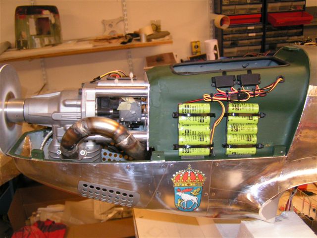

Tobbee,
What are you doing?
Mounting the batteries inside the hottest(killer of all things electrical) part of the airplane?
Not to mention on the fire wall with out even so much as vibration insulation.
Another thing.. When you secure batteries? Secure the packs across the lengh of the pack, not width. You're placing Stress points on the battery conectors.
You've been warned.
-Mustang51
What are you doing?
You've been warned.
-Mustang51

Thanks for the tip, the batteries do have vibrationmaterial behind them and they are not going to be in warm airflow. I will change the straps,
Thanks again
Tobbe
Thanks again
Tobbe

Also, did you take any pictures of the work required to refit the Robart 85 retracts in place of the German made retracts??

Was it that hard to modify the wing for the Robart retracts or quite easy??

It's made of Paul Haller switzerland, he sells it thru [link]http://www.igmustang.ch[/link]. I payd about
130 Euro delivered(good price). The only obstacle with the Robartretracts is that I learned that they are a bit of sloppy when they put in the formers at the factory, so they are not put in at equal distance. I discovered that after doing one half. It's not a big problem. I saw that you asked about reductiondrives. If you go to[link]http://www.igwarbird-germany.de[/link] and search the gallerys you gonna find alot of pics for Ralf Borcher
drives he also makes the fourblade prop. I haven't been in any contact with this guy because of my very bad german. He's got a mail but not a site. I think that the fourbladeprop shown on warbirdpropdrive actually is a Borcherprop.
