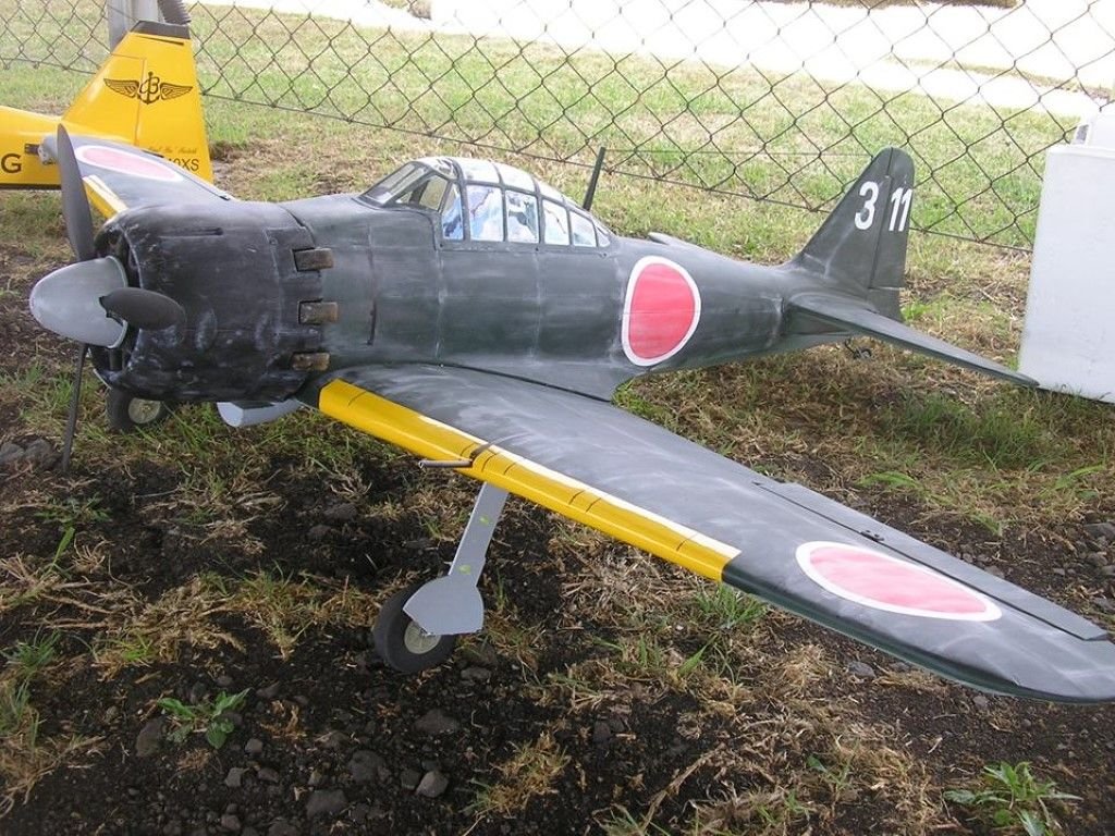

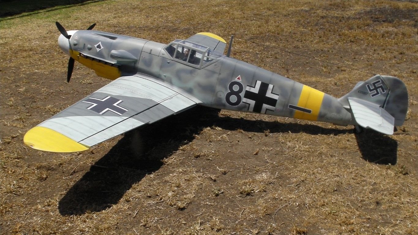

Here are some planes I have painted in the last couple years, just house paint and thinned with tap water, not sure why you need to add a paint leveler, it has to be sprayed thin with a least 3 or 4 coat's to get color depth, I use a cheap gravity feed finishing gun for the large area's and an air brush for the small stuff
