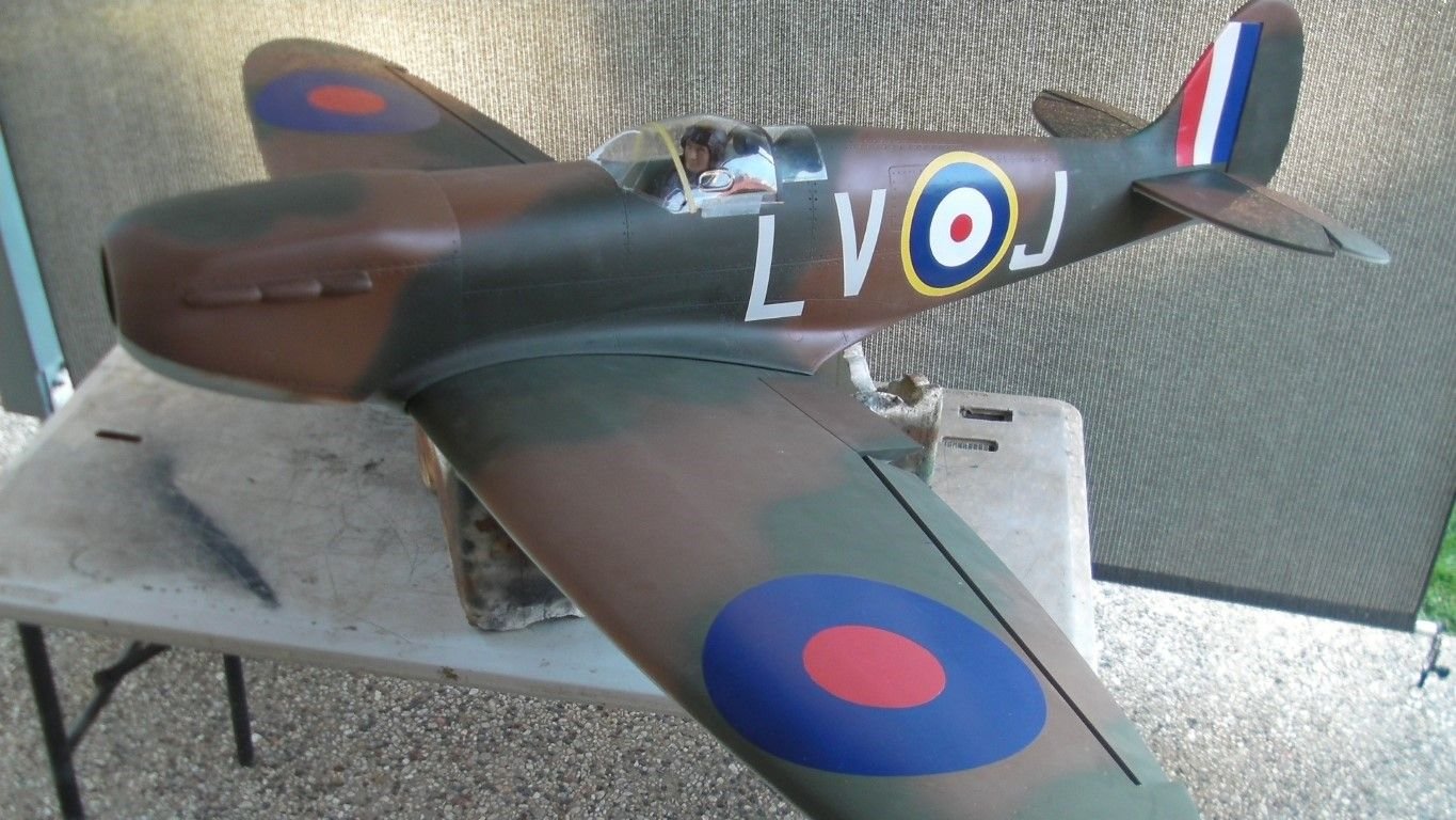

Found a NIB CMP 120 Spitfire a couple of months back and I am just making a start on it, I want to make it look more scale'ish looking so there is some bashing to be done, the cowl, cockpit, a new canopy, fin and rudder, ailerons and split flaps all to be modded, so far I have got work done on the cowling, cockpit and and trimmed the new canopy to suit

I got the tail finished and new rudder made, extended it 2'', looks a lot more scale know, just got to add paint to the cowl cockpit area and cover the rudder to make it look pretty again
Mike
Used foam and thin glass for the 2''extension
New rudder made to suit

The making good is all done and undercoated, now just needs finishing paint

A bit more progress with the spitfire, canopy to paint and then I will start installing servo's and push rods

Motor mount/battery box is now made up and installed also the motor and ESC --getting there

I have got the Spitfire ready for it's maiden, Sunday is looking a good day, after a few flights I will give it more detail, panel lines and weathering, I have fitted larger wheels for grass so I am making new FG wheel cover to suit
Mike

Got the Spitfire maiden'ed and 7 other flight's, it flies very well could not be more happy with it, only change after the maiden and for the next 3 flights was to move the C of G more forward as the plane flew tail heavy, I had to put 3 oz of lead on the tail to get the C of G at 120 the forward mark, I ended up removing 2-1/2 oz and the C of G changed to108mm, Il get a couple of more flight days in and then it will go back to the hanger to get larger spit flaps added more detailing and weathering
