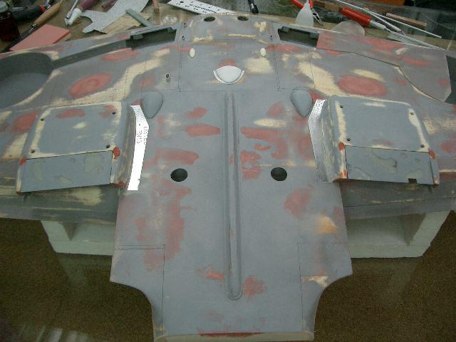

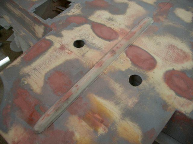

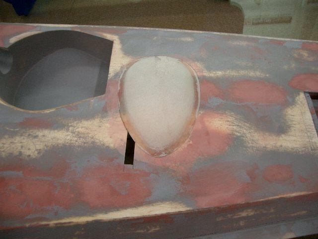

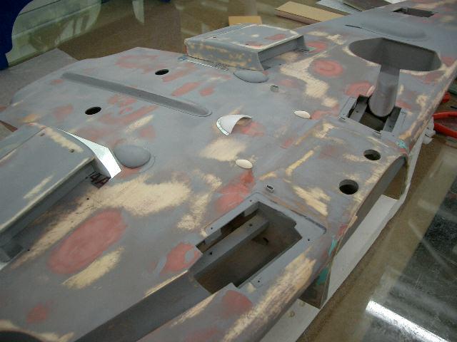

ok, where was i? oh yeah, finishing up the centerline cover and gun blisters. with a full month of curing the epoxy flow coat sanded easily with 80 and 120 grit. after that the outline was remarked from the original outline laid down on the wing, the blister popped off and sanded to the mark.
pic 2: after trimming, the foam was removed by first roughing it out with a rotary bur in the drill press and then the residual was soaked in lacquer thinner for about 15 minutes and wiped out with a paper towel and washed. two "clean" blisters.
pic 3: before gluing i first cut out the shell ejection chute. to be really accurate i should have lined this opening with small plastic sides but elected to forego that. i may go back and do it anyway if it bugs me enough (which it's starting to already ) the blisters are then glued in place by applying a small bead of 30 minute epoxy to the inside of the lip and taped into place.
pic 4: and the centerline "blister" done as well. sorry, i didn't get a chance to primer these. that'll have to wait until tomorrow.

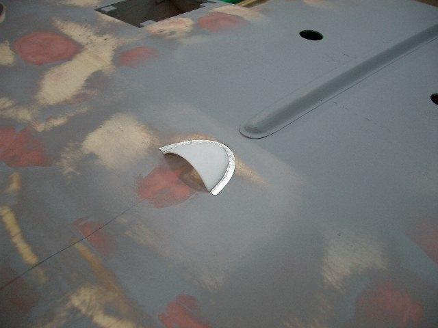

primered the blisters today.
pic 2-3: after priming, i added an air intake scoop. for this i cut a plastic spoon in half and and added a flange with some aluminum flashing. the plastic spoon was almost the exact shape of the intake.
pic 4-5: also, added some radiator detail with aluminum tape. the prototype has a wide flange coming from the radiator unit itself and this what the tape simulates.

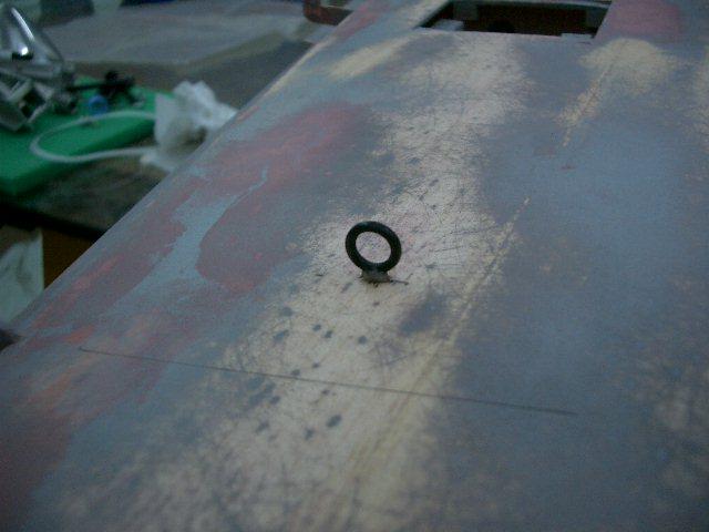

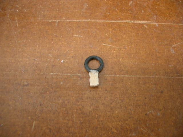

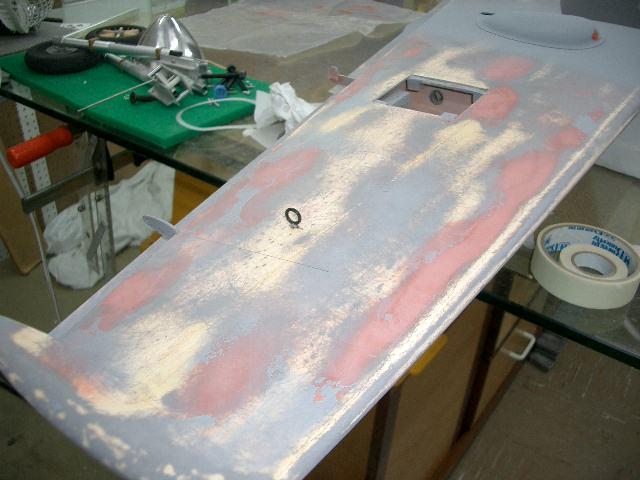

i finished up a few small details today. first, glued on the wing attachment bolt covers (beside the radiators). then added a couple more smaller bulges (not sure what they're there to cover). then, the prototype had some small airfoil shaped vents underneath the fuselage. i recreated these using K&S airfoil tubing in various sizes.
pic 3-5: then i added the mooring rings on each end of the wing. i used rubber o-rings glued to 1/32" ply for these.

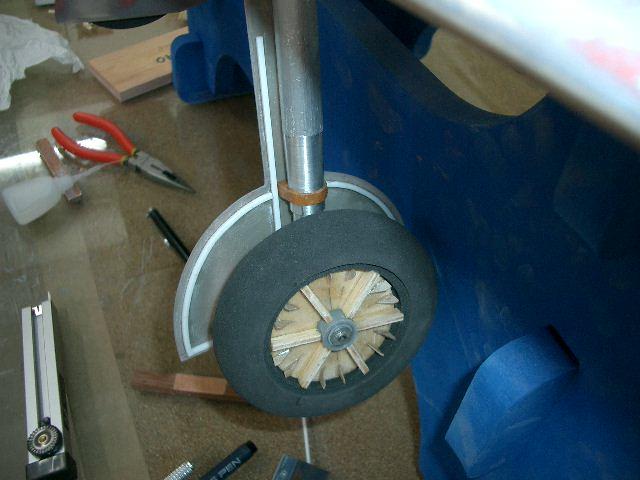

a few more minutes in the shop and i have some detail work done on the landing gear doors. to get the proper curve in the plastic i used a form to place the plastic on and heated it with a heat gun to soften and bend it. the plastic pieces add a surprising amount of weight so the only other detail i want to add is a brake line.

That's an interesting use of plastic on the gear doors. We did some similar framing on our recent P-47 build. I've been thinking about dummying up a Corsair tailwheel frame in plastistruct around metal stuts rather than building a full-on Dionysusbacchus metal frame. But if anyone has his plan sheet please send it to me and save me the agony.

tom, yeah, it's not too hard to do and probably alot lighter than doing it in metal. the only tricky part is getting the bends right.

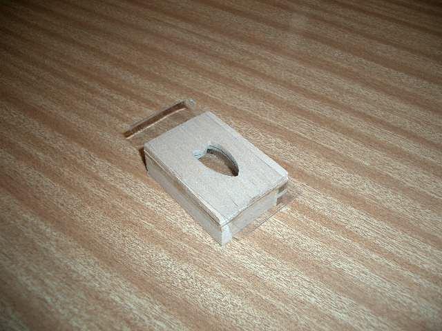

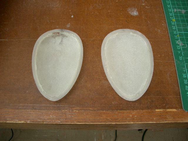

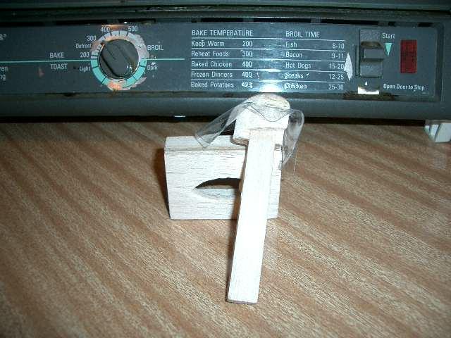

trying to finish up the bottom of the wing. the brake lines for the wheels will have to wait until i can find something to simulate the fittings for the line so they are on hold.
pic 1: i moved on to the last thing i want to do to the bottom (i think anyway). i made some hinge covers for the aileron/flap hinge. to do this right i needed the equipment to vacuum form which i don't have. but i happened to run across an article in RCSI mag (sorry, i can't remember the name or even locate the article now) that showed how to use a male/female form to make simple plastic parts. first, the part that is to be reproduced is made. in this case i'll only be using the top half for the cover. the rest of the form just helps the shaping and makes it easier to get the shaped plastic off (instead of trapping the form).
pic 2: then an outline of that part is cut out of ply.
pic 3: you can see i used a toaster oven set at 350 to heat the plastic. once it sagged i removed it from the oven and used the male form to push the plastic through the ply mold with the result below. the trick to this is to make a very close fit between the two forms. i found the best fit really left little room for the plastic but when heated it worked pretty good.
pic 4: the plastic i used was recycled packaging from a mp3 player. i ended making 5 pieces but only got 3 useable ones. that's ok, i only need 2.

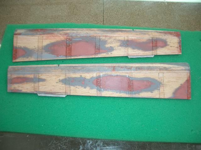

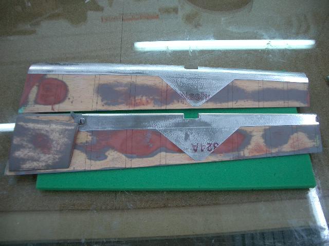

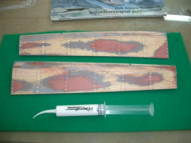

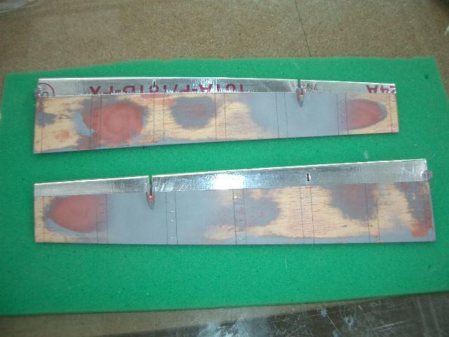

to finish up the detailing on the ailerons i added a simulated metal subsurface and rib stitching. i used BT's plan suggestion for simulating the metal frame by using tissue and dope except for the the underside l.e. of the aileron. for that i used aluminum foil tape mostly to see the difference in that and the tissue.
pic 2: then an application syringe was used to lay down a fine line of white glue to simulate the rib stitching. even though i've been around airplanes for 20 years i've never seen rib stitching up close on the real thing so i was kind of guessing here.
pic 3: with the "stitches" dry, a strip of tissue was doped on top. and the finishing touch was a trim tab added with the same aluminum flashing used before.

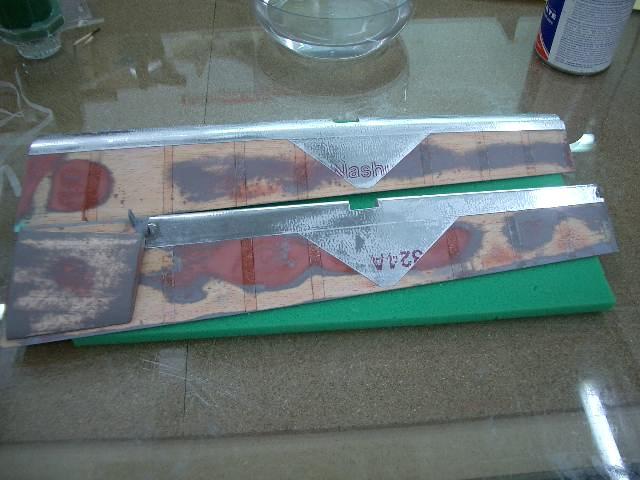

the flaps are mostly done now with the same detail treatment as the ailerons. i elected to use the aluminum tape to simulate the metal structure for the flaps as i was having too much trouble with the tissue. the only thing left to do is add the simulated rib stitching which has already been marked.

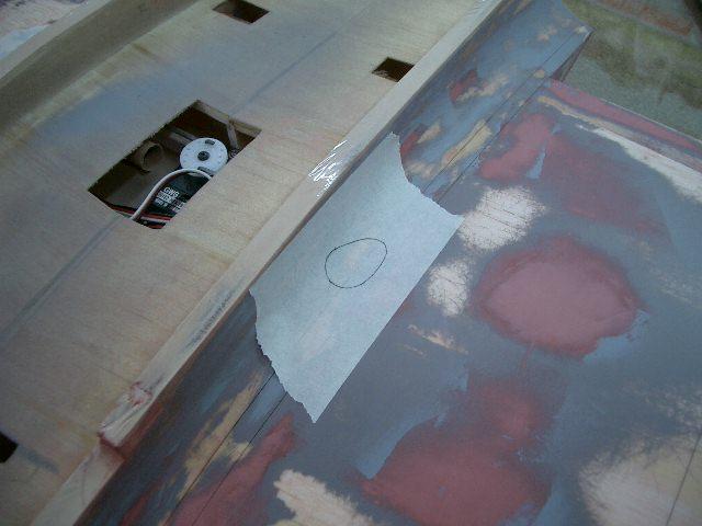

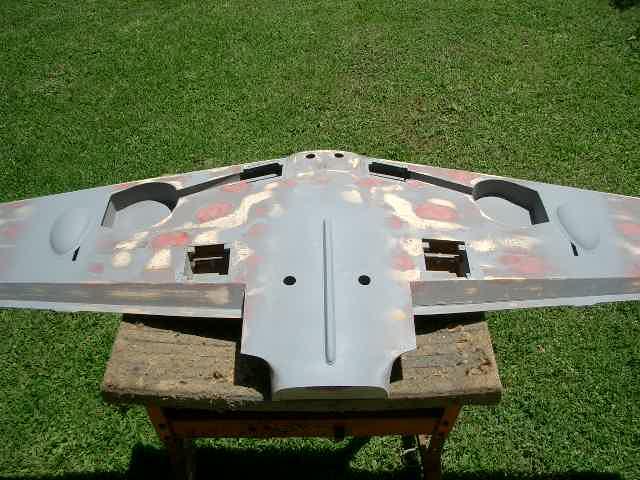

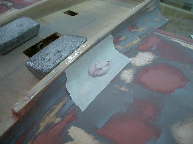

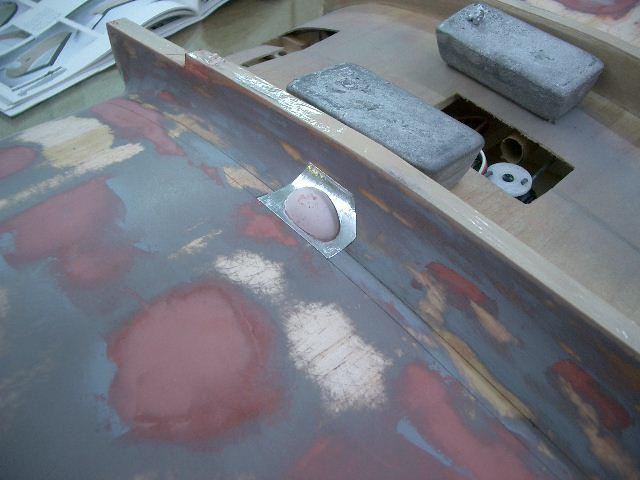

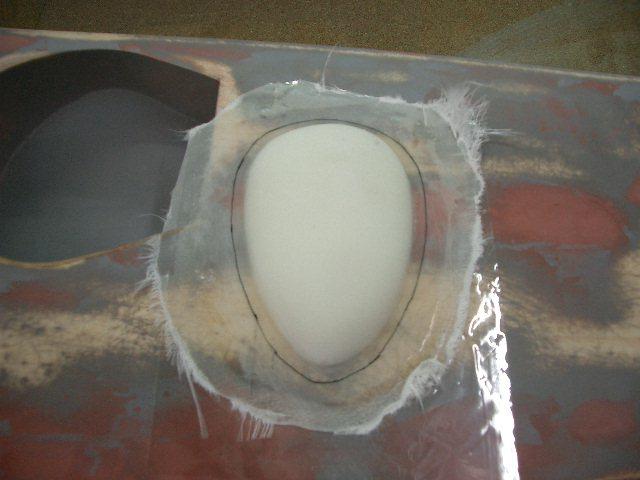

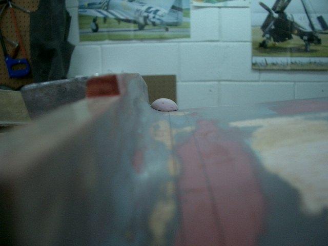

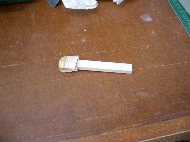

just about have the detailing on the wing wrapped up.

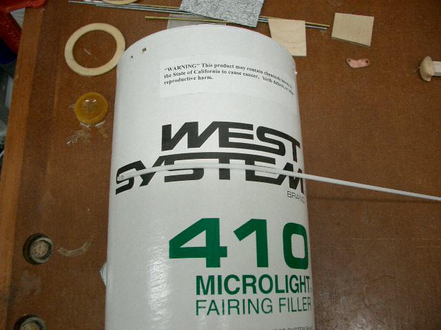

pic 1: added the upper wing attachment bolt covers today as they are a fairly prominent feature on the upper wing. to make these i used evercoat polyester putty because the covers follow the curvature of the wing as it blends to the fuselage and that's easy to duplicate with putty. first thing is to mark out the position on the wing. then i put down some thin masking tape and retraced the outline onto the tape.
pic 2: then a dolop of putty. then nice thing about penning in the outline on the tape is that it transfers to the putty making sanding to the correct outline easier.
pic 3-4: two photos showing final sanded covers, the second photo showing how the putty follows the wing curvature exactly.
pic 5: and finally a bit of aluminum tape to simulate the flange of the cover and the cover ca'ed into place on the tape.
only two things remaining on the wing, 1) add round inspection covers which will have to wait for a bit until i can bring back my circular cuttter and 2) wingtip lights which has to wait for the led's. always something.

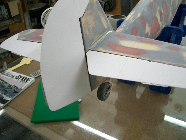

while not completely finished with the wing, i've moved on to the fuselage starting with the rear.
added the trim tabs to both elevator halves and the rudder.
