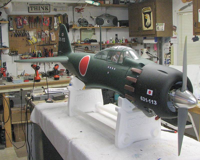

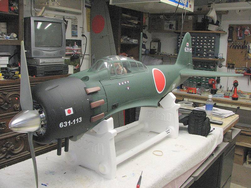

My CMPro 82" ZEKE is just about ready to fly.
No retracts because I have to write an honest review of what comes in the kit box, not what I had to add to get it to be perfect.
I'm using a Zenoah G-45, not for power but for nose weight. The 5 pound engine with spinner and mount wasn't enough to get the plane to balance and I had to add a full pound of lead to the nose to get the CG at about 6" behind leading edge.
Total weight of the plane is 20 pounds 1/2 ounce, quite a bit more than advertised. About 40% more!
Ground testing this week and everything looks great including range check. It should be good because I'm using a Spektrum DX7 radio system.

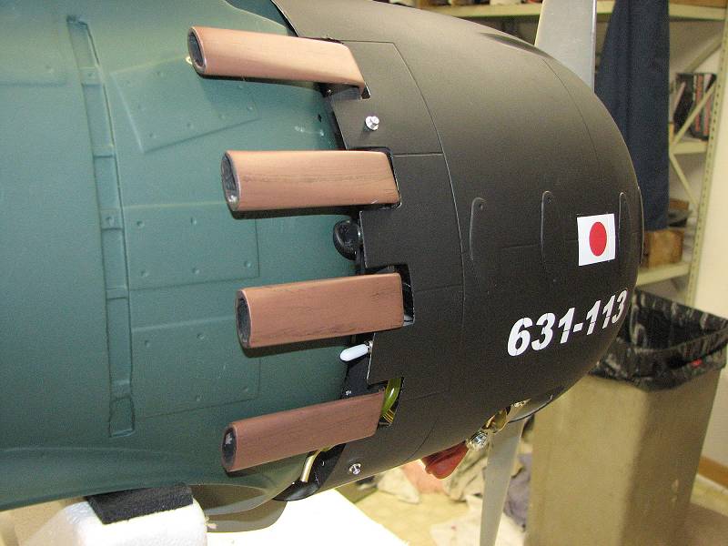

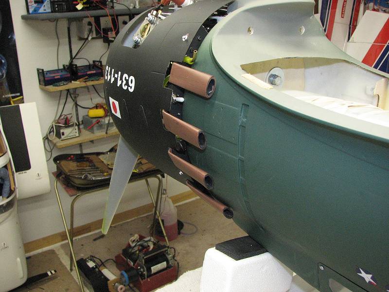

Here's some photos of the fuselage:
(find the fuel filler, the kill switch and the tank vent)

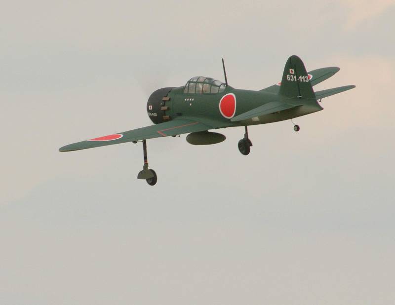

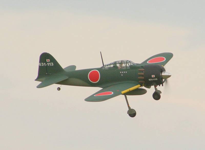

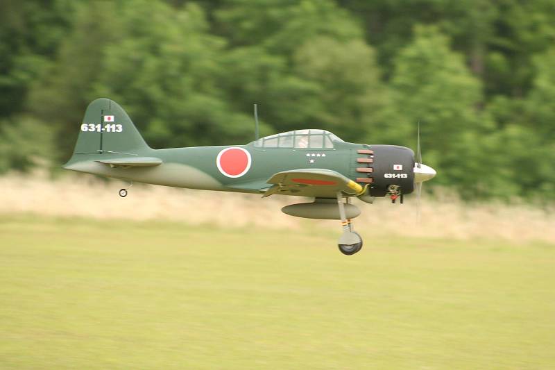

We flew the CMPro ZEKE last evening. Other than the main gear legs bending back on a taxi test and on one landing, it did just fine.
I'd replace the gear legs with "real' music wire before even setting the plane on it's wheels!
Adequate power with a Zenoah G-45. Most flying done at half throttle. It'll do all the normal warbird aerobatics with ease.
It looks like the CG point stated in the "manual" is pretty close, if not a bit nose heavy.
It did NOT fly like a 20 pound warbird with a 40 oz/sq ft wing loading. More like a 15 pound sport scale model.
Here's some photos
Here's some photos
