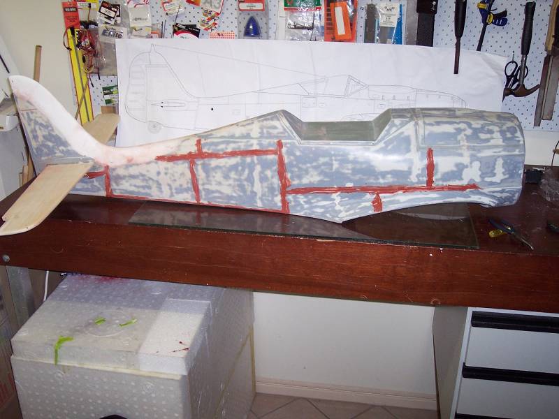

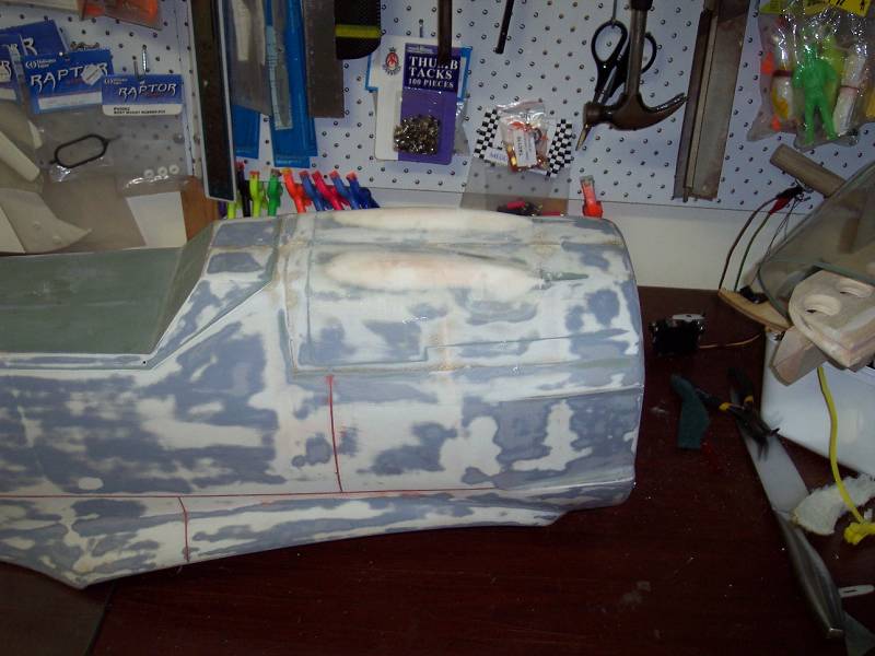

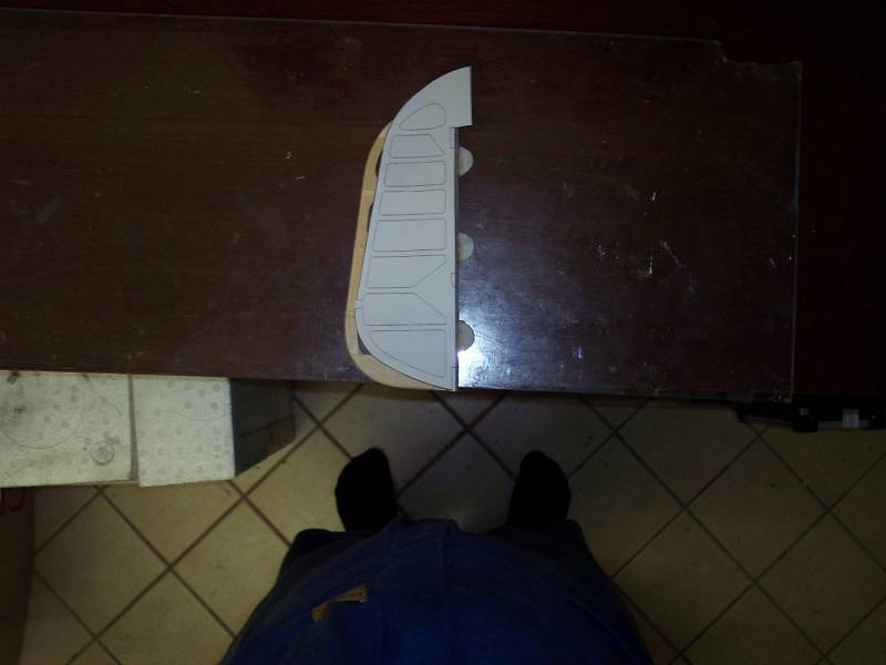

Hey everyone,
I thought i'd start a thread on my kitbashing of the CMPro Fw-190. Now i know that many people like this ARF, but i cannot stand the paint scheme and the shape as many issues. I know it's meant to be based on the WAR FW-190 but i'm sure that aircraft was based of the real Fw-190 so i hope to bring it back to were it looks a little closer to the real thing.
Firstly i have flown the fw-190 a few times and i have to say it flew really nicely, with the landing speed being very low. I used the model to break in an O.S. 1.20 FS pumper, but found her to be a little underpowered, and i'm sure the fixed gear and the 800grams of lead up front didn't help either.
I started the kitbash by removing the canopy and making a plaster of paris copy. the canopy is one of the first things i noticed that is wrong and it's relativily easily fixed. this is off getting a test pull done so i'll post pic's when it gets back. while the plaster was drying i scanned some 3-veiws drawings. I used the Kagero series of books on the Fw-190. There are 4 volumes and i have to say they are some of the best study of an aircraft books i have come across. I then took some pic's of the fw and when i put the three veiws over the top of the pic's the shape issues became all the more apparent.......
thanks
Dave

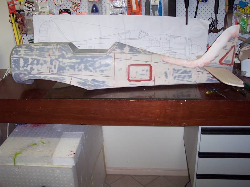

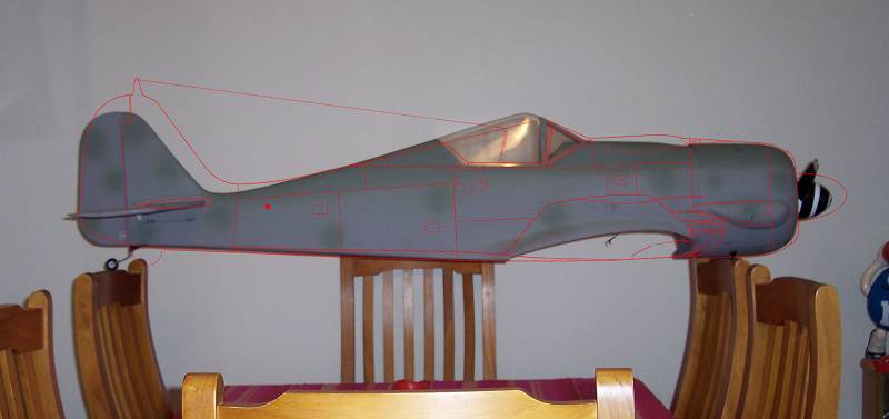

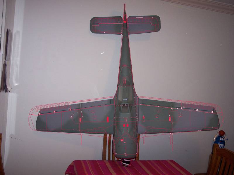

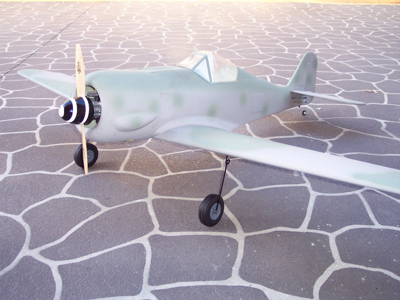

As you can see from the two picures below there are plenty of areas which require adjustment, but i have to say i was pretty disappointed when i saw how undersized the wing was in relation to the fuse. After thinking about it, the only real way to deal with this would be to build a new wing. this is beyond what i wanted to do with this kit so i will stick with the kit's foam core job.
where i plan to change is the flaps on the wing to the correct split flaps, correct the wingtip shape, and also correct the aileron shape.
I have been working with Lenny at shindin retracts to make a set of "drop-in" retracts for this model and they should be ready in the next few weeks.
for the fuse, i plan to increase the tail area, and build a new rudder, a new canopy, work on the gun blisters forward of the canopy, and if i get really excited, also reduce the size of the blisters on the cowl. The hozi stab will also get a little attention, to reduce it's size to a more scale size.
firstly i removed all the gear out of the model and stripped the covering off the wings and hori stab. came off too easy. then i sanded the paint off the fuse. REAL HARD work!!!!! i couldn't believe how hard is was.... should have used paint stripper
thanks
dave

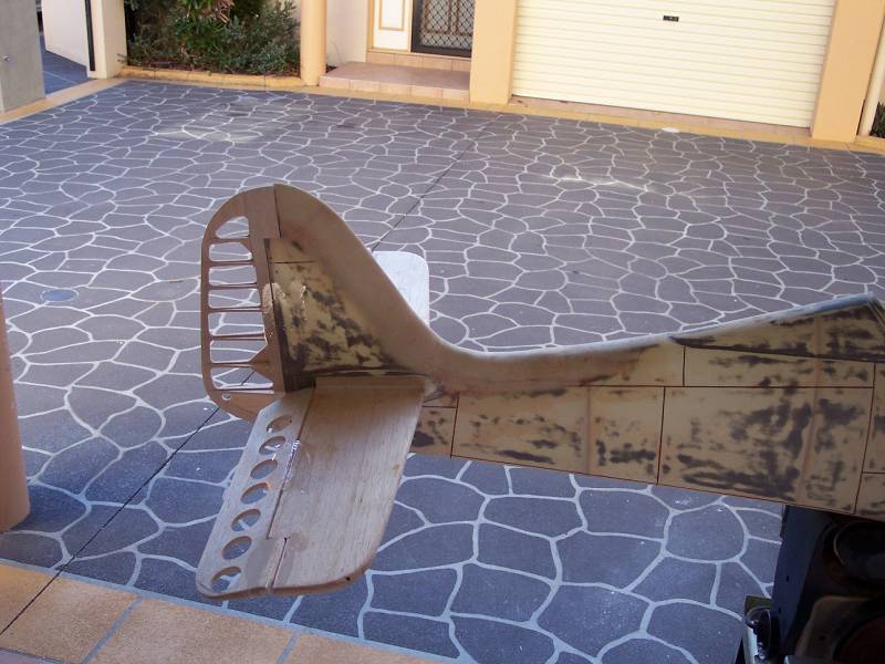

That big oversized horizontal stab is one of the main reasons these CMP's fly so nicely and slow down for landings.
I too wanted to start bashing mine during and after the build because of the typical non-scale FW190-A series flaws. But I could see that I was heading into that never ending search for the "LOOK" that can never be from this plane. Don't get me wrong,,, I admire anyone who strives for more realistic scale features on an ARF. And what your doing is wonderful. If you can mold some extra parts I might be interested as would others i bet. This is a cheap plane mean't for flying. It will never be a scale contest contender.
When I open RCU from my favorites list this week and see my CMP FW190 photo on the opening page I should be proud of my work and my paint scheme, etc. But instead I just think about the kit and scratch built Wurgers I see the master builders doing. Such as Ali's new 190 and the others running the big radial engines with the scale struts , flaps, blisters and oil coolers. I even see some with working cowl flaps. Others are detailed right down to the Revi gunsights. I'd be scared to death to ever fly the thing after that much labor. The saito 150 flys this plane smartly and the rx battery and onboard glow plus 7oz makes the balance perfect. This is a great plane to put a 25 to 40cc gasser in.
Again,,, I'm not being a sad sack party pooper here. I'm just saying that after all the research is done,,, your looking at making molds for everything if you want true scale. Why not just build one from scratch? Probably the same reasons I don't tackle that job.
Keep up the good work and I'll be following along as you post.

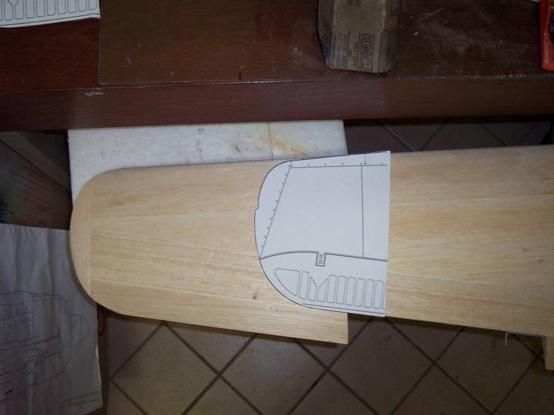

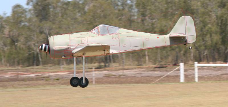

I our club only has grass runways as do most clubs in australia that i have been too....
I did reinforce the landing gear area with 1/4" dowl, but i won't play with the mounts till i get the retracts from lenny. Foam core wings are ok, you just have to make sure you spread the loads out further than in a built up wing that all. Having said that, the polystyrene used in this wing is some of the lowest density i have ever seen[:'(], which doesn't help the cause.
Haven't done a whole heap because i'm still putting the finishing touches to my Mustang, but i did finish sanding the fuse and cowl, and have started gluing polystyrene foam to the fin/spine area to see if i will get away with enlarging that area.
thanks
dave

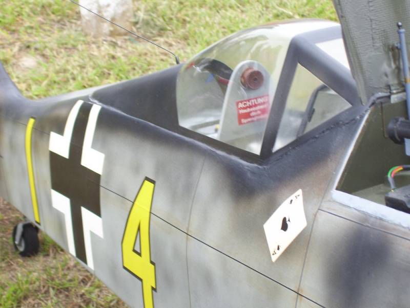

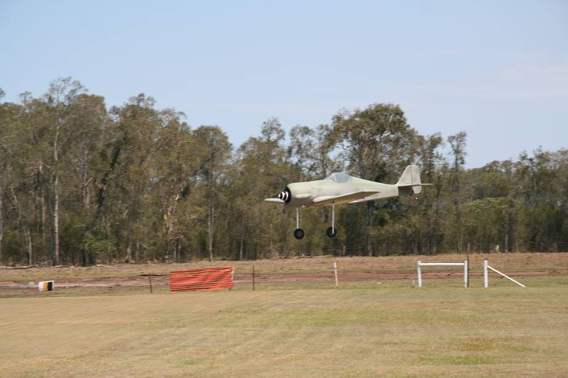

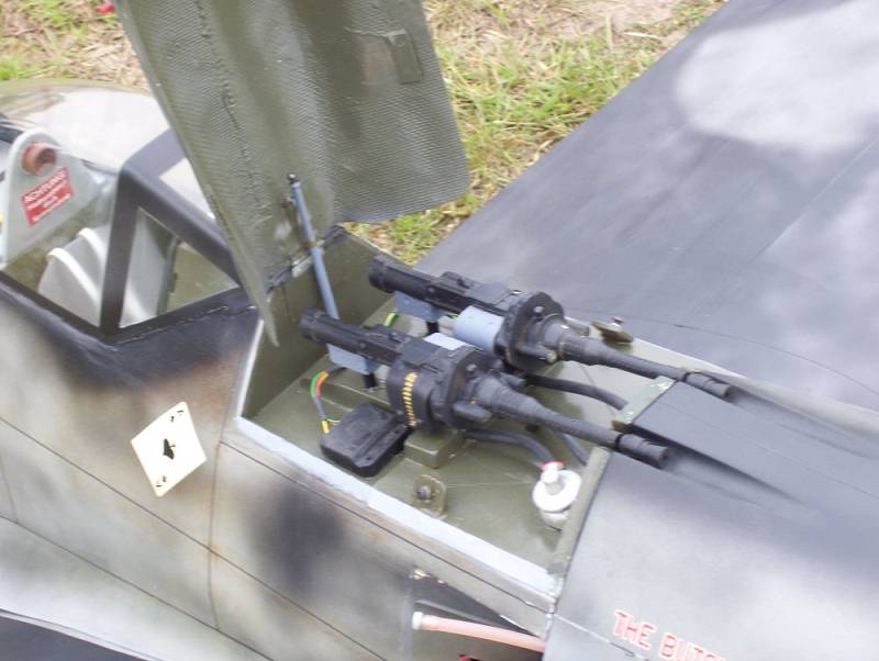

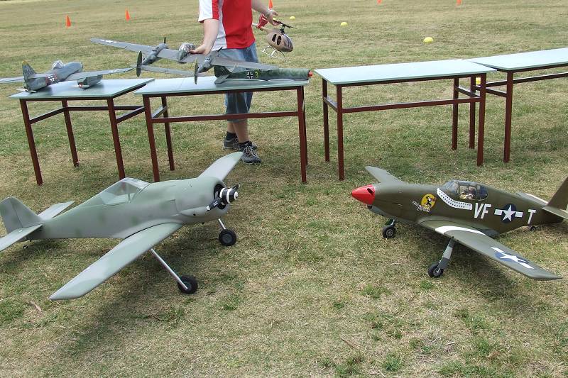

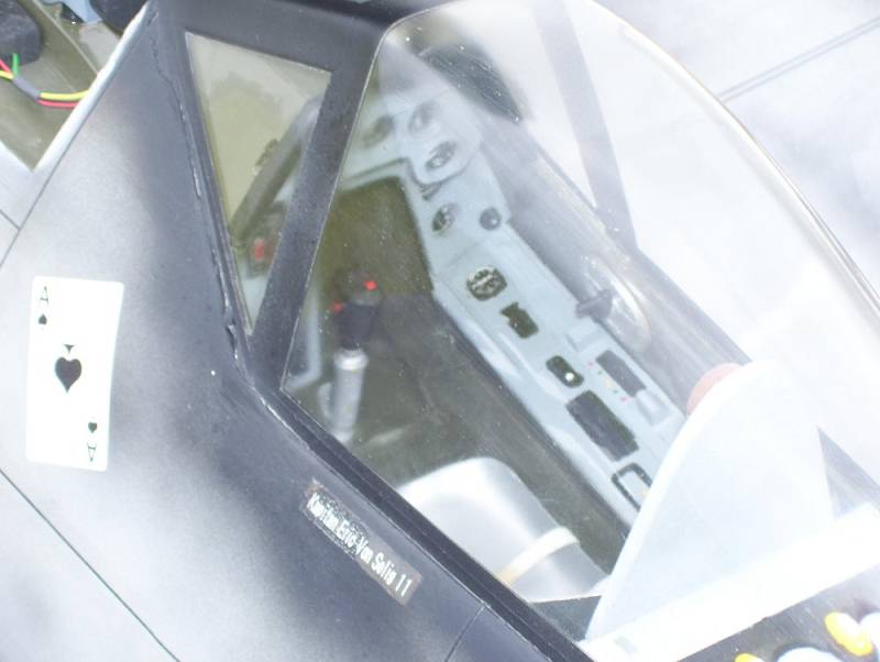

Update: Flew at a Warbird Fly-in sat and took a few pics of the scratch built FW190-A6 sitting next to me in the pits. Glad I didn't take my 190. Would have had to look over at this sweet wurger the whole time. lol

Is that butcher bird an IMP kit? the 1/5 scale gun kit in the nose of it looks familiar.... real nice looking, done a great job with it.

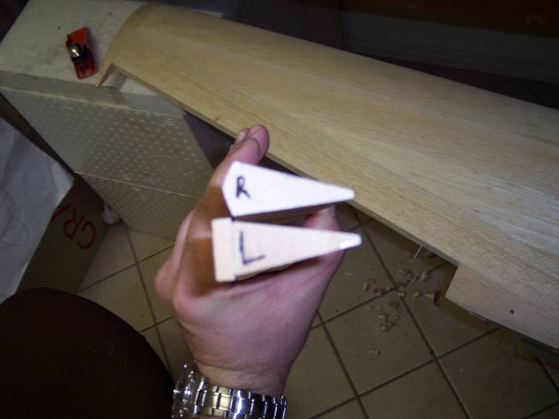

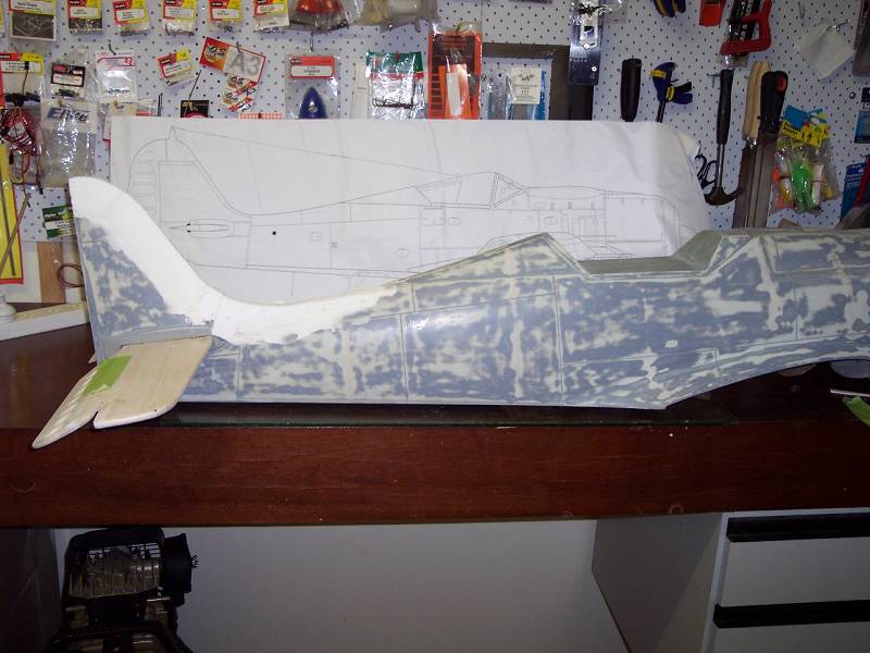

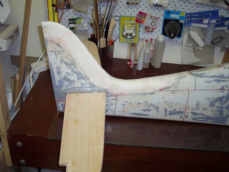

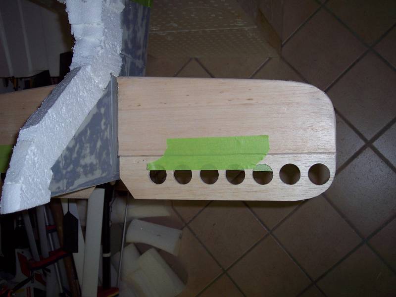

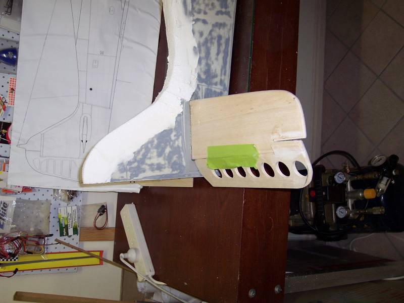

The reshaping of the hori stab is complete, and don't worry sturtz i only really rounded the ends and removed 1/8" off the trailing edge of the elevators, and i built in the aerodynamic balance tabs on the ends of the elevators.
I have also rough shaped the foam added to the verti stab. a little more shaping and then i'll glass it once i'm happy.
Dave

Dave,,, looking good !!! Are you planning to recess the vert stab at the top for the upper rudder tab ? This was another scale touch I never understood why they didn't do while drawing up the plans.
Keep up the good work,,,looking forward to your next post.

Yeah, I will glass it all the way back to the rudder hinge line and then cut back the rudders balance tab. I have to really start building the rudder cos it would make the shaping of the foam a little easier.. Talking of things they should have done right from the start would be the correctly sized fin/rudder and as jagdfleiger started the over sized cowl blisters. both very noticeable and both time consuming to fix.

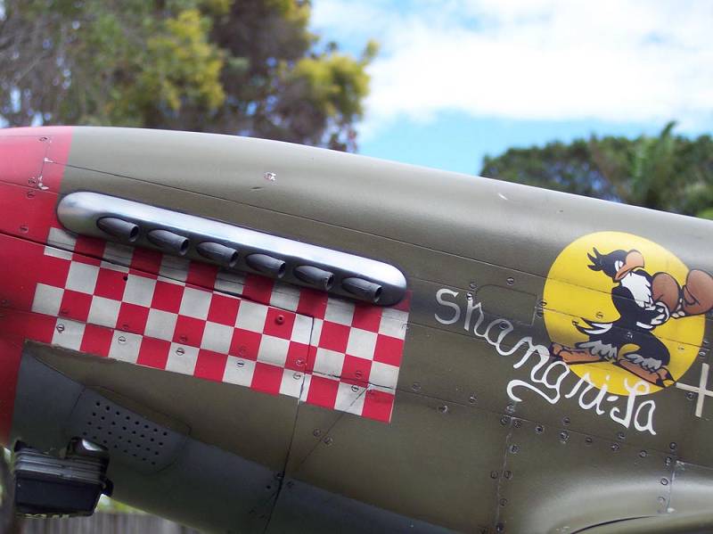

I have posted on your thread a fair few times already, but it was getting pretty long and busy so i thought i'd start my own

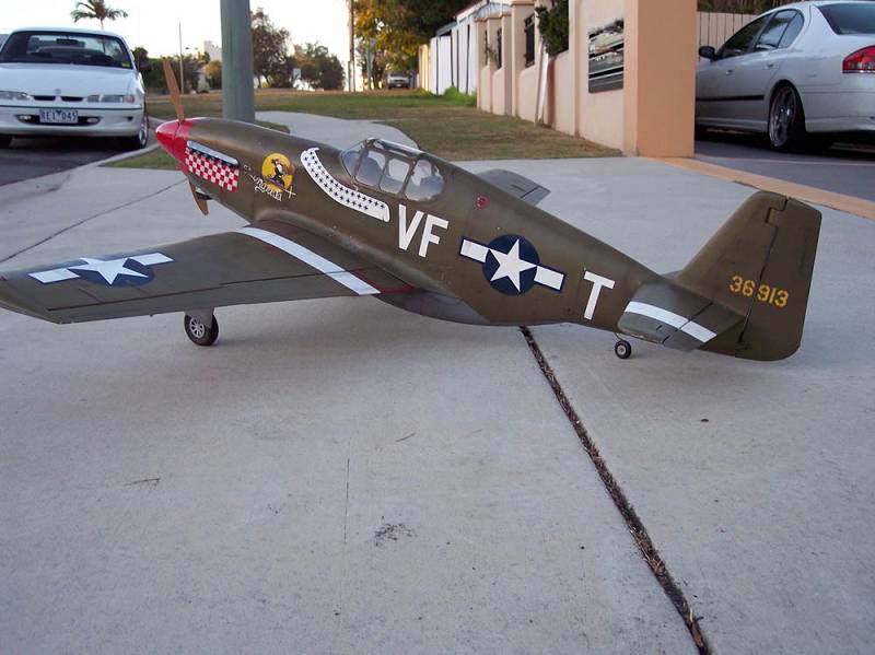

As for the P-51B, well you asked for it.
It's a Top Flite 1/7 P-51D gold edition kit with the "B" conversion kit. I acutally bought the Fw-190 to run in the O.S. 1.20 fs before i installed it into the mustang. She have a fair few modifications such as full depth cockpit, working inner and outer gear doors, "B" style gun ports, panel lines and duz fastners, etc... equipment list is a follows:
O.S. 1.20 FS pumper
Hi-tec Hs-85MG's on each aileron and flap (4 total)
Hi-tec 425BB for the rest (6 total)
Dual 4.8V 100mah Ni-Cd's on independant switches
Robart retracts, oleos, and dimond tread wheels

I have been working away at it here and there as i get time to do it.
so far, i have sanded the foam down to the right shape, i also added some lightweight filler to the gun bilsters in front of the canopy because these were a little undersized.
I have new glassed over both of these areas with two layers of 3oz cloth, and sanded it back, i will now add the flow coat to the glassed areas before i move on. the tail area is already looking heaps better, but the change will be most noticeable once it's all painted in the primer.
I also used some filler on the panel lines to get rid of those so i can place them in their correct loation and a little more subtle
thanks
dave

Again working on her slowly between 3 other projects and some repairs, but it wouldn't be an avid R/C modeller if i wasn't
I have glued some balsa to make the fillets between the fuse and the hori stab, added some filler and sanded. I will glass it all together when i glass the hori stab hopefully tomorrow. My composite technician buddies have told me that i need to make sure i glass while its warm and not while it's cold at night, and seing as it's 1am, it i'll have to wait.
I also printed out the three view drawing, rudder section enlarged to the same size as my vertical stabilizer. i have placed the kit's rudder over and under the drawing to see how far out it is..... hummm[:@]
It's basically of the same construction which is typical of these warbirds, i used 2 layers of 1.5mm balsa (1/16") ") glued cross grained for the crutch, followed by 8mm hard balsa for the leading edge and medium/soft 3mm balsa for the ribs. all i have to add now is the soft balsa block for the top and bottom of the rudder and she is complete, and ready for covering. as it stands now, my new rudder is 25% lighter than the kit one.
Over the next few days i hope to glass the hori stab and start on the tail wheel area followed by a decision about what type of hinge i'm going to use on the rudder and also wheather i'm going to use a pull-pull cable system or stick with the original pushrod setup.
I also poured another copy of the canopy because i wasn't happy with the adjustments i had made to the first one, this one looks better and i'll try and get a pull of it done next week.
thanks
dave

I have been putting in some more work.
Firstly, i wanted to reattach the ailerons to the wing so that i can cut out more scale shaped ones. I sanded the leading edge flat and then glued on a piece of balsa. Once sanded to shape, i attached to the wing and sanded smooth. I once again printed out a full sized copy of the wing tip and then placed over the wing tip marked out, and cut.
I also realised just how big the scale sized ailerons will be and i reckon i'll have to half my throws.
dave
