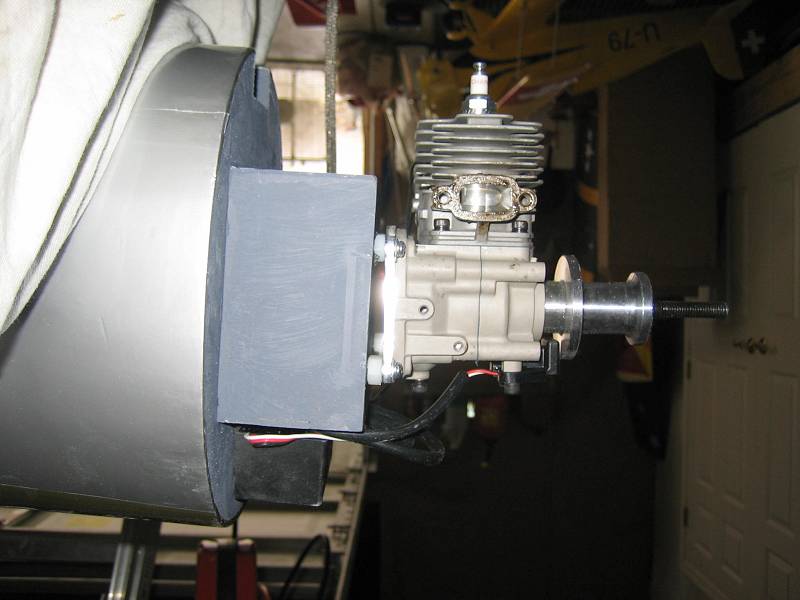

Back to the P-36A, I installed the engine last night.
I'm using a Zenoah G20ie gasoline engine, I'm so tired of cleaning up all that expensive slime after flights and having that oily exhaust slowly eat up the wood.
With the ability to invert the carb, it fits nicely under the cowl, needing only a few minor openings for the carb & exhaust pipe.
Pics to follow

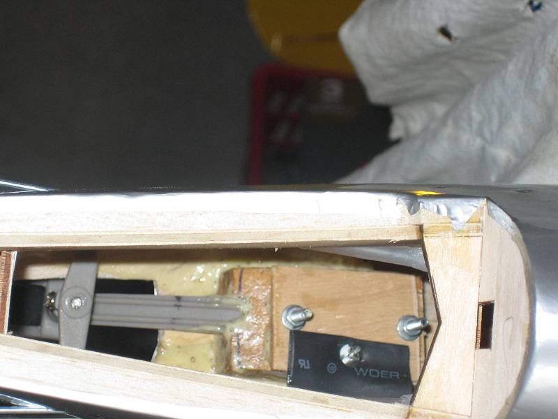

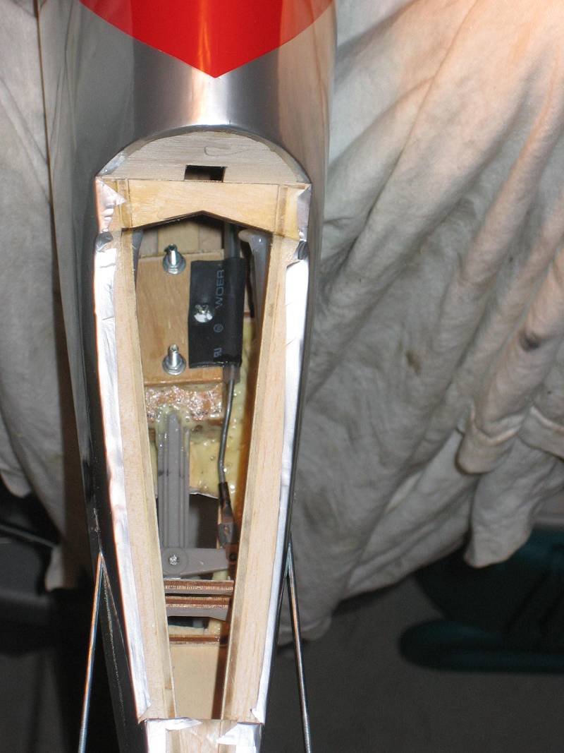

I looked at the wing in more detail, and the aluminum spar/ tube is kindof in the way of where the landing gear struts will go, unfortunately, surgery is a must.
it had me considering making this a french, chinese or Norwegian version with fixed/ conventional gear & wheelpants, but where's the fun in that?!!

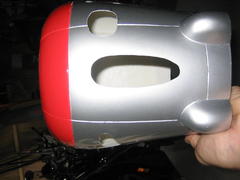

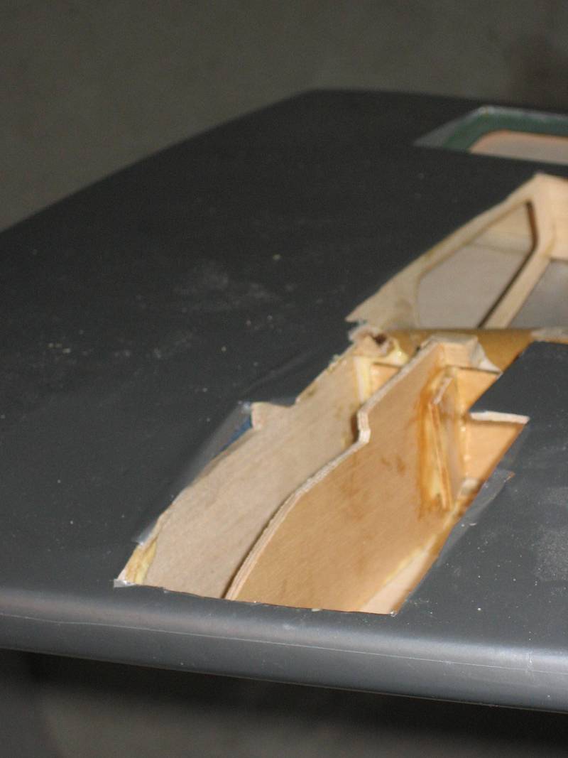

Here are some more pics, These show the G20ie installation, cuts req'd for the cowling.
and probably most importantly some images of the inside of the wing. One can clearly see the tube for the aluminum spar, and the variosu wing ribs.
I've already cut out where the aileron servo goes, and you can see I've put a black marker at the points where the flap servo should go, but will need to be relocated.

So, Here are the pics showing the tailwheel mods, utilizing a Semi-scale tailwheel and mounting it to the the interior of the plane, so that it looks even more scale-like, even though it can't be retracted.[8D]
Also shown is the surgery to make the retracts work correctly as the real plane did.
these are the Robart 90 deg. rotating air retracts...it took a bit of reworking, and I created 4 new (1/2) leading edge airfoil bulhead, the reinforced them with hardwood and 1/8th ply.
Not particularly scale, but close enough to enjoy it more than as it came from the box.
The last item to fix will be the blisters on the leading edge of the wing to conceal the front of the retracts.
