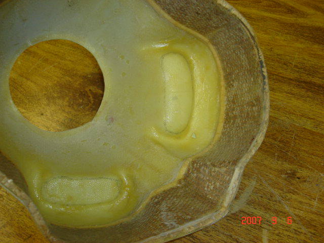

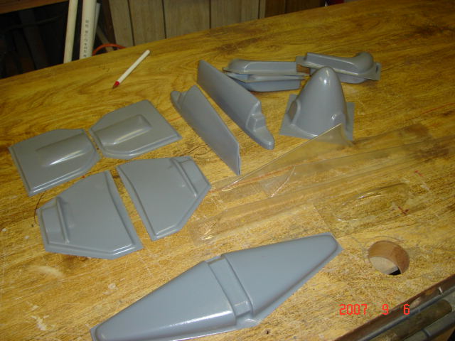

Finally finished my P-39 and got the shop reasonable clean, so it's time to start a new project. I won't really dive in until after I return from Bomber Field next weekend.

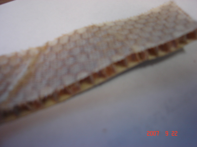

Got a Ramon Torres Aerospace T-34C kit, with the "honeycomb" glass fuse. This fuse is really neat with the honeycomb. Very light, but super stiff, even without the bulkheads installed. Such that they are, the 2 rear bulkheads are 3/8" blue foam, and there is a 1/8 thick plywood ring that fits in front of the wing saddle. More info can be found here: http://rtaerospace.com/Beechcraft_T34A_kit.htm
The first pic shows all the cut wood parts, next are some pics of the fuse & cowl, with some inside shots to show the honeycomb. The next is a shot of all the plastic parts. They are molded in a really rigid and thick ABS plastic that is pretty lite. Parts include a scale spinner, tail cone, exhaust stacks, wing tips, stab & fin fairings, inner & outer main gear doors, and wingtip lite lenses. Plans are 2 pages that are really well drawn.

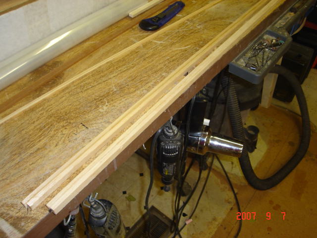

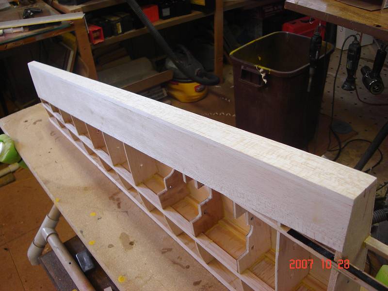

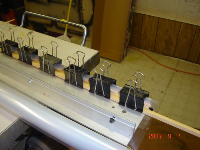

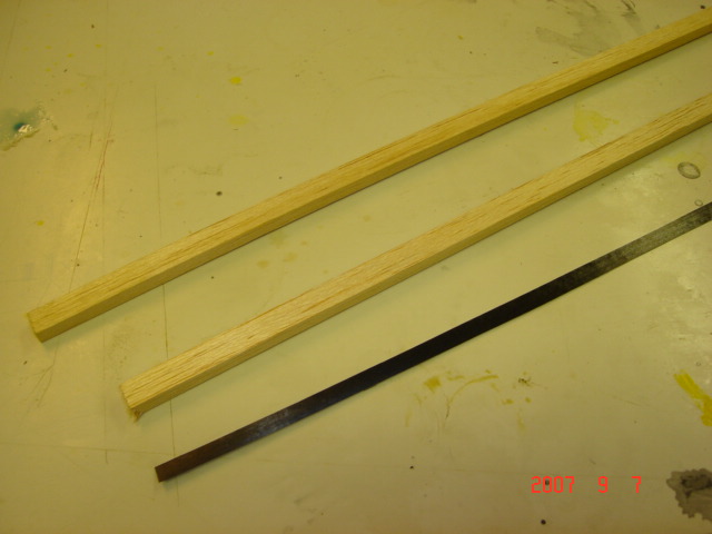

Worked on spars today. Calls for 1/2 x 3/8 hardwood for the wing spars, top and bottom, that tap[er to about 5/16 at the tip rib. That's a lot of weight, and I don't have any hard wood stock in those dimensions. So....... I am making my own laminates. I am using 2 pieces of 1/4 x 3/8 balsa. I am laminating them together, with a strip of carbon fibre in between. Makes for really stiff spars, that are 1/2 the weight of the hardwood.
And easier to taper.

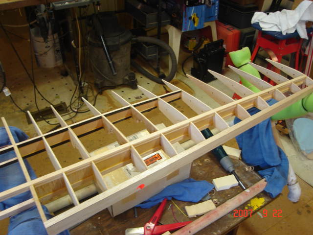

I don't plan to do a complete step by step build on this, but since I have never used a wing jig, and, I am sure a lot others have not, I will show this portion step by step. I am using an original Adjusto-jig. My kit was designed to be built on this jig so all the holes were already drilled.
First pics show the mods I had to do to the retract mount doublers for the CJM retracts. I'm not a fan of CJM, but I've got them, so in they go.
Next pic shows the the jig set-up with correct spacing for the ribs.
Now all the ribs are installed on the rod ans placed on the jig. You need to make sure all are on the correct side of the red rod mounts. The rods are held down with rubber bands.
Next, straight pieces of stock are clamped to the trailing edge of the ribs, to create a perfectly straight T/E, and the leading edge is glued on. I will be doing most all of the wing build with Aliphatic Resin glue, (no odor and easier to chew the residue off the fingers).
The spars are added, and glued in place.

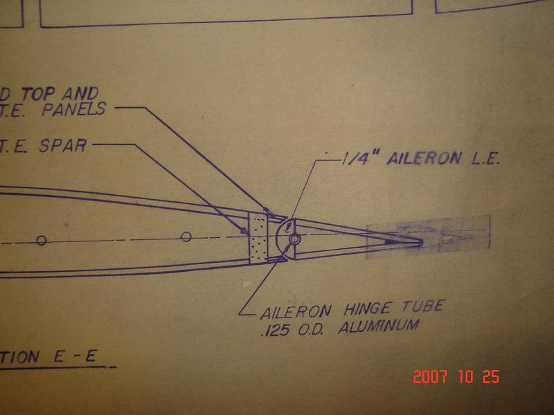

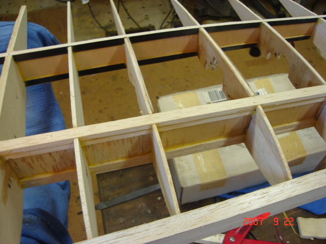

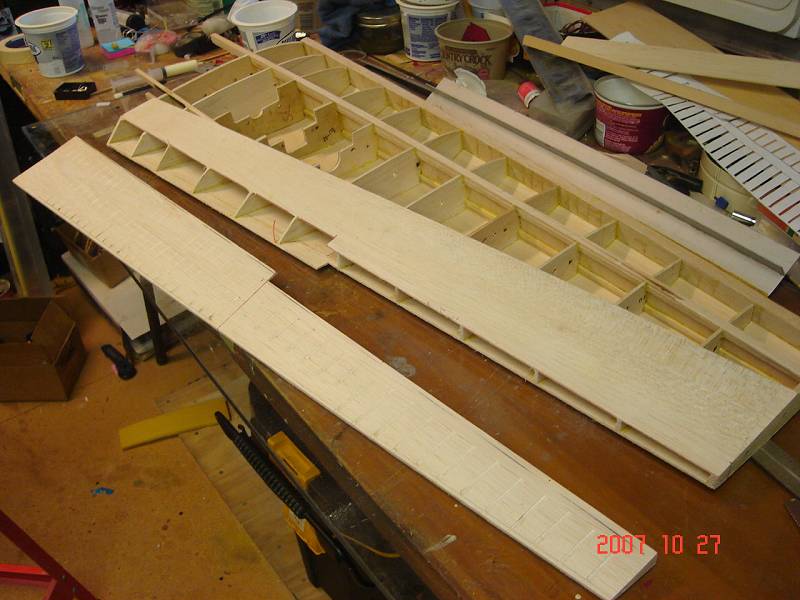

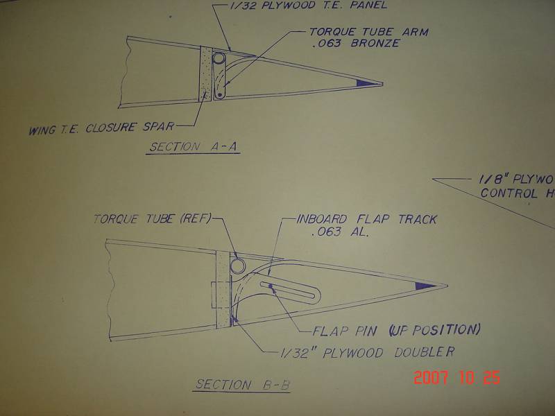

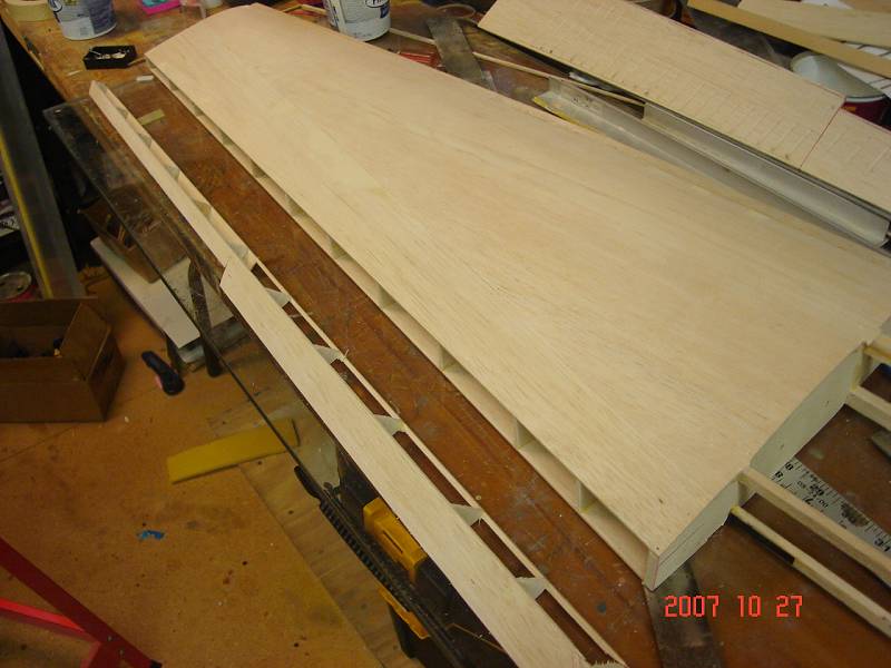

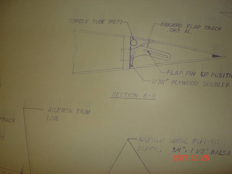

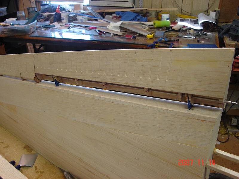

The first 2 pics show the left wing after all the shear webs have been installed, and the spars have been planed down to the correct taper. It is now complete enough to remove it from the jij.
I will put it back on when I begin to sheet it, and complete most of the sheeting on the jig.
Next are some pics of the retract mount, and pics of the plans showing the original retract set-up. You can see why I had to make the changes noted above.

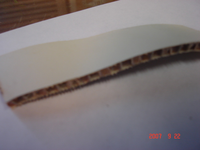

Here are some pics of the engine cooling duct. I was messing with it so I thought I would post them. The duct is a fiberglass piece the ducts the cooling air from a hole in the firewall behind the cylinder, to a scale opening on the fuse side. I have not cut any holes in the firewall yet and the duct is just set in place to "see how it fits".
The last 2 pics are of the piece cut from the fuse outlet opening. Really gives a good idea of how the honeycomb looks.

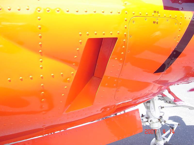

Here's what the outlet looks like on the full scale.

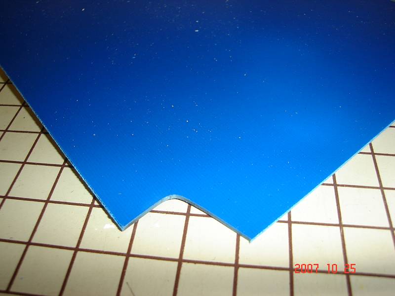

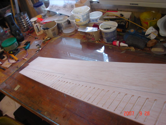

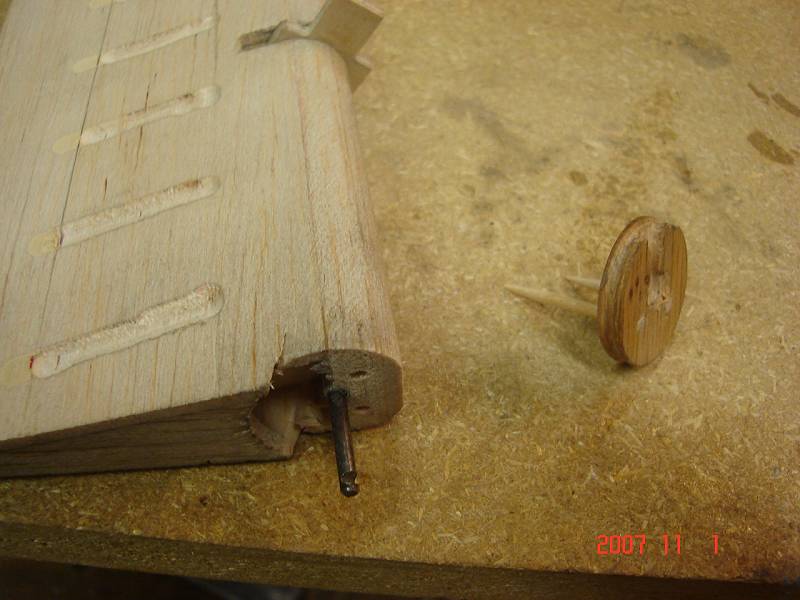

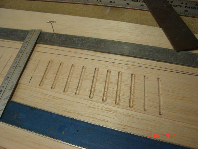

OK, here's some shots of the method I am using to simulate the corrugations on the control surfaces. The pieces will be the rear sheeting for the top of each wing panel. The same will be done with bottom sheeting for each wing half. Also the stab, elevator, fin & rudder. This idea came from a build thread for a T/F T-34 on RCSB.
I reshaped the grinding stone tip so it has a bit more radius, to keep the correct shape. All the rulers and yard sticks are held at at the correct spacing to keep all the ends lined up.

OK, seems there are some who have an interest, so I will continue. I have not done much work lately, but I have sheeted the tops of the wings. Also sheeted the bottom rear areas, so i can start on the control surfaces. I will cutting the ailerons and flaps loose. I am going use scale hinging on both. The plans call for using plywood, to make the aileron hinges, and aluminium to make the tracks for the fowler style flaps. I picked up some .060", FR-4 board, that is similar to G-10 and plan to use that. It super stiff, but seems to cut and work really clean. The last pic shows the FR-4.
More to come

Here are some shots of the plans and patterns, that show the small hinge parts I will need to make, and how they will be installed.

Here the start of the flap and aileron builds.

Decided, that since all the other controls will be hidden on this model, the ailerons should be too. So here's how it's done, per the instruction manual. Hardest part was making that pully with out a lathe.
I also included a scan of the instructions which help make the pics easier to understand.

Started on the flaps. These pics show the mounting and the sliders. Need to pick up some tubing, and brass stock, before I can build the to torque rod actuators. Will post pics of those when I get them going.
