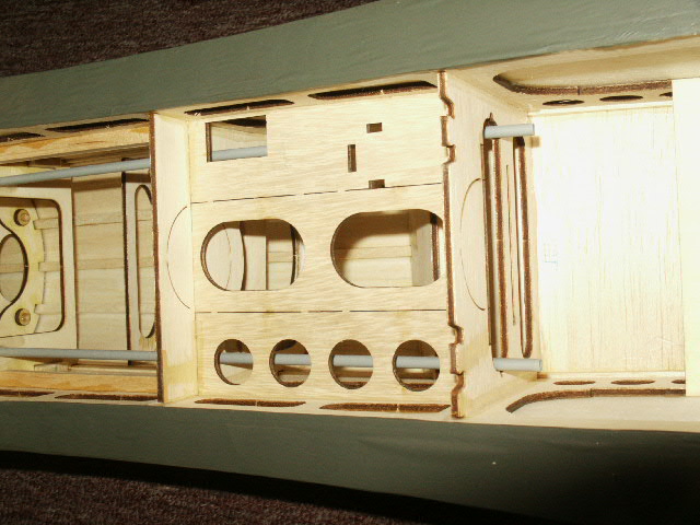

The fuselage has provision for intalling an air tank (IF optional air operated retracts are installed). See pic 8.

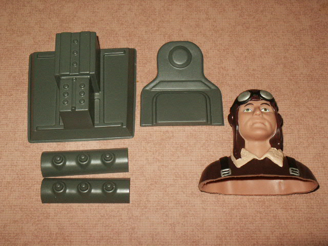

Exhaust stacks look really nice, as does pilot and cockpit kit. There is also a 4 piece ( 2 of them are decals) instrumnet panel, which I will add pic of later

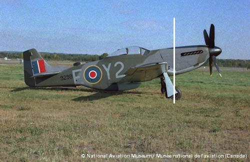

I wanted to make a few comments here, as I have been reading all the treads pertaining to this particular Mustang ARF! The outlines of this Mustang seem to be pretty good! Now realizing this is a ARF, "Scale" is a relative term, but I think we can say that his one looks good.
One thing I going to look into is the "main landing gear" position. If you look at the photo below, you notice that the wheels on the Mustang are ahead of the leading edge, whereas the wheels on the model are back a bit further. This brings up the problem of "nosing over" on grass fields that not smooth, mine included. Does it look like it might be a lot of work to somehow get the gear forward a bit????
Also, I am leading toward trying out the www.lado-tech.com retracts, as I don't want to deal with pneumatics. Probably start with the stock gear, then move up to the Lado's. The main gear also looks like it needs to be a tad longer as the wheel wells are not as close to the center of the wing to be scale! I know it's an ARF, but it looks like it could be scaled out really nice!

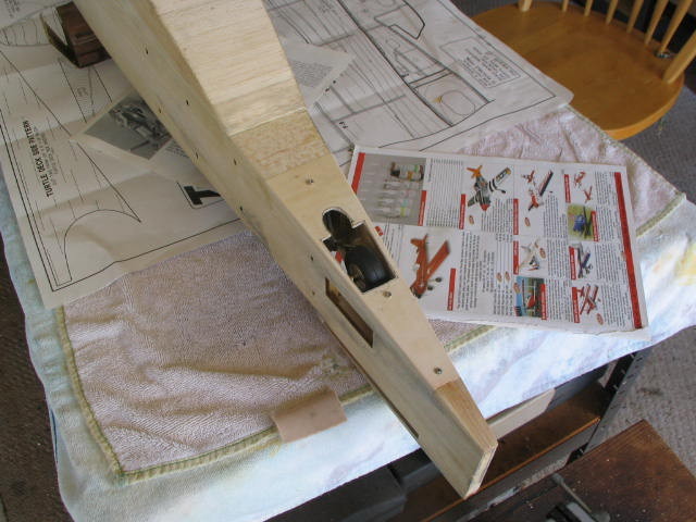

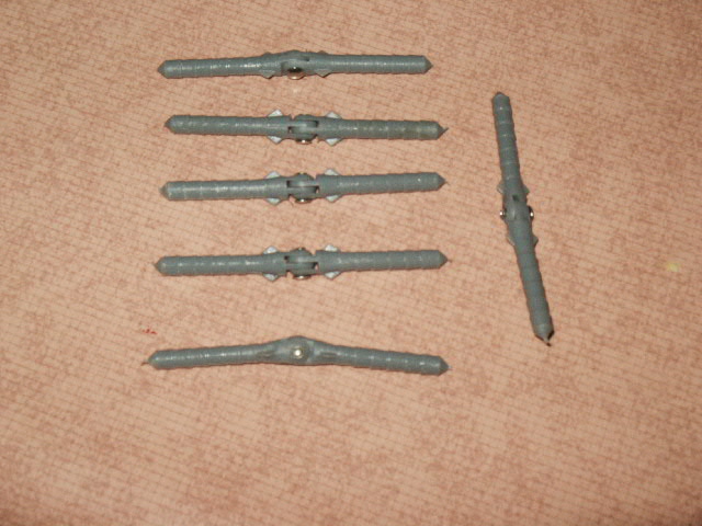

Installing the Flaps
I installed the flaps (and ailerons) today, and I must say: I think the instructions leave something to be desired concerning flap installation. My biggest concern is that no mention is made on how deep into the flaps the hinges should be installed. It is obvious that the hinge line are 'sunk' into the flaps some, but how far (deep)? The instructions just tell you more or less push them in as far as they will go, trial fit to the wing (making sure that the flaps can be moved to within 1/64" of the wing trailing edge), then epoxy them on.
In my opinion: it is important that all 3 hinges be mounting in such a way that they hinge points (C/L of the hinge, or the center of the part that moves) are lined up with each other. If they aren't: they will 'fight' each other when the flaps are lowered. Altho slight mis-alignment will probably not cause any problems, I chose to install mine the following way:
I installed them onto the wings first, with the alignment tab points even with the trailing edge on the inboard ones, halfway between the point tips and where the tabs meet the round part of the hinges (on the hinge 'bearing' side) for the middle hinges, and with the tabs completely in the wing on the outermost hinges. This should keep them all in a straight line, with the outer ones having the movable parts sticking out slightly less, to go along with a shorter chord of the flaps toward the out ends.
Then I applied the Vaseline as the instructions suggested, and epoxied the flaps onto the hinges.
I hope that makes sense, I really don't have the time to read and re-read and try to make it more clear, maybe someone else can make sense of it and try to explain better.
Pictured are the flap hinges: exactly like Robart Hinge Points, only different (a term used by Japanese: exactly same, only different).

ORIGINAL: CorsairJock
mimoore67: the 2 pics that you posted really do little (if anything) in the way of providing a comparison. First off: that is obviously NOT a Top Flite 60 size ARF Mustang wing that you have pictured. Secondly, even if it was, the 2 pics are at entirely different angles (side view of full scale, bottom view of model wing). Beyond that: it is very difficult to locate retracted wheels any farther forward in the wing in RC models. Reason: RC models must rely on a strong, uusually thick balsa leading edge, wheres full scales do not need that much strength there.
Lastly: altho I like details, and scale accuracy, I also like landing gear which is strong enough to absorb landings without damage, and that allows tracking well on grass runways. On the latter part: my feeling is that shorter landing gear makes taildraggers less likely to nose-over when on grass runways, so if the manufacturer makes the gear just a little shorter: that's alright with me. And I'm thinking that the majority of R/C flying sites do not have paved runways.
I'll disagree with on the first picture, I'm trying to show that the wheels need to be further out and that's is what I hope to do with this model, so the plane won't nose over. No matter the length of the landing gear, if it's behind the leading edge, it's my experience that the plane will nose over, even if your used the bigger tires.
The second picture obviously isn't a Top-Flite wing, but I was in a hurry and didn't say, what I was trying to illustrate. The length of the landing gear starts from just inside of the center of the wing. If you look at pictures of real Mustangs, you'll notice the inner gear doors are practically together. I know I'm nit picking and it's an ARF, but as a Pilot and having seen a lot of Mustangs in my life, I like that stance of a Mustangs, when the gear on a model is done right. Plus, if there is anyway to move the gear forward, i'll give it a try. I do understand your point about the thick balsa leading edge being used as a mount area for the gear.
Sorry, if I'm coming off like a JERK, but that's not my intention. There are a lot of ARF's out there, especially the CMP models that people in RCU have done a little extra detail and modificaton and have come up with some fabulous looking models, that look right on the ground and in the air.

I don't think you are trying to be a jerk, I just think you chose a poor way to illustrate your point. What you should have done is show a picture of a Top Flite 60 size ARF, assembled, and from the same angle as the full scale. If you opt not to use the above mentioned model, then why not another model ( such as the wing) but again: from the same vantage point.
And I agree: moving the wheels farther forward is very beneficial for ground handling, especially on grass runways.
Either way, I don't want to take up any more cyberspace with this. It wastes my time and makes it more challenging for readers to find useful info.

CorsairJock,
I had no idea the dowls were plastic. I was looking for wood dowls...this is a first time for me to see a change from wood dowls to plastic dowls. I've had issues with wood dowls, working lose and waring away. I usually fix this with brass tubing, but it's a nice touch.
To be honest...I'm very inpressed with the model. I've built a few ARF's now...and I remember when all we had for an ARF company was Lanier. I must admit...all the Lanier models flew well enough...but the construction left much to be desired. I've been building ARF WWII fighters for ten years...and with out a doubt, this is one of the better renditions of the P-51D that I have ever seen. It has flaps, and the mechanical retracts look stronger then any other ARF in this size, that I've ever seen. I usually installed Robart mechanicals in all my ARF WWII fighters-but not this one, and the attention to detail is amazing. I am impressed, and for the money...to me, it's well worth the cost. I've built the old red box P-51D Top Flight put out 30 years ago, and several others after. This is one nice Mustang... : )
I'm still stumped on what engine to put into this airframe. I'm a two stroke guy, and I've never owned or flown four stroke engines. I see your going to use a four stroke...what make and displacement engine are you going to put into your model ?
I have a set of C.J. P-51 retracts in my P-51B...I wonder if they will fit into this airframe ? But I would like an air up, spring down air system.
I would install a tail wheel retract unit into this kit, like on my "B"...but I'm not real happy with the Robart plastic tail wheel retract unit...and I don't know anyone that makes a metal one that would fit into this model. It's going to be a bit if magic to do it anyway...and its realy kind of tight in this area to work in.
Soft Landings always,
Bobby of Maui

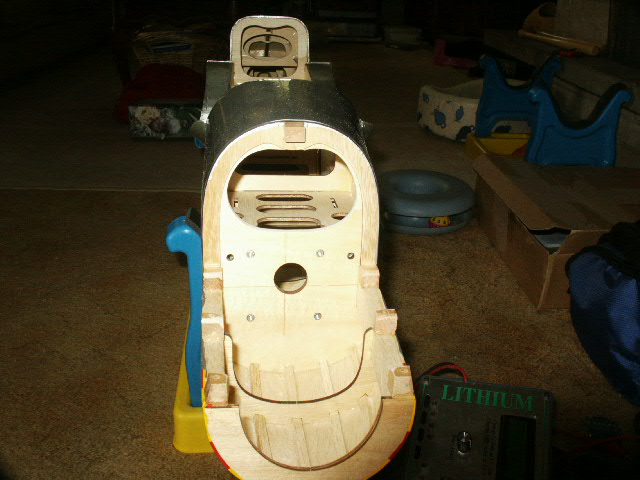

Well...I figured out what engine I'm going to use, and I had the flippen engine all the time... : ) . I'm going to install a K&B 1.00, and it drops right into the nose bay, with room to spare. This engine was purchased from Mr. C. Lee years ago, and I never had a model I would risk it in...until now. Its going to need a spacer...not a big one and I'm not sure exactlly how I will do this now. There is an issue with the exhaust on the engine, because this engine will be inverted, inside the cowl...the exhaust exits the top starboard side of the upper fixed cowl, above the scale exhaust area. I will need to modify the exhaust...but it fits easily into the model.
With the carb so low I will need to place my fuel tank as low as I can into the nose of this model.
I'm going to trial fit the C. Jet pneumatic retractable main gear tomorrow and I'll let you know how well they fit into the wing. If they fit...I'm going to exchange the gear from my "B" into this "D."

Well OK then Chris, let's compare:
The side markings do not appear to be an exact match, as you suggested, but not that far off either. The most obvious difference to me is the dorsal fin: it needs to be removed (which is what I planned on doing anyway).
In any event, since you know so much, perhaps you could help us less informed and tell us what the correct sizes should be (for 1/7th scale)?

OK Chris, I see your point: the stars ARE too small for the background/ too much border area. I did a quick check of my Major Decals inventory and they are only slightly better. Oh well.
Saito Users, NOTE: The spinner adapter nuts are 5/16 x 24 thread (for O.S. 4 strokes and mosr 2 strokes). BUMMER! That means you may have to purchase something seperately from Tower or otherwise to get youe spinner to bolt up to your engine. The Saito 1.00 has 8 mm x 1.25 thread, so this adapter may work.
Maybe this one? May need to buy a long 10 x 32 allen bolt tho:
http://www3.towerhobbies.com/cgi-bin...?&I=LXB957&P=K
OR, for a few dollars more:
http://www3.towerhobbies.com/cgi-bin...?&I=LXHMF3&P=K
I have been removing weight from my fuselage: seems theres a lot of wood thate doesn't really need to be there, especially since I will be powering mine with electric power. I have removed a total 0f 71 grams/ 2.5 oz. Here are pics of lightening holes:

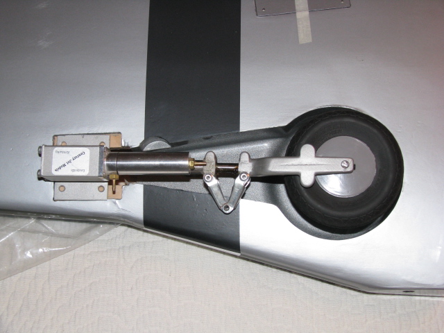

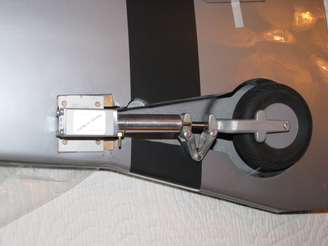

I set my C.J. retract into the left wing tonight. It went in with minamal work...but there is one issue I'm not real happy with. the wheel sticks out of the wing a bit. To lower the retracts, I would need to cut down the mounting rails...then add more hard wood underneath the mouting rails for proper support. If you look...you will see that the 3 1/4" Robart scale wheel just fits into the wheel wheel. With the C.J. P-51 retracts, that is the largest wheel that will fit...unless you cut your strut 1/4"...then a 3 1/2" wheel will fit.
I also added a small piece of 1/64th. ply to stabilze the area I needed to cut out to allow the gear to retract, and also to cover the spring area for the mechanical retracts-no longer in use. The kit also has you install the air tank in the fuse, and I am going to see if I can fit every thing on or in the wing. I did remove the mechanical retract tube in wing-wheel well, used for the actuation rod.
I'm also going to add full wing invasion strips to this model, and I need to do this for visability in flight. With all the green around our flying site...it really helps. I know a few of you scale purists might cry in your beer at this... : )...but I doubt few will know the difference.
Soft Landings Always,

Bob, Looks pretty good, but could be better. Maybe CJ will start making sets specically for this bird, that are just like your's only with shorter struts? Looks like they could be 1/4 ~ 1/2" shorter? Think you could shorten them some? Sure would be nice to see some slightly bigger wheels in there. BTW: I am now committed to using the stock retracts with RoboStruts installed, I hope I don't regret that decision. By doing so, I am limited to wheels which are just under 3 1/2".
As for the wheel poking out of the well: I noticed that the retract mount rails are not parallel with the bottom of the wing, and are at least partly responsible for the problem. I plan on using the stock retracts, but with the struts shortened (3/4" off the tops) and reversed so that the strut coils move the struts DEEPER into the wheel wells, rather that farther out. I plan to install offset RoboStruts on the stock, but shortened wire struts, just below the coils. This should result in something very simular to your's. BUT, if the wheels are poking out of the wells, I plan to use a Ernst motor thrust offset plate, cut into 4 strips and install between the retract units and the retract rails, so that the gears units will be parallel to the bottom of the wings, and hopefully allow FULL retraction.
My RoboStruts will arrive on Tuesday, I'll be working 12 hour days again, so I probably won't have any results to post until at least Wed. evening.
BTW: my Robart retractable nosewheel with 1/8" diameter strut arrives same day (which I plan on converting to retractable tailwheel). Too bad they didn't arrive before this weekend: I finally have a little time to work on it but I don't have the parts I need.
Speaking of retractable tailwheel: there are not any good/ easy options. The Robarts are not really well suited for this bird, niether is the CenturyJet mechanical tailwheel which is supposedly a P-51 retract. For one thing: the Mustang tailwheel retrafts FORWARD into the fuselage, not to the rear. This has me looking at mechanical nosewheel retracts designed to '.25 ~ .40 size' planes, and which I hope to adapt a Sullivan sprung tailwhhel strut to. Currently, I have B&D unit which I picked up at the Toledo show for $20. It houses a 1/8" diameter strut and has a steering arm which can easily be set up for pull-pull operation. I just checked the Robart specs and it appears that their unit is slightly bigger, and does not included an arm which can be set up for pull-pull.
Now, I just spotted this one, and would like to know more about it (dimension/ strut diameter):
http://www.horizonhobby.com/Products...?ProdID=HAN159
http://www.advantagehobby.com/produc...cat=691&page=1
The price is ceratinly right, and it does have an arm which can be set up for pull-pull. Anybody have one that can post some specs?
