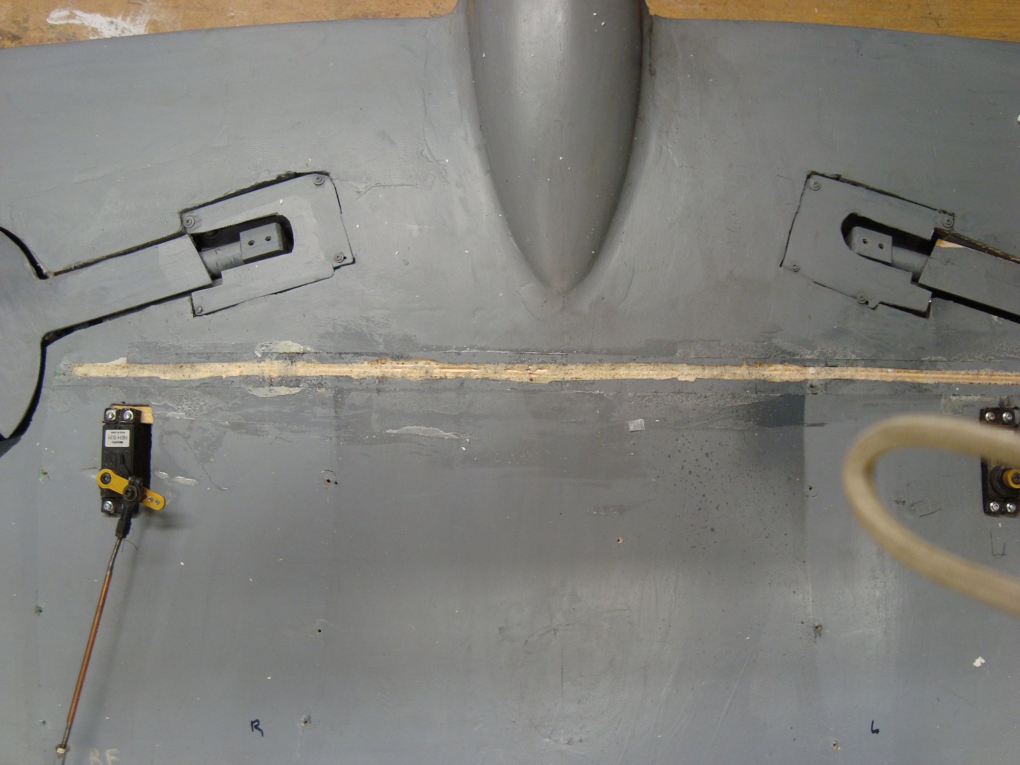

YA Spitfire flyers - need your help on this. This summer I noticed the wing skin "bubbling" or "pushing up" at the joint where the left wing panel meets the center section, the pics show it some. The bubbling starts 7" back from the LE and is 8" long and is about 1/8" to 3/16" wide.. I can feel a hint of flex ever so slightly when I hold down the center section and try lift the left wing panel up and down. The wing panel were glued to gether with 30 min. epoxy, finish is 3/4 oz glass goth with Zpoxy, painted with latex. I have not taked on the left "radiator" to see if they are any signs of flex movement on the wing skin on the bottom of the joint, before and aft of the radiator there is no sign of skin distortion. The right wing joint shows no issues.
I did use a strip of 2 oz glass cloth on the joints on the bottom - can't remember what I did tot he top of the joint.
I have also done the additional front plywood brace mod.
Your opinions please?
cheers - ken
Iam wondering is this flex is normal or am I headed to a left wing fold up sittuation. The model first flew in August 2012 si I estimate ~ 100 flight on it.
Has anyone else seen this skin distortion on a wing joint on their YA Sptifre wing?

I had a similar problem with my YA spit. I glassed etc the wing pretty much as you did. The sun would cause bubbling of the fiber glass. I tried to repair it but i fear it needs to be scrubbed and re-glassed.

Kenair, I think your dealing with a compression buckle of the upper skin. Several causes. First is that the dark olive drab in this location is likely getting hot in the sun which can soften epoxy glass to nearly half it's original strength (ballpark) Second the really small spar joiner in the aft portion of the wing which looks to be original YA stock design is giving way as they do. Look at how it stops near the front where the long spar was installed. I would wager that you have really pulled some high G's in warm weather or had a hard port wing tip strike that has contributed to the buckling.
I have seen YA wings constructed with the standard short spars completely fail after a few years use. It is a weak wing as designed. Yours has likely only survived because of your long spar installation at the front. It is just not enough over time to resist the fatigue of the balsa and foam.
An Idea, weigh the wing down on the top to pull the skin out at the joint, get an iron hot and try to flatten down the buckle, "Iron it out", the epoxy will soften when heated. Let it cool and then inject epoxy into the wing all along the location with needle and syringe.
Finally stop pulling so hard in those turns!!! I know it's fun, but it could be life or death for this Spitty.

Thank-you for your advice on the wing joint bubbles. I took off the rad scoops and glued in a 1/4" plywood dihederal brace (weighed 3 oz) , using polyurethane glue. I covered the brace with electrical tape, wax paper and flat weights for 36 hours, the polyu glue turned out good
. I'll fill it , sand it smooth and epoxy in a 2 or 4oz cloth strip over the brace and sand it smooth & paint.
