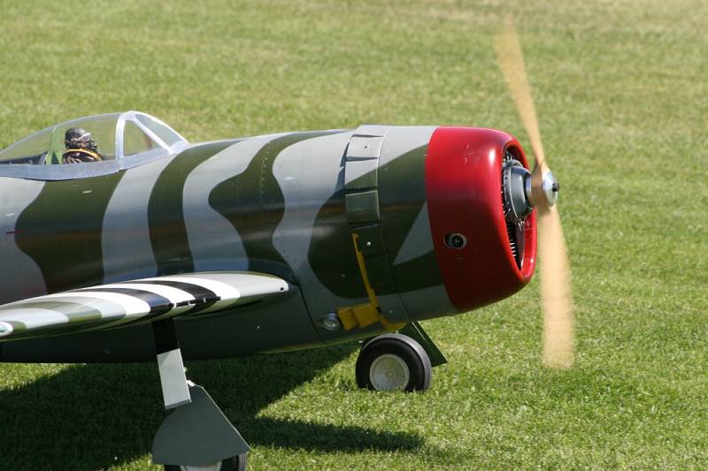

I've got 23 flights on my TF GS P-47 which I finished this spring. I got mine down to 18 pounds by lightening up the tail a whole bunch, and using a Moki 2.10. The P-47 really is an easy flying warbird...I love mine!

fit a DA-50, more power, smoother and has rear mounted carb so you do not need to cut the hole, or fit a 90 degreee throat to the G-62
Seriously though this model is way overpowered with the G-62, DA-50 size engines. Friend of mine flies a 1/4 scale P51 105" wingspan on a G62, I have a 42lb Vailly SeaFury @90" wingpsan so that gives you an idea of the amount of excess power you have with a G62 or a DA-50
FYI I'm fitting a DA-50 to mine.

You can cut about 1/4 inch off the stock carb isolator and get in in the cowl. There are steel inserts in the newer isolation blocks so you can't cut much more off. Or get the 90 carb bend from Toni Clark to keep the carb totally in the cowling.
