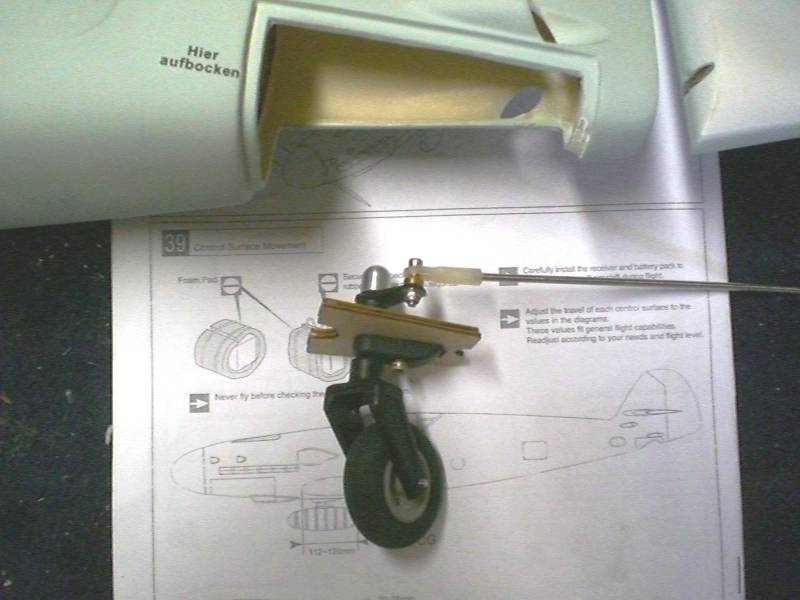

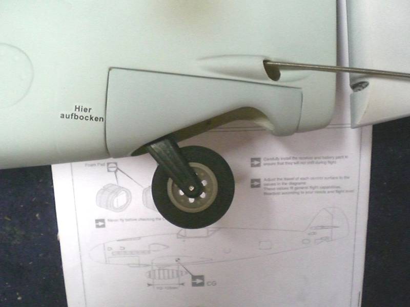

Here's my latest mod, the tailwheel. I used a 1.20 size wheel from Hobby King that cost $5.95. I had to cut the mounting arm and mounted it to the stock tailwheel mount. Here is a photo of the wheel and one with it in place (not yet glued in). I think it looks pretty scale, a good wheel for the price.

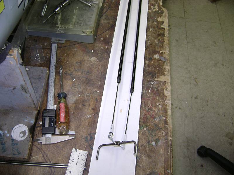

Hi
Just a note.
I began to link up my elevators with the CMP hardware. After a minor stress test on the CMP linkage to elevators, as i suspected with this type of connection, the configuration yields a lot of play.
The arrow shaft is very thin walled and not stiff, mine already split at one end.. Clevises already snapped as i tried to connect one to the horn. The "Y" connection is ok on short wire spans, but here for me, not good.
Do your own test and see if this is a real concern.
Imagine the loads with the large engines and a aprox 13-14lbs model.
I am going use a carbon rod to an internal linkage joining the 2 elevators, with the carbon rod pushing on center of the elevator load via an internal arm. No flex, no play.
Or i may use the CMP arrow shaft with a wood dowel that I can epoxy into it for additional stiffness making the hollow shaft solid instead of using up my carbon rods..
Steve

#333
RE: CMP BF109F BUILDING THREAD
What I did for the elevator halves was, I used the black arrow shafts provided in the kit as guide tubes and ran 4-40 rods(with their respective grey plastic guide tubes inside the black arrow shafts) to the control horns. I am using two servos, one per elevator half. There is no slop at all this way. The black arrow shaft tubes basically prevent the 4-40 rods from bending. So, what you do is get the correct length you want and cut the black tubes down some. Then, place the grey plastic guide tubes from the 4-40 package inside the black tubes and glue them. You then simply run the 4-40 rods through the grey guide tubes and all is well.
Here's the link where I bought the tailwheel. Awsome place to get motors, speed controls, and batteries. It is shipped straight from China though, so you need a big enough order to minimize the shipping. Check out the 1:6 scale pilots too, they actually look pretty good for the price. Same basic wheel is available from Dubro for $14.69 at Tower.
[link=http://www.hobbycity.com/hobbycity/store/uh_viewItem.asp?idProduct=4671&Product_Name=Tail_Wheel_System._w/_Steering_&_Spring_60-120_Size]Hobby King[/link]

I decided to put both cmp glass rods on the internal elevator control linkage. Basically like a pull pull system but with glass rods, so each rod splits the load with the other and also eliminate all play, yet will also work independent of the other in case one rod fails . No exposed linkage. Both rods connect to the same metal gear heavy duty servo.
Steve

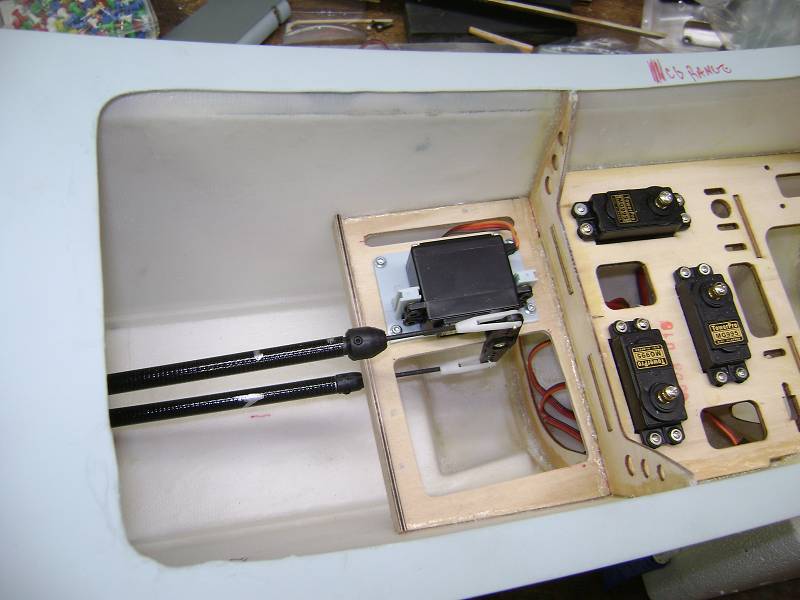

Steve,
Some questions if you don't mind.
1. How do the control horns attach to the wheel collars mounted on the rod that connects the 2 elevator surfaces together?
2. Are both horns attached to the same wheel collar, or are there 2 collars?
3. Why have you cut the fuselage apart at the lower back, and removed the post?
4. Do you plan a retract mechanism for the tailwheel?
5. How did you get the connecting rod past the inboard hinges without cutting the hinges?

Hi Bob
Hope all is well.
1) The wheel collars are the cmp ones threaded for a 8-32 pan head screw, thread locked with a plastic clevis connector on it. If you have a questions on this part, let me know and I'll post a pic of the part.
2) two collars attached on opposing ground in flat spots on the piano wire rod.
3) CMP has put a nice radius on the rudder, I am going to take advantage of that by setting a new rudder post inward a bit and create the faired look as the elevators/ailerons have . And the rudder will fit better to the vstab top part.
4)No functioning tail wheel on this one, next one maybe. Most scale 109 locked tail wheels down.
5) Eliminated inboard hinge. The elevator control rod works as the inboard hinge. The CMP hinges will fail before this control rod ever fails.
Oh, I decided to wrap kevlar thread around the ends of the glass arrow shafts to reinforce the ends a bit so they don't split. Don't have to use kevlar, glass tape would work as well.

The servo end of the elevator linkage.
CA glue can bond to polyester resin well, but I integrated the ply to the factory wood and may put a bead of silicone to hold it in place if it does come loose somehow it will give me some control..
So am i adding weight, yes, but I am going to link all my flaps to one metal servo and save..
Too many servo behind the CG, not good.

Hi Bob. No problem. please don't hesitate with questions or suggestions.
I know what you mean about time. I have a wife, kids and I'm not retired. But we all need to diffuse in one way or another.
Important note on elevator control modification i did.
If anyone decides to do the hidden elevator control like I've shown, the bolts in the collects that control the elevator wire should be at 1 o'clock and 5 o"clock positions (angled forward away from the rudder post) so when they are pushed back the screws don't hit the rudder post and limit the elevator throws.

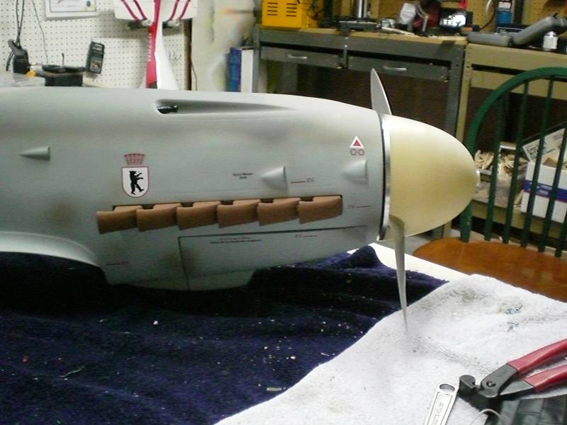

I have to give you guys credit for pushing the scale envelope to the extent that you mount a scale type retractable tail wheel in this plane. With the long tail any weight back there will likely make a need for some nose weight. I'm doing a few things here and there, but the not so large wing on this fairly large plane is keeping me in check a bit.
I got my Sierra retracts last night, and they look great! I can't wait to get them mounted and see how they look. Thanks Darrel!
I also got the OS 1.60 mounted. As mentioned earlier, the aluminum backed spinner I got from Dave Platt is a little smaller than the cowl, but I don't think it looks too bad mounted up. Here is a photo. I'm still working on the spinner nut, so the cone is just stuck on.
