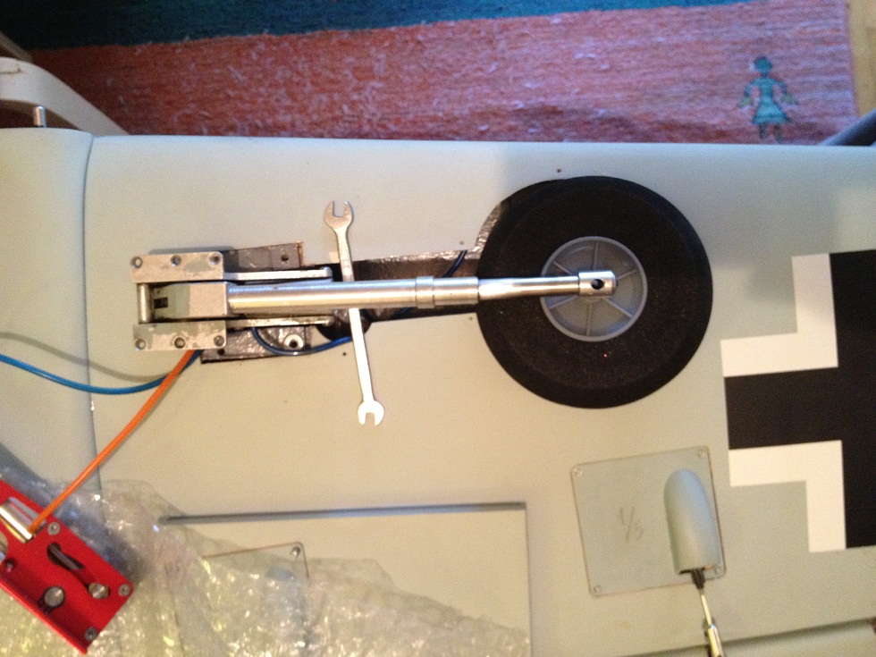

I installed a DLE 20 which fits rather well in the spacious nose.
I also replaced the 90-degree retracts with 80-degree borrowed from an ESM Bf-109 E, wheel wells will be enlarged to fit 100 mm wheels.

After the successful maiden working on scale stuff, starting with wheel doors made from 0.5 mm aluminum and balsa inner frames
ID:	1868068   Click image for larger version

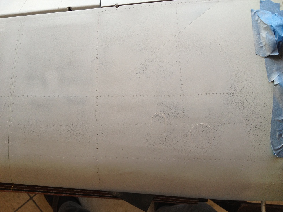

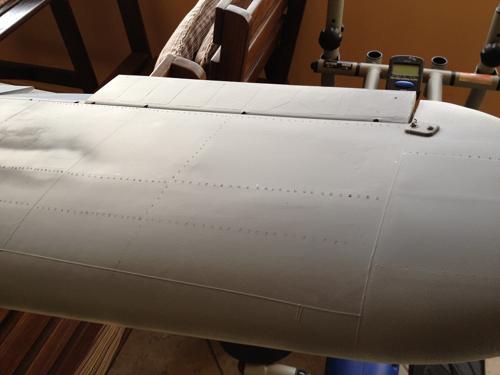

Default RE: CMP BF109F BUILDING THREAD
Panel lines made with 0.8 mm Chartpak tape and rivets on the wings
ID:	1868070   Click image for larger version

The other feature that kills the scale look of this plane are those awful looking servo covers, they were replaced by standard ply covers.
The flap servo horns were placed in the wing, a bit hard to install but looking neat:
