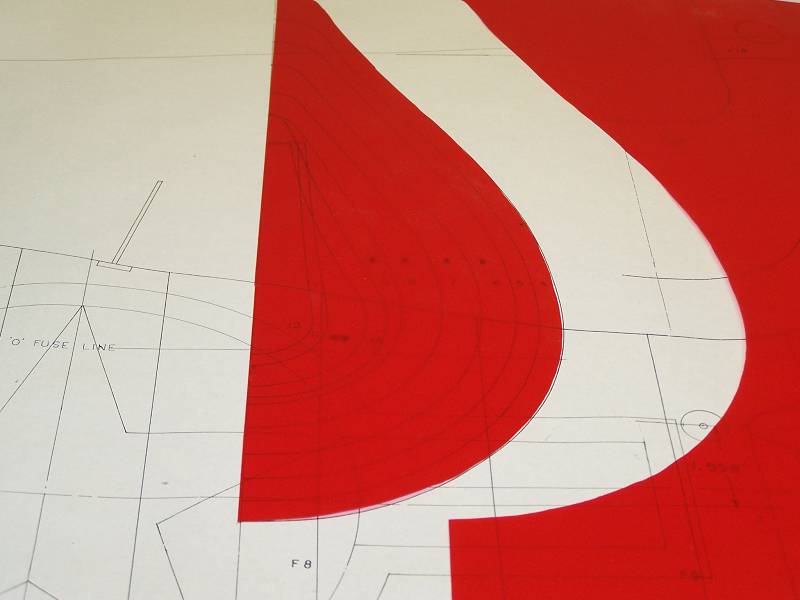

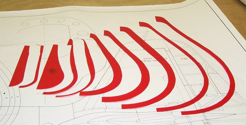

Making templates for the bulkheads using See-Temp. This is great stuff. Just lay it on the plans and score it with an x-acto knife then bend it on the score line a few times to break it. Makes a nice clean edge for laying out on the ply.

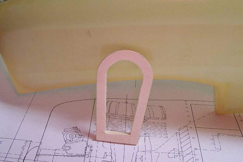

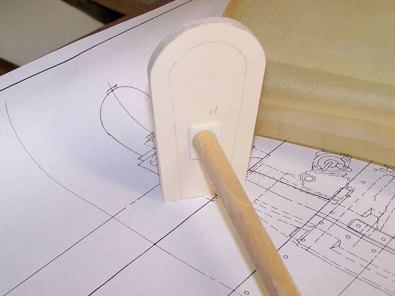

I cut out the rear most bulkhead from 1/4 inch ply and marked its position on the fuse.
Since I don't have Gorilla arms. I stuck the bulkhead to a dowel with double sticky foam.
One thing I'm finding is that the drawing isn't really accurate with the inside shape of the fuse. Any ideas on filling in the gaps on the sides other than cutting a new bulkhead oversized and trial fitting it?

You might consider polyurethane glue. It expands to fill gaps and will adhere to almost any surface. You would need to clean the expoxy surface well before using it.

Thanks Jeb. I think I will install the formers with Hysol and then go back after it cures and hit the gaps with Gorilla Glue as long as they won't attack each other. The down side would be the added weight as I'm trying to keep the tail as light as possible.

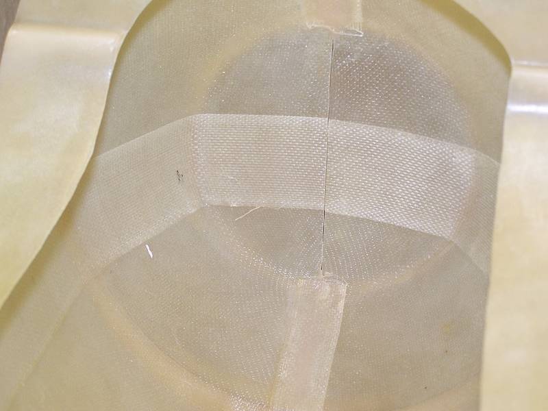

Ok experienced glass fuselage builders. I could use some advise on glueing the firewall in (shown in post 9).
Do I: smear epoxy on the front of the firewall and just clamp it on?
lay it in there dry and put a bead of epoxy and glass or CF cloth around it?
Need some ideas please.

As for attach the firewall
I put epoxy on the front of the firewall
then cloth around the edges
dont worry about the weight you will need it in the nose

I dont know if its still available but I love this stuffGreat planes was selling milled fiberglass in a small pointed container , I added it to all my high stess needs when glueiing and it works perfactly for adding strength and filler to expozy .
Its cheap , you simply stir your expozy , shake the desired fibers in place and mix again .
It does shorten the cure time of your glue and it will thicken up more then just glue , hope this helps with your gaps .

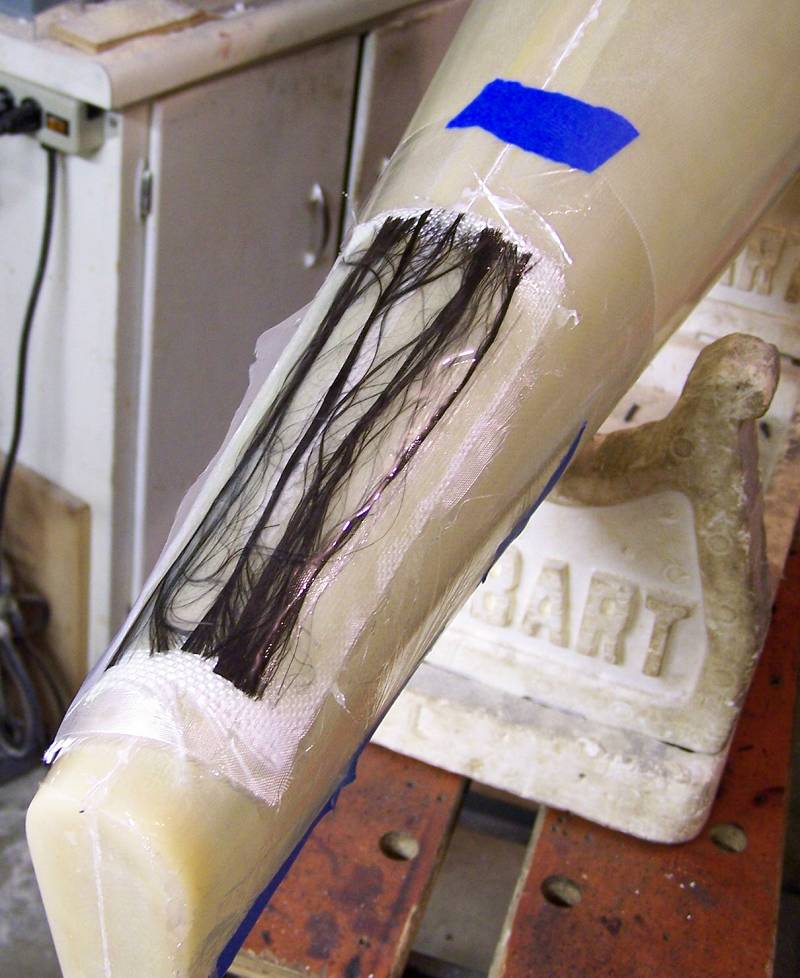

I got the firewall glued in using both Hellcat56 and LDM's suggestions. I mixed up some 30 min epoxy with microballoons, smeared some on the front, put it in place and poured the rest around the perimeter. Seems to have worked well.
I was going to try my hand at making an access hatch tonight but realized I didn't have any glass heavier than 3/4 oz so, I'll have to wait until I can get by the hobby shop.

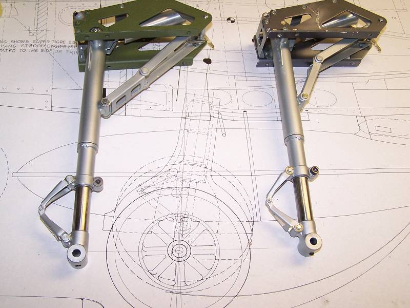

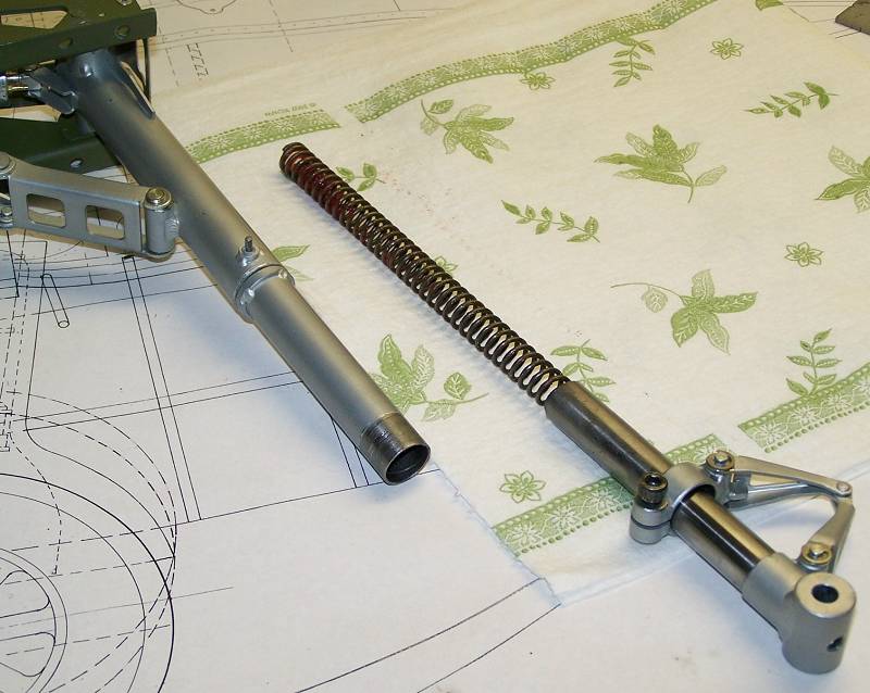

In the mean time, I decided to modify the retracts. I picked up a set of Robarts from Hogrider that were made for a Ziroli Hellcat. These turned out to be 1-1/2" too long per the plans so I shorted them by first removing the scissors, then cutting 1-1/2 inches off of the rotating tube. Robart tells me that when you do this you need to also shorten the spring by an equal emount. There was a wooden plug in the upper strut so, I just removed 1-1/2" from that. Then re-assembled them and they are the perfect length now.

Tonight I made my fist attempt at making a tail gear door. I covered the area with cling wrap and layed down some 30 min epoxy, put down some 2 oz glass, carbon fiber and 3/4 oz glass. It appears it is going to come out lumpy from the CF so, I'll probably need to make another try at it.
ID:	1039849   Click image for larger version

I'm planning on trying another tail wheel door tonight. I'll go with 2 layers of heavy cloth and 1 layer of 3/4 oz cloth. Question: should I go with the 30 min. epoxy I used before or some finishing resin? Regular viscosity or thinned?
Thanks for the help!
