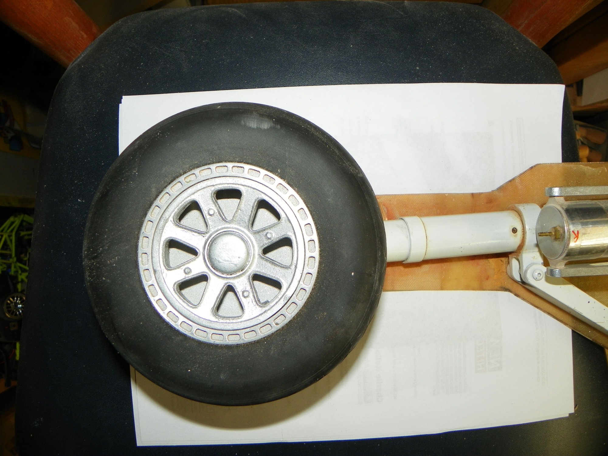

Use of G10 Material over the retract installation area. Chic

Hey guys, those of you using Sierra Landing Gear, how did you secure the cast Hub Caps to the Sierra Wheels? Thanks. Chic

Chic, the (potential) advantage of using two-ply of G10 to make strut covers is that it is easy to lay them on top of one another, apply pressure so they match the contour, and then wick some thin CA to get them to stick together.
As you apply pressure and make them conform to the contour, the two pieces of G10 will slide past (or against) one another, and the CA will "lock" them into this new orientation... effectively "locking in" the molded shape.
Lots faster using this method, as opposed to laying up glass or carbon cloth.
You might give it a try! Worst case scenario... you have three sets of strut covers that look like ^&$%!!!
Last, I never used smoothie hub caps.... just used the spoked machined aluminum hubs. Should be visible in many of the old pictures. So, not sure how you attach those pups!

Noah, you are talking about using the really thin sheets G10 - RIGHT? I'll show you the hub caps I got to go with the Sierra gear. Give me a minute. Chic

The hub cap is made from a very lite weight material???????? Just need to figure out how to secure it. Chic

Yes! Very thin... G10 at 0.010 inches in thickness is what I used.... a single sheet will bend easily. When forming two sheets over a bend (contour), they will slide against one another... you can then "lock" the bend into place by wicking thin CA between the sheets as you hold them against the contour/surface of the wing.
They should hold the shape when glue sets. After initial shape is established, remove the piece and keep flooding it with thin CA (at the seam between the two sheets, so that CA runs in between the two sheets. Then spray "kicker" and they should eventually be permanently held together while the whole of the larger part retains the shape of the contour.
My wheels were machined from a solid billet of aluminum such that the wheel hubs themselves were spoked.... never had a "cap" that mimicked the spoked wheel. Hmmmmm. I might suggest two or three drops of thick CA, spaced 120 degrees from the other drops (if using 3), so that there are limited number of "hold points" keeping the cap attached to the hub. That way, if you need access to the axle to remove the wheel, you can just "pop" off the cap (break the CA bond) without destroying the cap (and without badly marring the hub).
