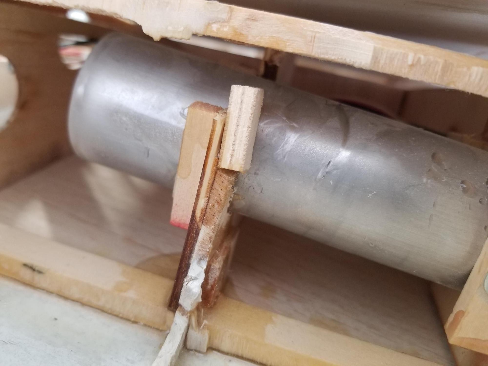

Hey guys,
Work progresses slowly on the wing, found that the inner most rib that holds the wing tube broke loose, got the 2nd rib re-glued and am slowly getting the outer rib glued back into place, going to be a mild 110 here today so NO work on the wing
Larry

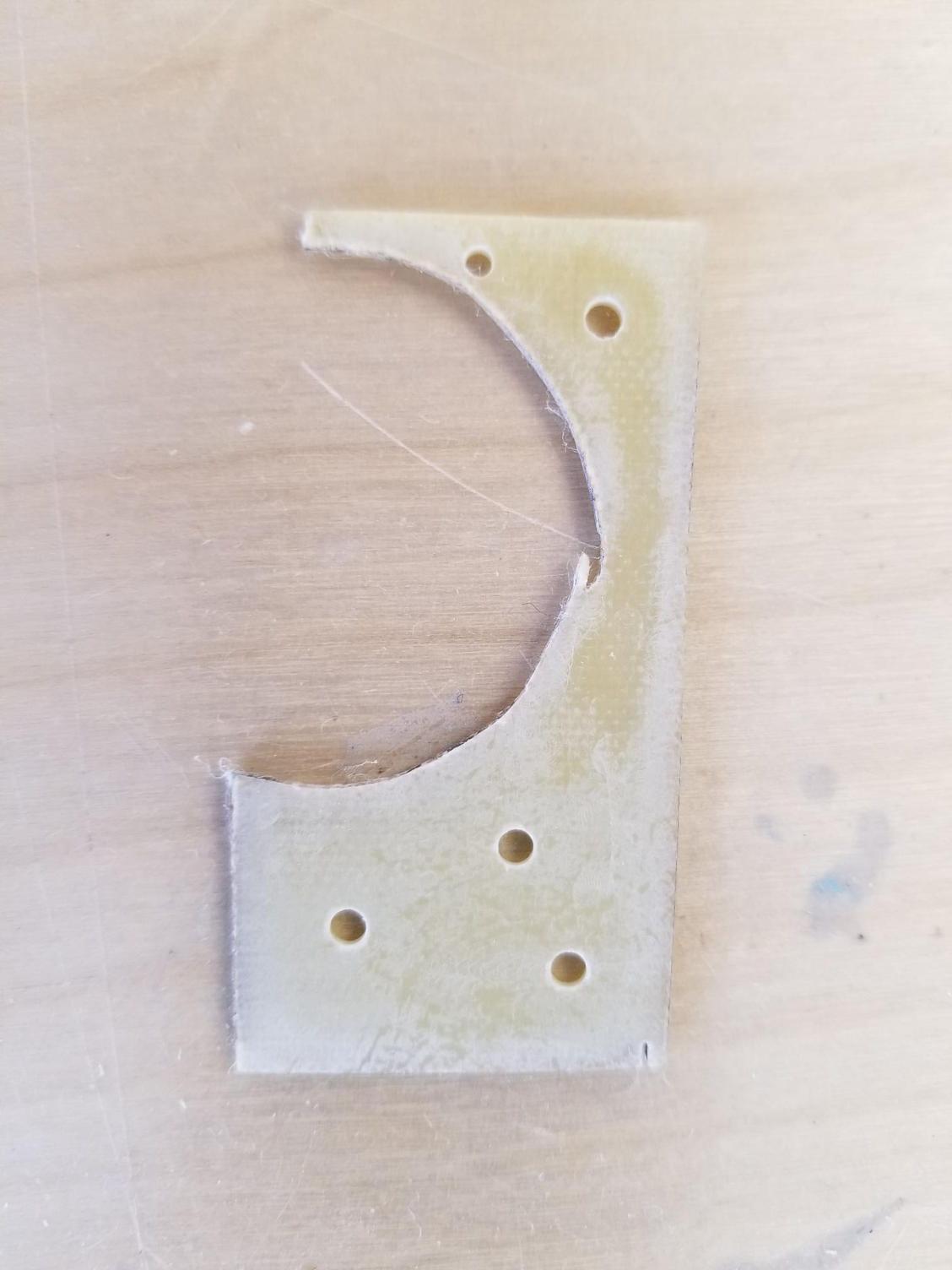

My Feedback
Chic,
I try NOT to go outside once the temp hits 105+
Here are a couple of shots of the G10 repair I'm working on, I will make a 2nd one for the 2nd wing tube rib.

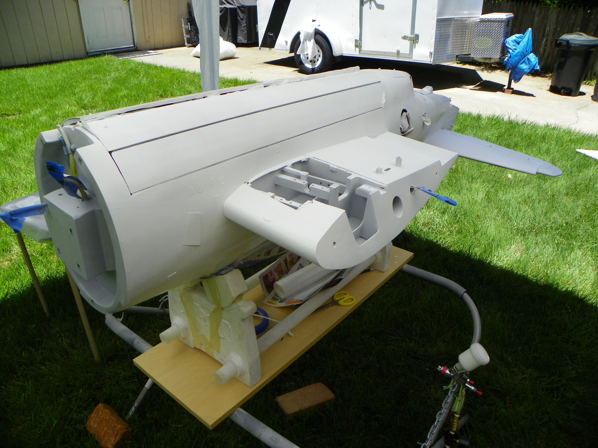

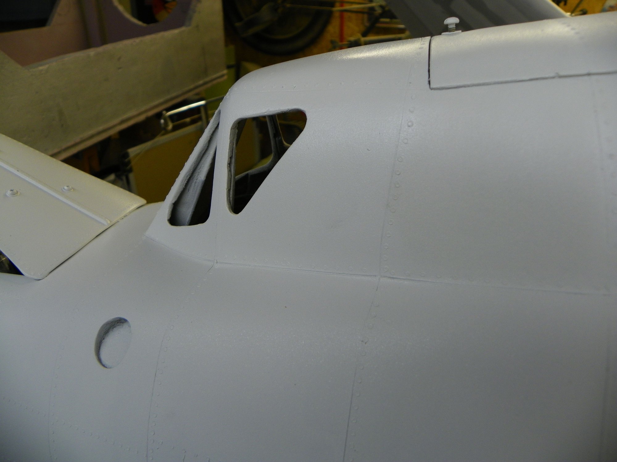

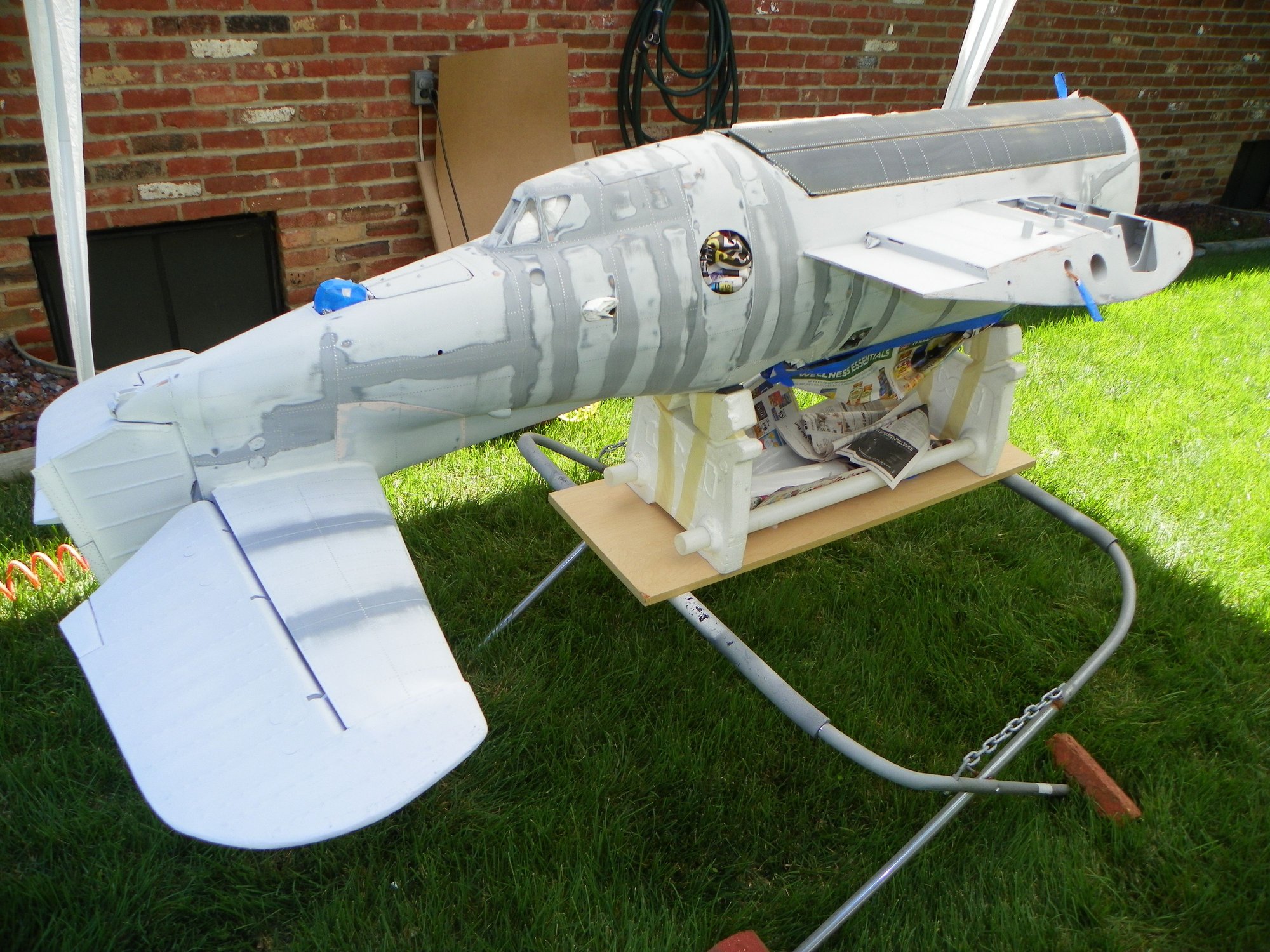

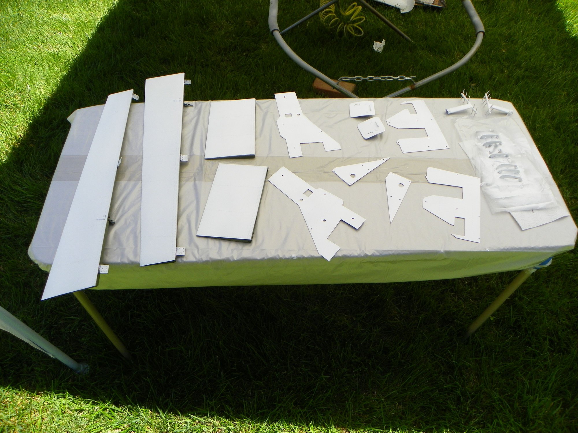

OK, OK, OK. Got the fuse bottom and sides painted "White" this afternoon. The bottom of the "Wings" will be painted "White" tomorrow morning. At Last. Chic

Photos

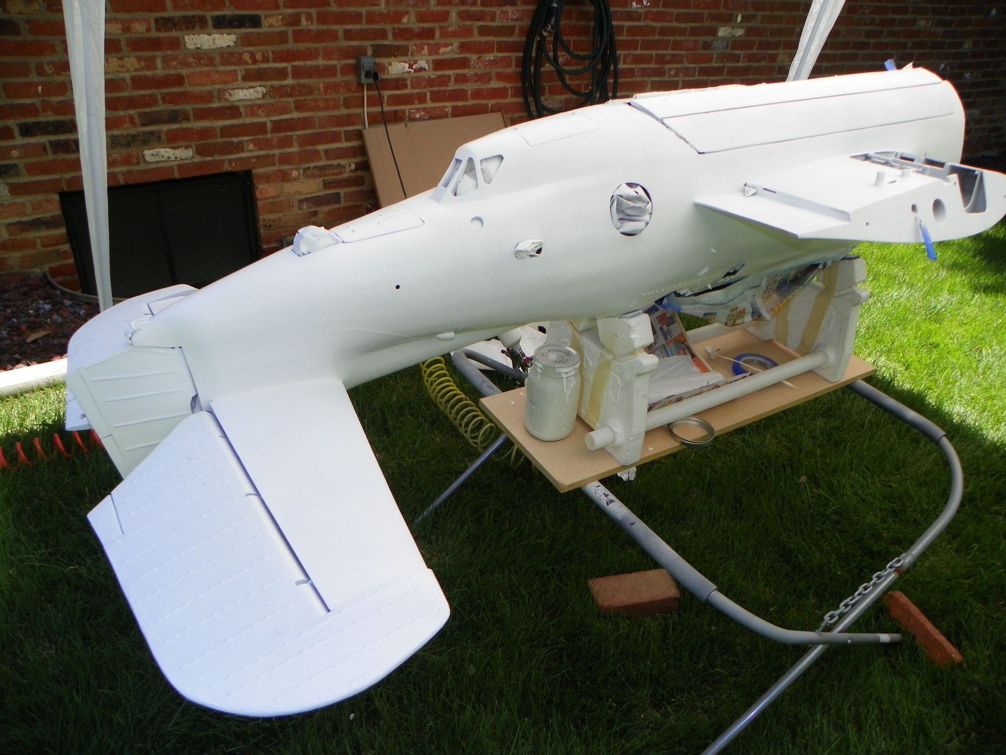

Old 06-15-2018, 09:12 AM

Photos.

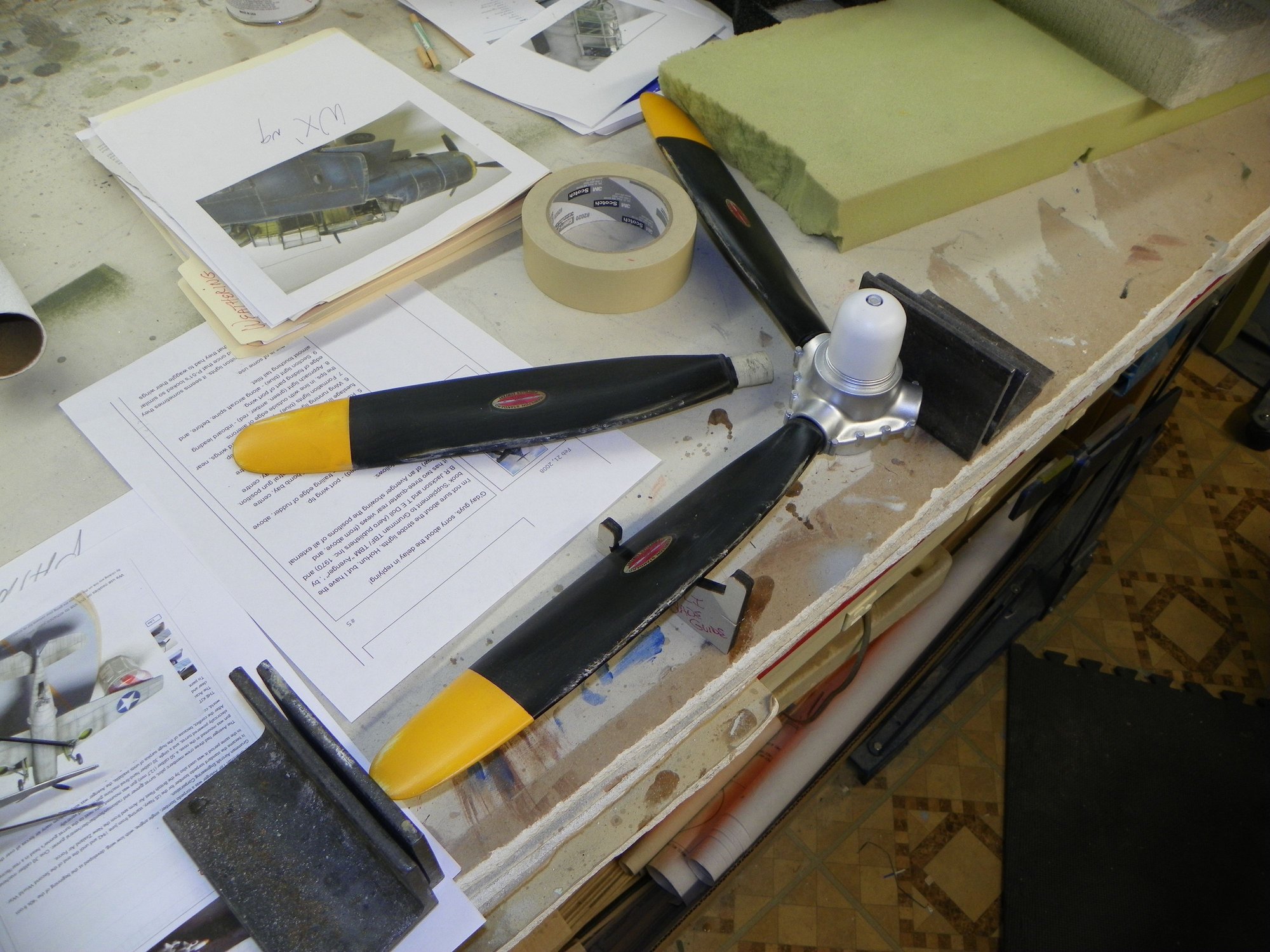

Old 06-15-2018, 09:13 AM

Having fun building the Ziroli Static Display Prop. Thanks to article Model Airplane News. Chic

Bottom of the wings are now all white. Let it all sit for a few days to dry and harden and then application of the wing/stab/elevator camo. Long time coming. Happy Father's Day to all the Avenger watchers and builders. Chic

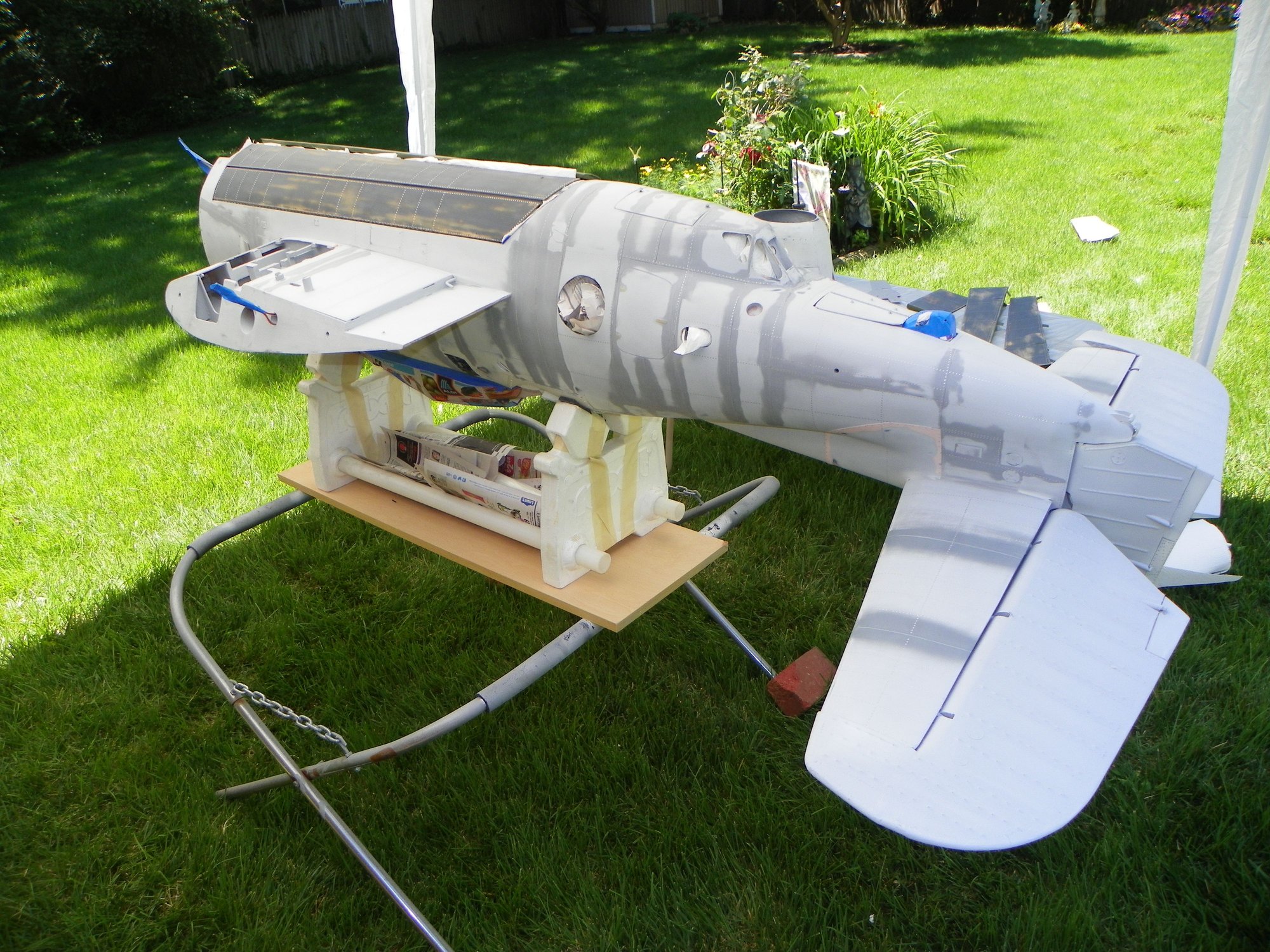

Thanks Bob and Noah. However, Guys. I seriously need some weathering advice. This Avenger is so "WHITE" - that I have to wear sunglasses when I am in the shop. It needs to be dirtied up really bad. Any suggestions on a dirty wash or something I can apply. Like a drop of black in 10 drops of thinner and sprayed on?????????? Help guys. This would apply to the fuse and bottom of the wings and stab/elevators. Chic

Chic,
consider artists chalk, black or dark grey, ground into powder. get a rag and blot it in the powder, then use the rag to wipe the wings and fuse from front to back, leading edge to training edge... some of the "grime" should accumulate in the recesses and the panel lines/gaps.
If not satisfied, wipe away with damp cloth. If satisfied, cover with clear coat! Locks it into place.
you might want to experiment first on a panel.
full disclosure... I have never tried it, but I saw the results of this technique on several planes over the years... and they looked great.
the alternative is to airbrush on streaks of grey.. and hope it looks great the first time!

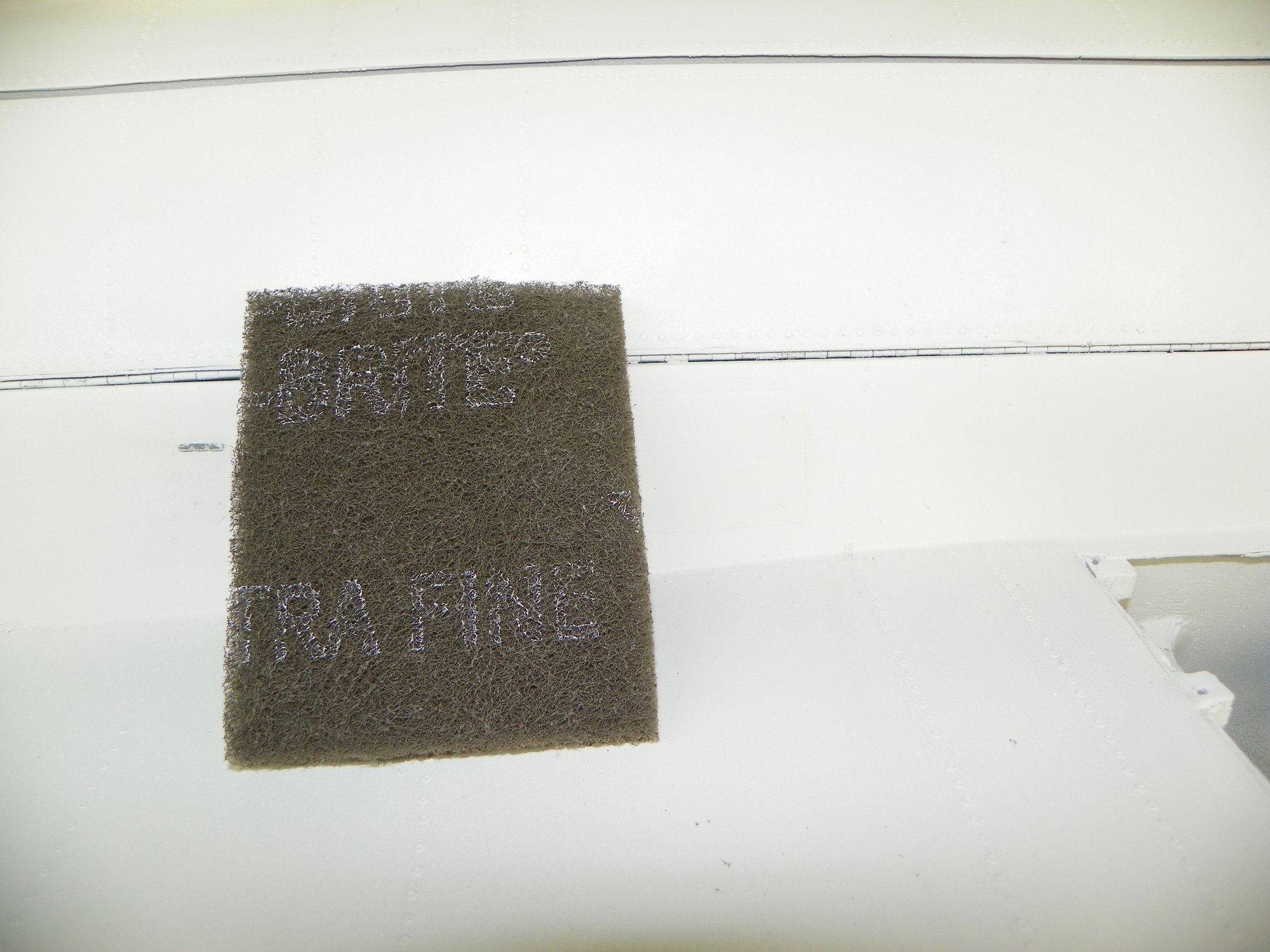

Thanks Noah, will use the inside of the landing gear doors to play with the chalk/powder technique. Will certainly use the airbrush to spray steaks on the bottom of the wings and fuse. However, my main concern is with the sides of the fuse/fin/rudder. I have seen on Ytube where a wash is sort of sprayed on the top of the fuse and let dribble down the sides with a bit of a wipe in the end. Hummmmm?????
So far, I have taken a fine Scotch Brite pad and scuffed everything to get the sheen off the paint even though I used a Satin catalyst. Chic
