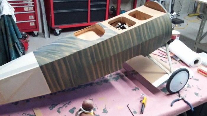

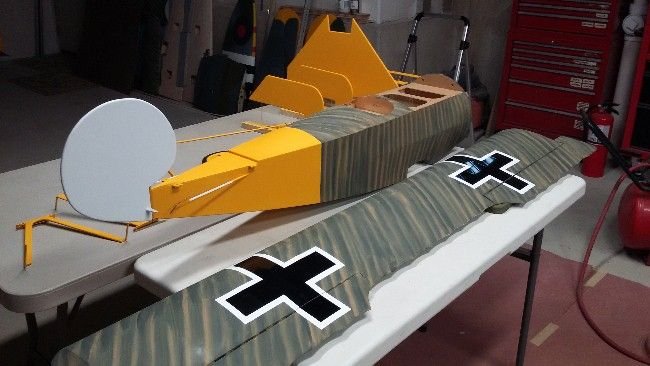

It's been 9 years, 2 new knees, a divorce, a marriage, moved 3 times, sold 2 houses, had a house built, 2 new churches, 2 new jobs, but I still have the same Fokker DR-1 airplane project! "I am living a dream!"
Time in the shop yesterday. Worked on a 1/4th scale German Fokker DR-1 Triplane. It is time to paint. I have chosen to do the paint scheme of Rudolph Klimke, a lesser known ace who survived the war with 17 victories. I have asked around with my modeling community on how to do a dry brushed streaked camouflage. Nobody could help me. So I had to create my own technique. I practiced on cardboard painting latex with a light tan color (sandgelb) and while it is still wet I put lines of Olive Green (olivgrun) over the top. Then I take a dry brush and drag it through the paint to spread it out and go for the effect. The results are ugly which is fantastic. Sometimes ugly is beautiful. Leo

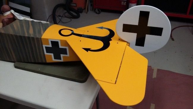

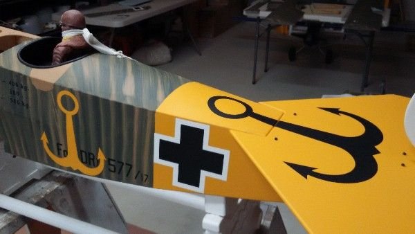

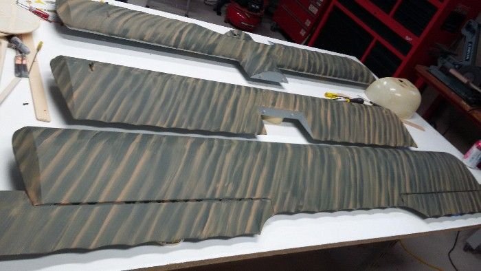

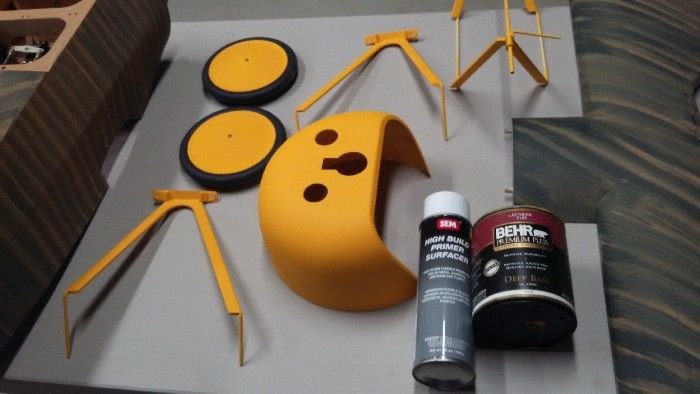

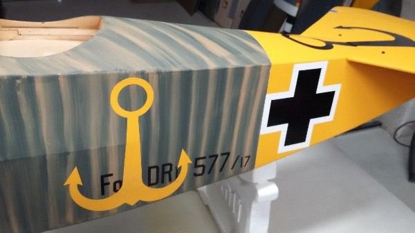

Shot some yellow this week on the Fokker DR-1 parts. It is a German color called GELB RLM04. I spray latex thinned about 15% with window washer fluid through an automotive gun. I put a SEM white primer under the yellow to make the color pop as yellows typically have very bad pigment cover. Such a nice finish. The next challenge I have is to make some graphics that are this yellow color. I plan to try scuffing some white vinyl and painting the sheet with the yellow latex. Then I am going to put it on the graphics cutter and see if it will cut the painted vinyl? If it does, then I will have a whole new method of decorating an airplane with color correct flat graphics that are stuck on versus painted on. We will see. Leo

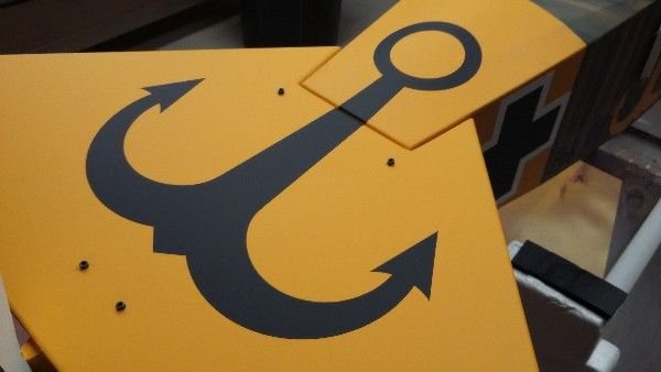

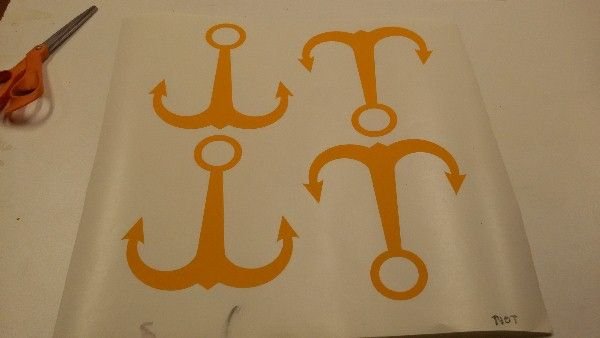

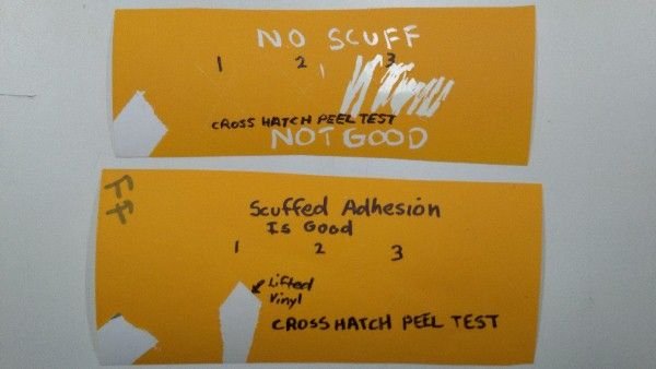

Cutting my own graphics now. I bought a Graphtech 2000 which cuts nicely off ACAD files that I draw up. It is going quite well. They are shiny at the moment, but I will be spraying them with an over-coat of dead-flat clear Acrylic when I am done. I love the contrasting colors! The Anchor is a good luck charm that Rudolph Klimke put on his airplane to please his mom. It must have worked because he survived the war. Leo

I cut latex painted vinyl today. A scuff of the vinyl is required to get good adhesion. Matching the vinyl to the top coat color is advised versus white so that you don't see the edge. Klimke applied the Anchor mid-WWI so it went over the top of the DR.1 serial number. Leo

Finally a top coat of Modern Masters Dead Flat Clear Acrylic sprayed through an automotive gun. Thinned about 15% with window washer fluid. All shine taken away from the graphics!! Everything blends in beautifully. They look painted on which is what I want. Klimke is armed with 2 Vickers, he means business! Now on to final assembly! Leo

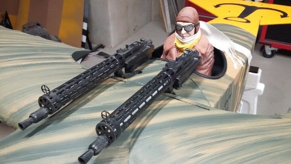

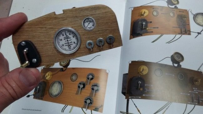

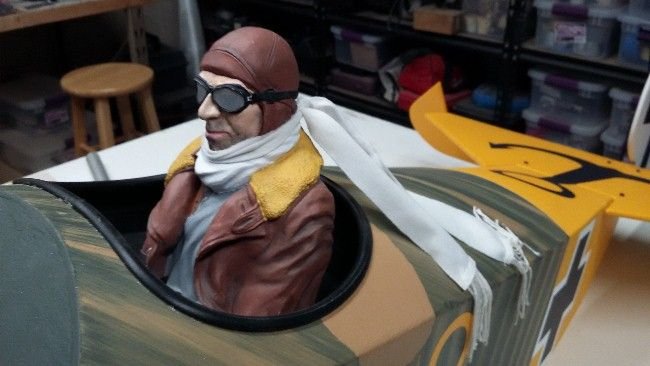

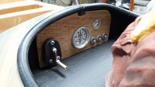

I figured Klimke better have a few instruments in his office to fly this bird. Referencing a Fokker book I have it looks like one big dial in the middle is typical. So with some plywood, stain, washers, T-pins, AL Tubing, and about 2 hours he now has what he needs. Look at the smile on his face! The goal is not exact replication but rather to create the right theme, emotion, and illusion. Artistic license allows me to do whatever I want. Leo
