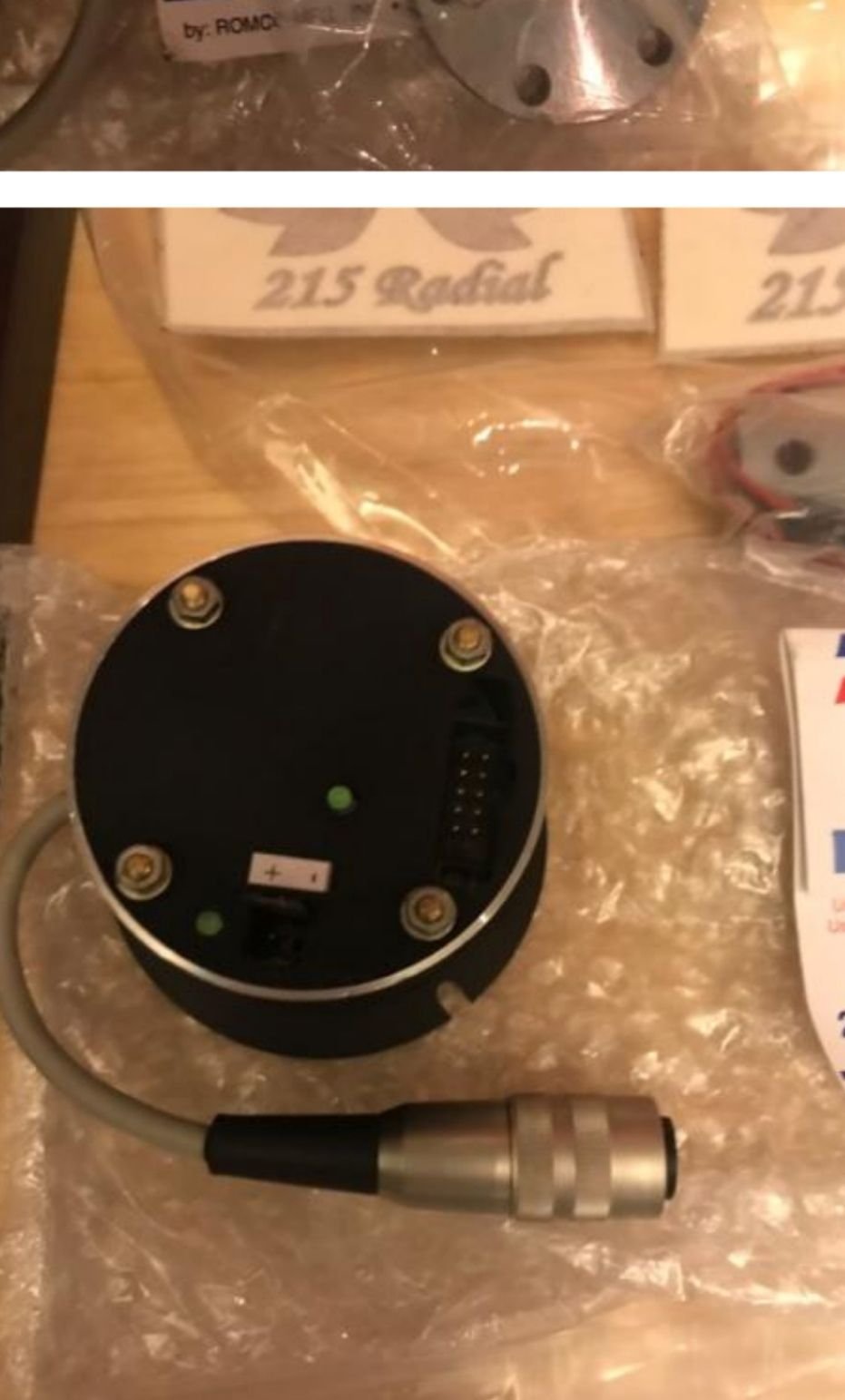

I’m not going to beat up on Moki, but here is the unvarnished truth:
I purchased a new Moki 180 with blue ignition. Operated it per instructions, using the exact recommended lubricants, mixture, fuel pump, power, cooling, etc. I should add this is my second Moki – my first was a used 250 with the older Top Hat ignition. I never had any trouble with that engine.
My new 180 quickly experienced two ignition failures, back to back. Both failures were the HV Coil to cylinder #4 simply no longer firing. Both failures were covered under warranty, but were accompanied by all the usual testing, swapping of components, removing, shipping, reinstalling the engine, only to have to go through it all again a second time.
The second time it happened, I was told “I must be the unluckiest Moki owner on Earth, as having the same failures back-to-back was so unusual.”
After the second failure, rather than only replacing the bad coil, Moki replaced the entire coil pack. Since that time, the engine has run great for probably 10 flights (knocking on wood, fingers crossed….)
The good? All costs were covered by Moki under warranty.
The bad? TONS of my time troubleshooting, removing, packing, shipping, (having my Moki engine box torn up in shipping), re-installing, and doing it all a second time. NOT what I expected when I purchased a brand new engine.
ALL the Moki’s still use the original design coil packs buried inside the rear portion of the case. IMHO, I don’t consider this a good design, BUT the vast majority of Moki’s run fine for years, as did my first 250, so what do I know..?
The Blue Ignition allows the use of 2S Lithium batteries and has an ignition ‘arming’ feature, but I haven’t noticed any difference in the way the engine performs over the old Top Hat.
IF my ignition fails again, I will switch to an external electronic ignition, similar to the RainbowTronics.

We are 2 pilots in Norway that had the same problem with the 180. Both new engines, started but didn`t fire on all 5 cyl. Both back to Airworld, came back again and still the same issue. Airworld just denied there was further problems.
Disassembled the whole ignition and went to Adrian at www.ch-ignitions.com and then it just worked very well ever since!

We have same problems with defect coils on MOKI radials in France, even on brand new engines.......
and the After Sales -no- Service is terrific .........
To solve definitely problem with the black grease coming into the tube between the front of the engines and the WALBRO
WT carburetor ( and kill the pressure/depressure fuel pump....) I have upgraded engine with RCEXL electric fuel pump
and a upgraded carburetor with back fuel line to the tank. Follow my Facebook webpage " Modelisme Micromoteurs Service"
