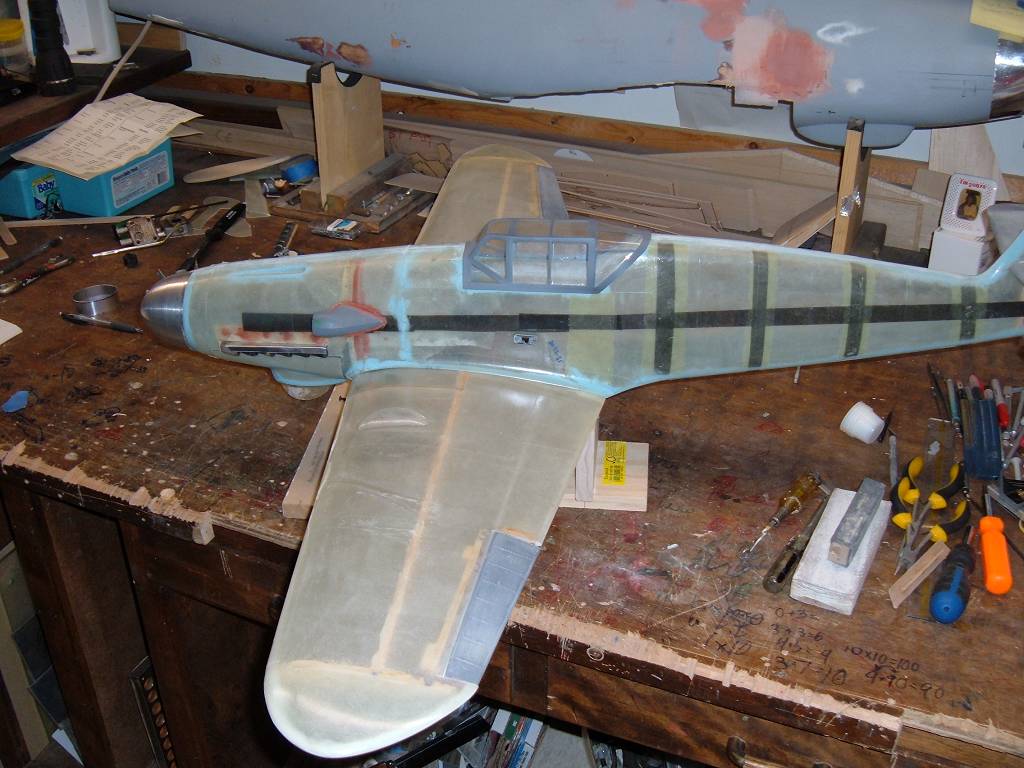

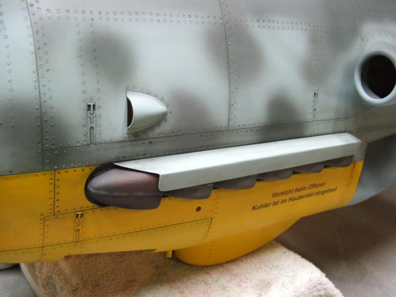

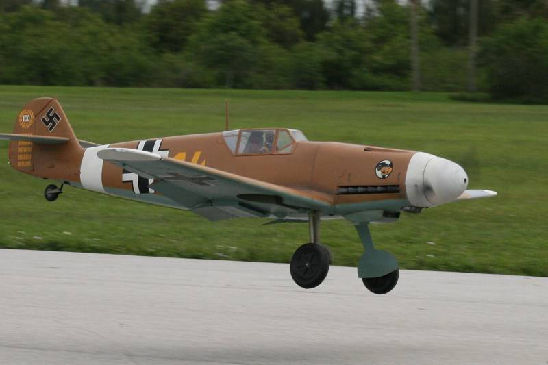

    Ok...
    so I'm quite excited about building Jose's 80" ME 109F "Fritz". At this point I'm still alittle undecided on the scheme that I will finally choose, but I'll show the few that I've narrowed it down too, and perhaps with all of you're help, I can make a choice.
    here are a few shots of Jose's 109...
    Hope you'll all follow along, and all of you 109 guys...don't hesitate to jump in with any and all of those tips you've learned...
    Casey

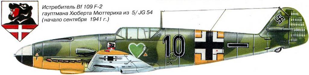

    Here are a few of the schemes that I've been thinking of doing...I live in the northern California Valley and I'm surrounded by mountains, so I want to choose something that will show well in flight here...dunno yet.
    Casey

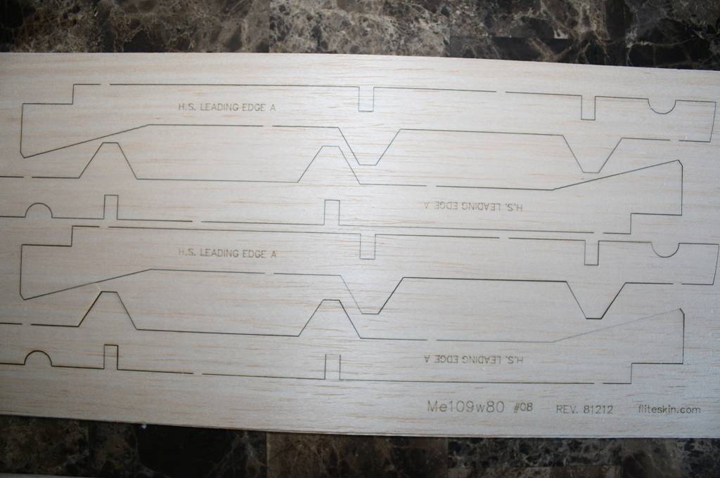

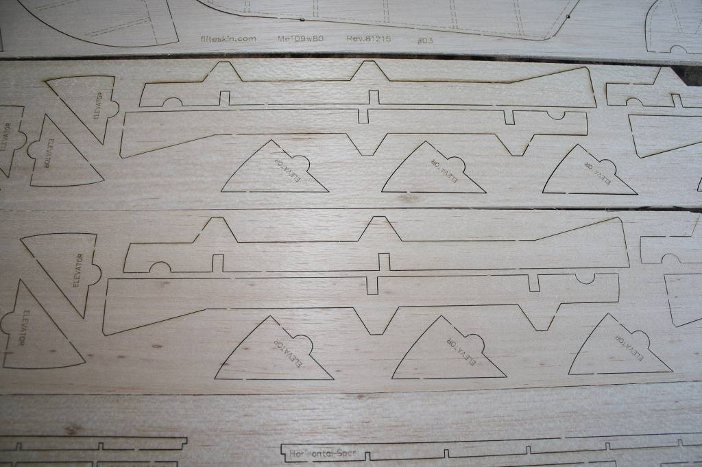

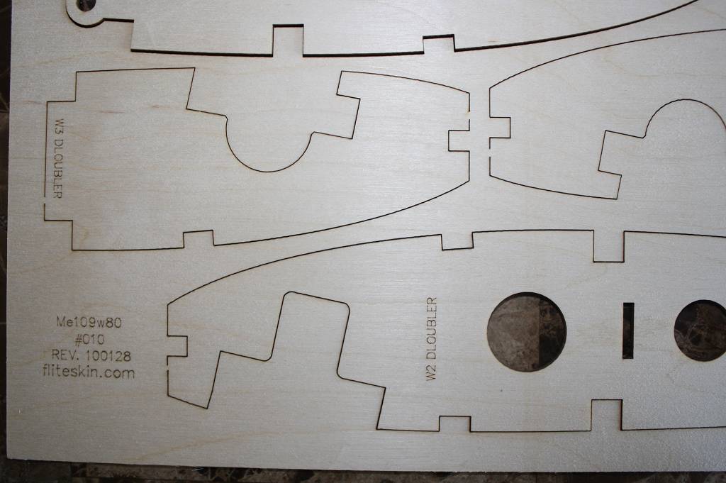

    Recieved my first box a couple days ago.(all laser cut pieces for wing&tail, spinner, exhaust stacks, cowl latches, canopy) Everything packed nicely...everything looks nice!
    Casey

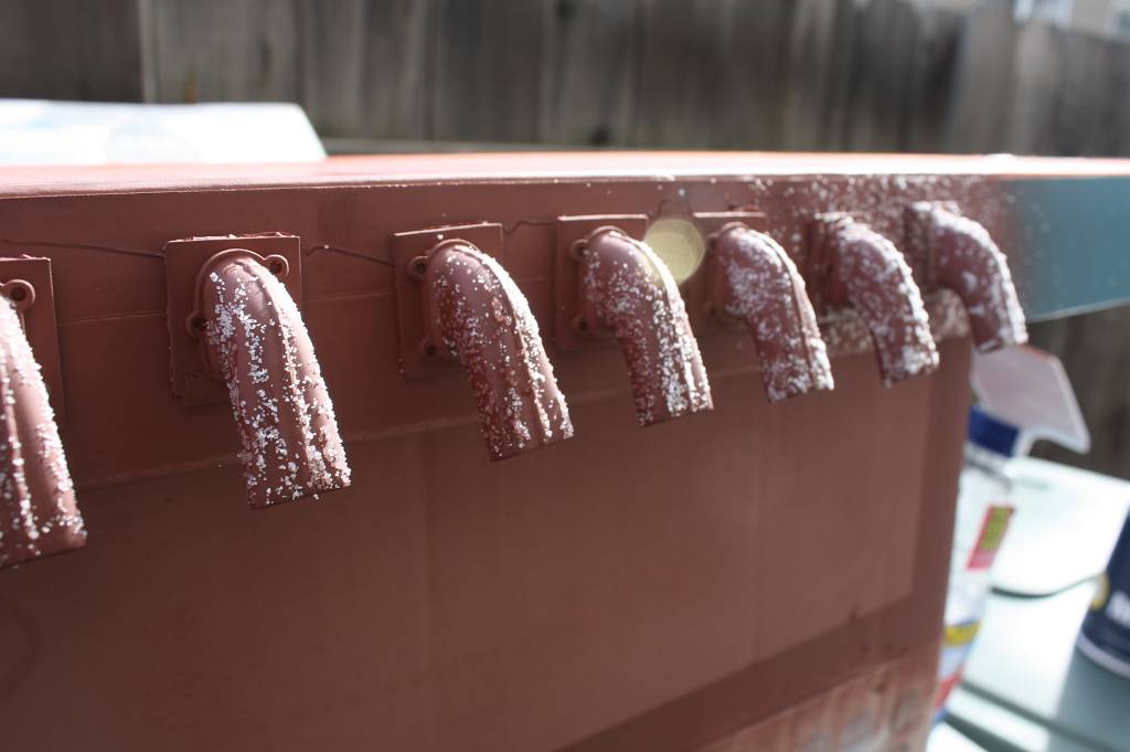

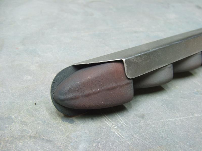

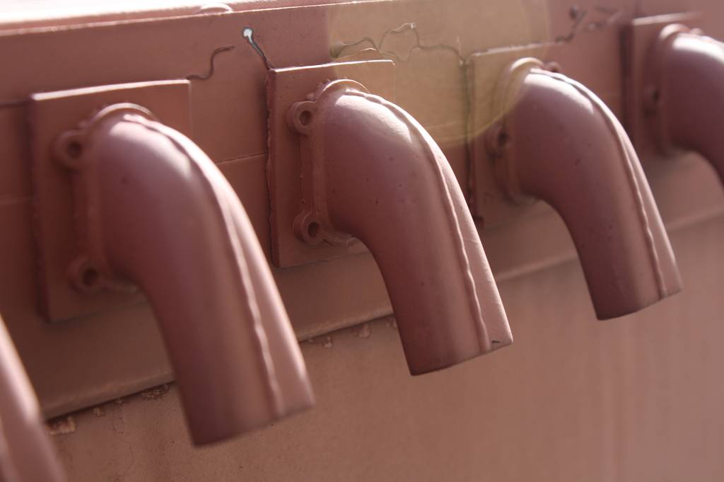

    couldn't wait to start something so I cleaned up all of my resin parts and went to work on the exhaust stacks. I used a method of "salting" the piece in between coats of paint to achive the look of rusting. I don't think it turned out too bad...
    I first used red oxide primer, then used a fine paint brush to wet the stacks, grabbed a pinch of salt and let 'er fly. This gave me a rather random covering of salt on the stacks.
    Next was a light coat of flat black....
    Casey

    I actually started by using Testors flat black inside the stacks....

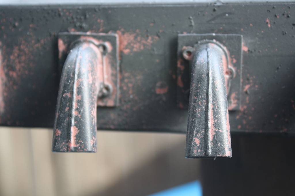

    then after waiting as long as I could stand, I used and old tooth brush to rub off all of the salt....
    all in all, it turned out rather random, lighter in some area's, heavy in others. But for the most part, I'm happy with it.

    I must say, those stacks look increadible....so good I had to redo mine thanks .....
    I wasn't happy at all with how mine looked after seeing yours, my colors were not right and way too much black...so I repainted with testors "rust" and I'll try again with the salt today....how did you get such a nice stipple pattern?
    Casey
    I know its all in how i lay in the salt.....
