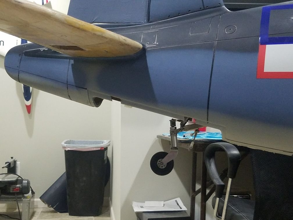

I used a Hangar 9 canopy, shape is good for the ESM corsair :

But less thick than the ESM (0.53 mm for the ESM, 0,43mm for the hangar 9)

WOW Fred ! That's a super duper looking canopy!! I have a H9 canopy on hand for my Corsair, and I want it to look just like yours. Can you please tell me how you made that ?
I suppose the aft part is litho-plate (?), and what size are the screws ?
Thanks, V.

Vasek,
Detail of canopy making here:
ESM 50cc Corsair
First step is to cut the H9 canopy at the good place to have in one hand the windshield and in the other hand the sliding part.
Then I have done a template with paper to have the outline of the frames.
For the windshield, I have rolled the sheet ( 0.5mm aluminium sheet),stretching it at the base of the windshield to fit it good with the fuselage (stretching with a hammer and a forming tool),
I have adjusted it to the fuselage until it fit well with the original H9 sliding canopy.
And after, I have cutted out the parts to be removed, and do the holes for screw.
For the inner skin, I rolled an other sheet, and I have traced the cuts to make from the first parts.
The same process was used for the sliding canopy, but I had rolled the pieces after they had been cutted out. Sliding canopy is made with four parts ( 2 for the inner skin, 2 for the outer skin).
The Screw are M 1.4 ones. No litho plates, just a lot of working hours,
Another advice: buy a big sheet, because maybe you'll have to redo the same parts two or three times... ;-)

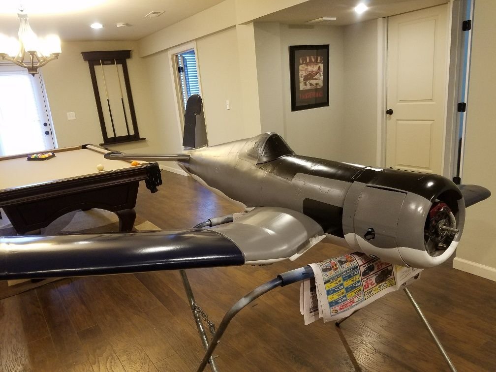

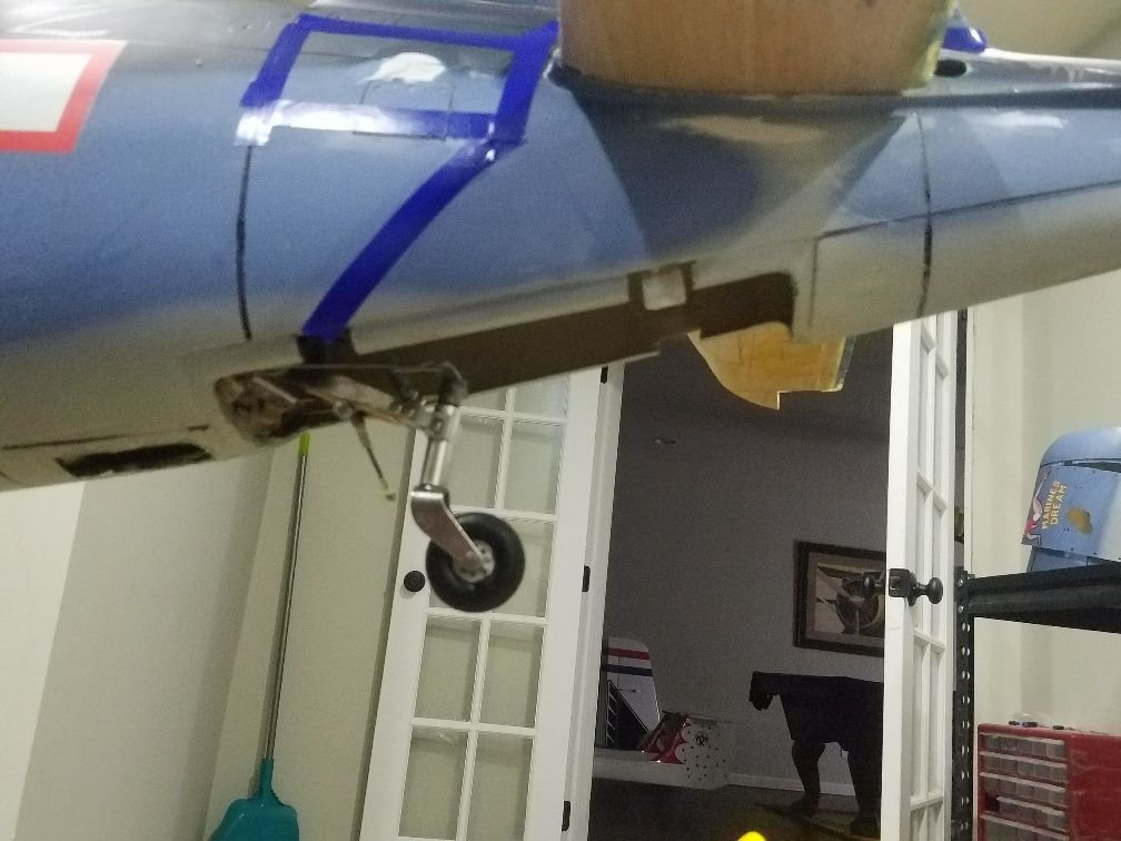

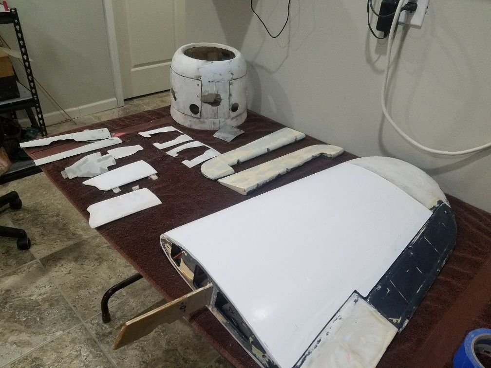

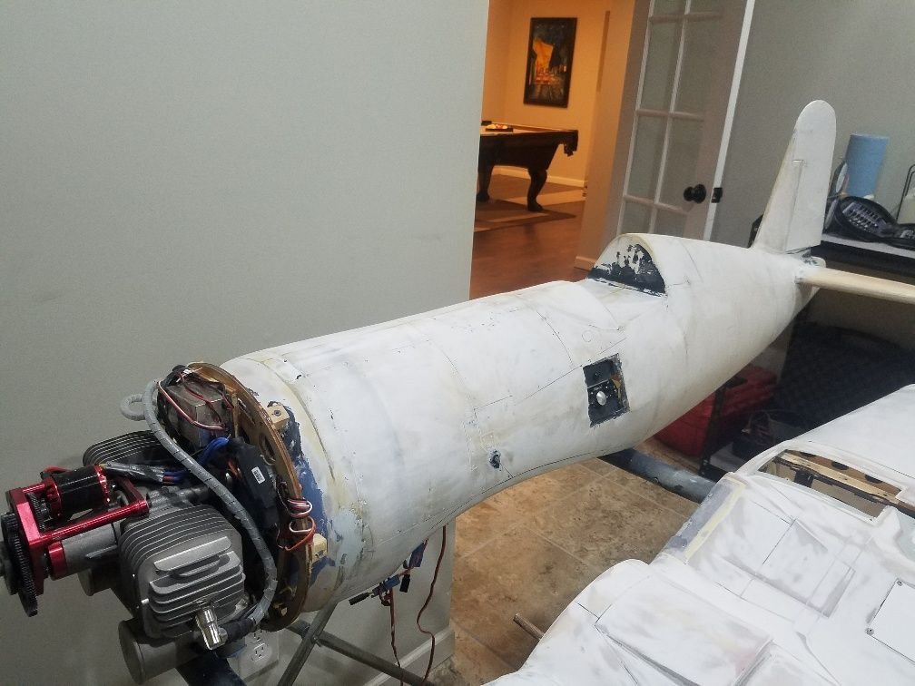

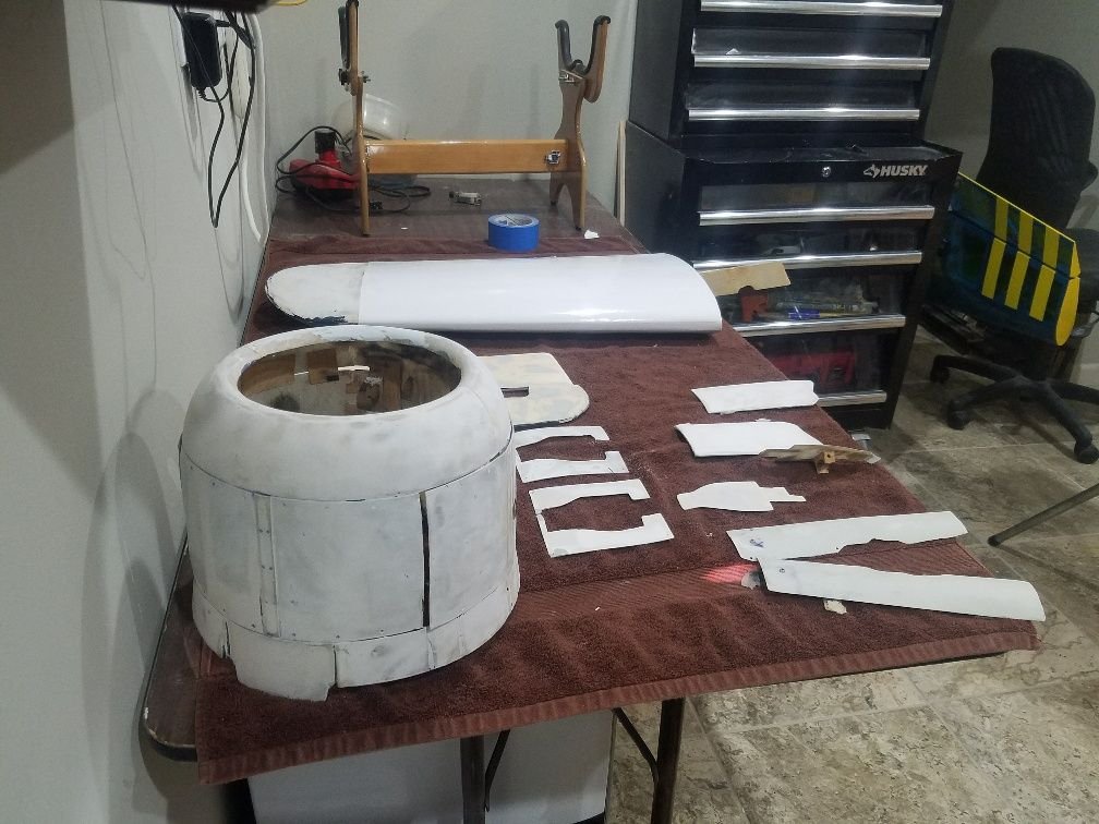

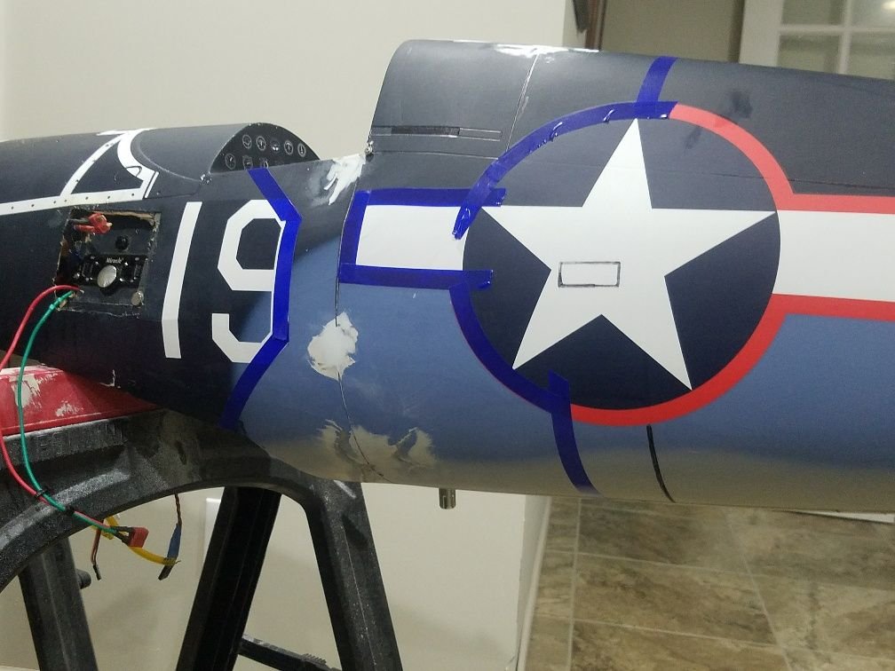

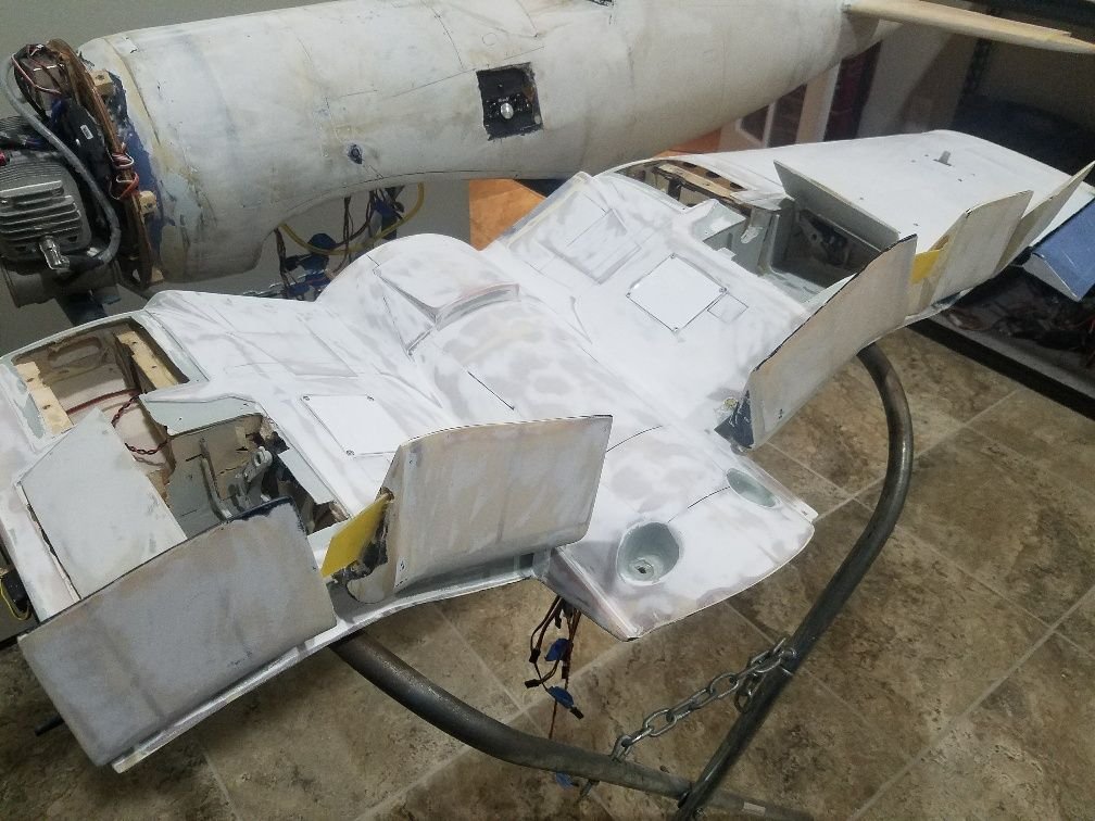

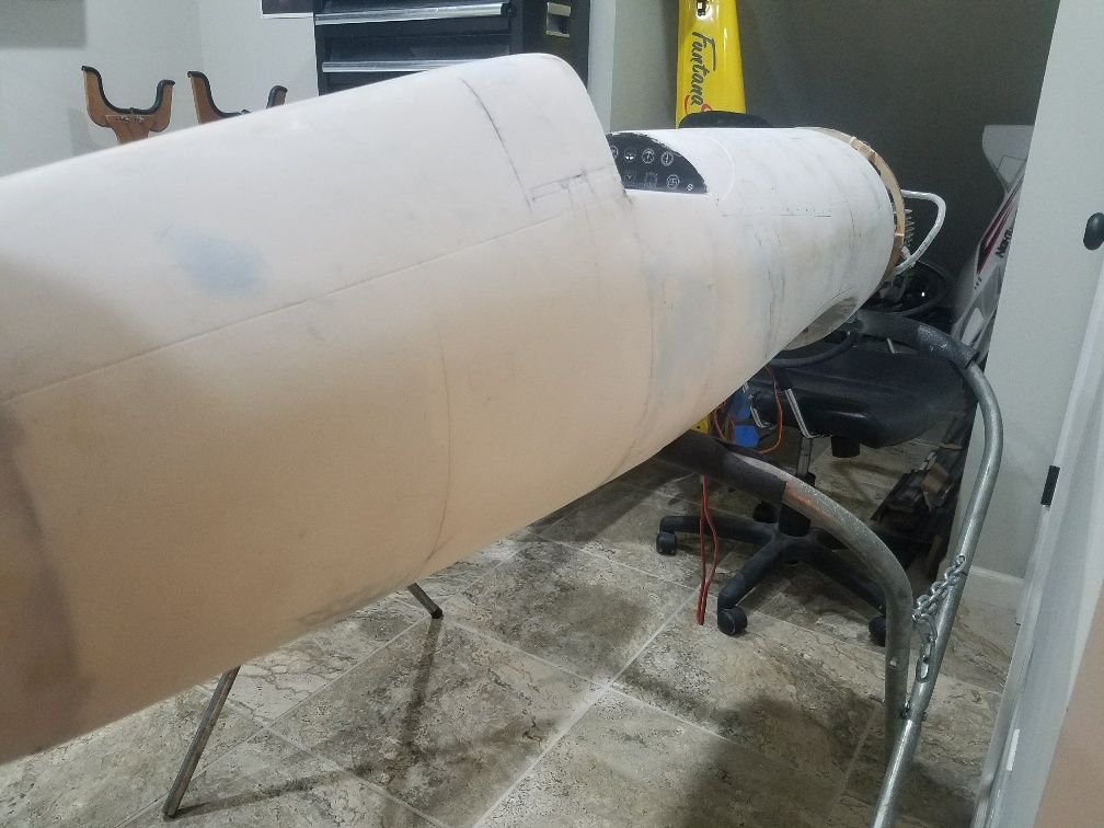

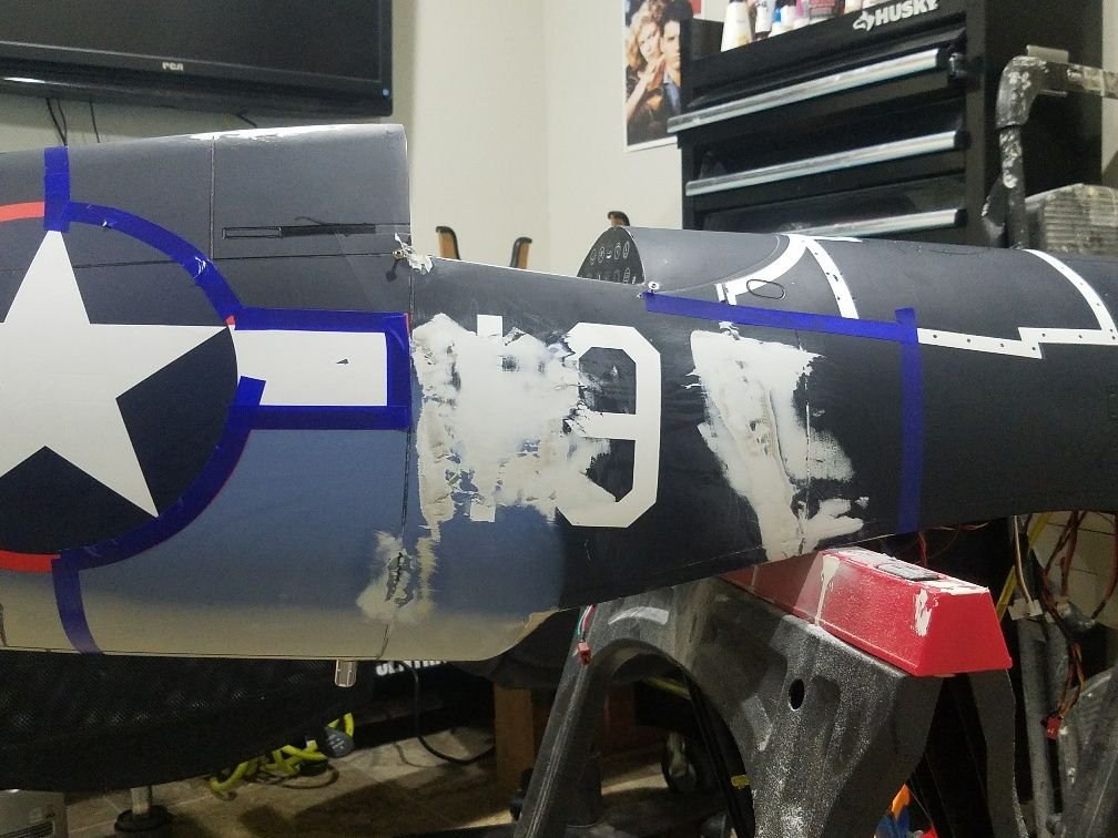

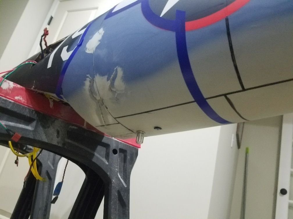

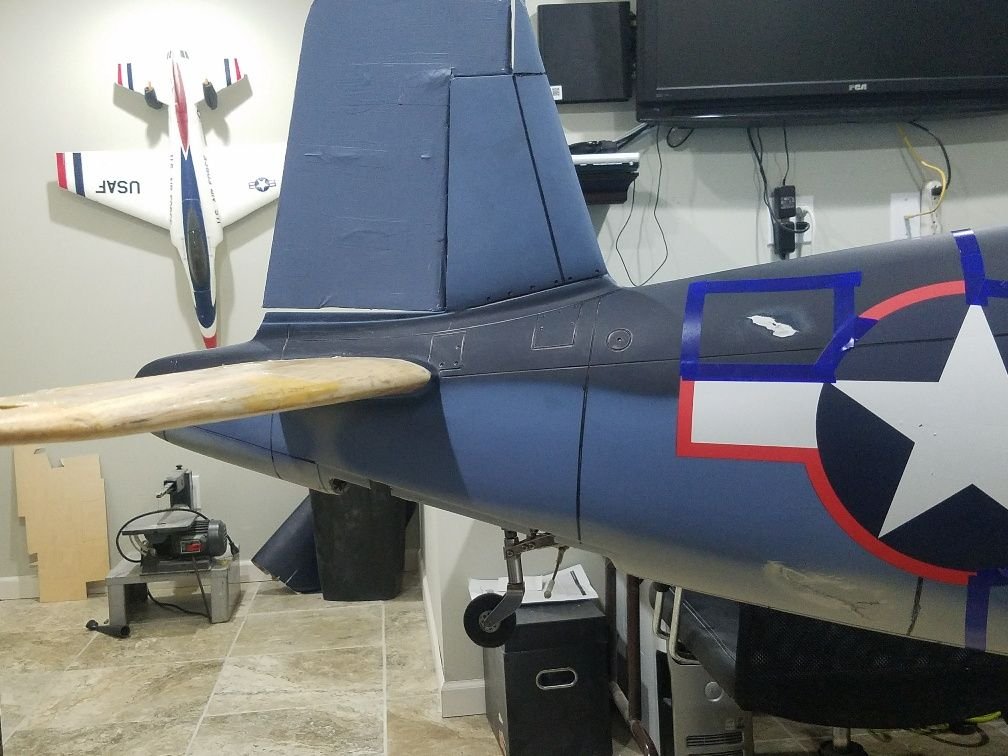

Repainted after crash and updated
part 1
part 2

Old 03-16-2018, 02:07 PM
  #2659
fred.
fred.'s Avatar
Join Date: Jan 2016
Location: Normandy
Posts: 22
Gallery
My Gallery
Models
My Models
Ratings
My Feedback
Good repair work!
Give us the information when the plane will be back in the air !
fred. is online now

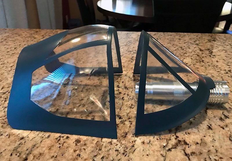

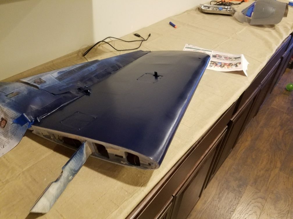

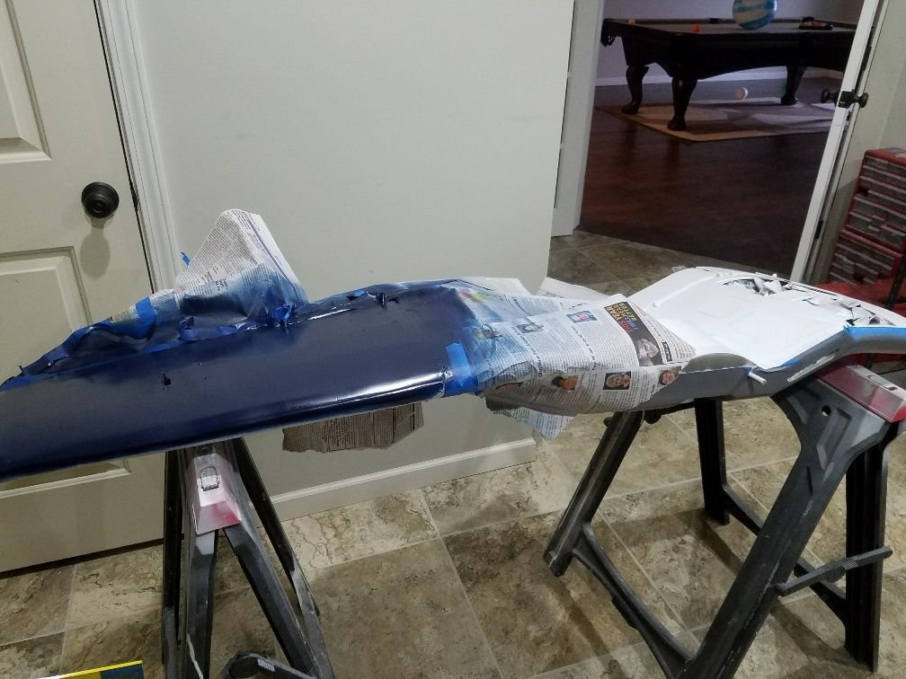

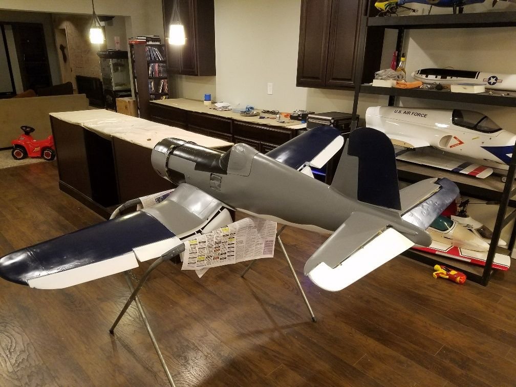

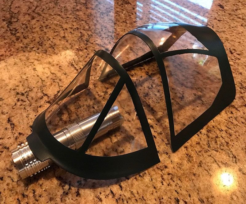

Upgrade canopy from VQ painted Tamiya Navy Blue.
Excellent repairs!
Painted the upgrade canopy Tamiya Navy Blue. Turned out pretty good. Need to add rivets and additional scale details (rear view mirrors, etc) but I might just be able to roll with this canopy.

Hi Fred, looks and sounds great! When do you plan to brave the skies with her? Such great work on the cockpit/canopy! Can I ask how you mounted your strut covers? Good luck on the maiden!

Old 02-22-2019, 08:07 AM

Yeah, beautiful work Fred. It's been a long time coming. Hope you have a great maiden! Love to see video. Haven't really seen many of these kits in the air.

Old 02-22-2019, 09:38 AM

Nice work, Fred! Beautiful airplane.
Just a note...and you may already know this, but that engine WILL overheat without some sort of baffling to reduce the amount of air entering the cowl versus the amount exiting it. As pictured, your cowling will fill with air in flight that cannot escape fast enough to cool the engine. The rule of thumb for engine cowl ventilation is that the exit area should be 2-3 times the size of the entrance area. The best (scale) solution for this is to install a faux radial engine with cutouts to control the intake airflow.
Only offering this unsolicited advice because I have been there with a P-47 build a few years ago. Couldn't figure out why my wide-open FG-33 was overheating, then added the faux radial and the problem was solved. Pic attached. Best of luck with the maiden!
