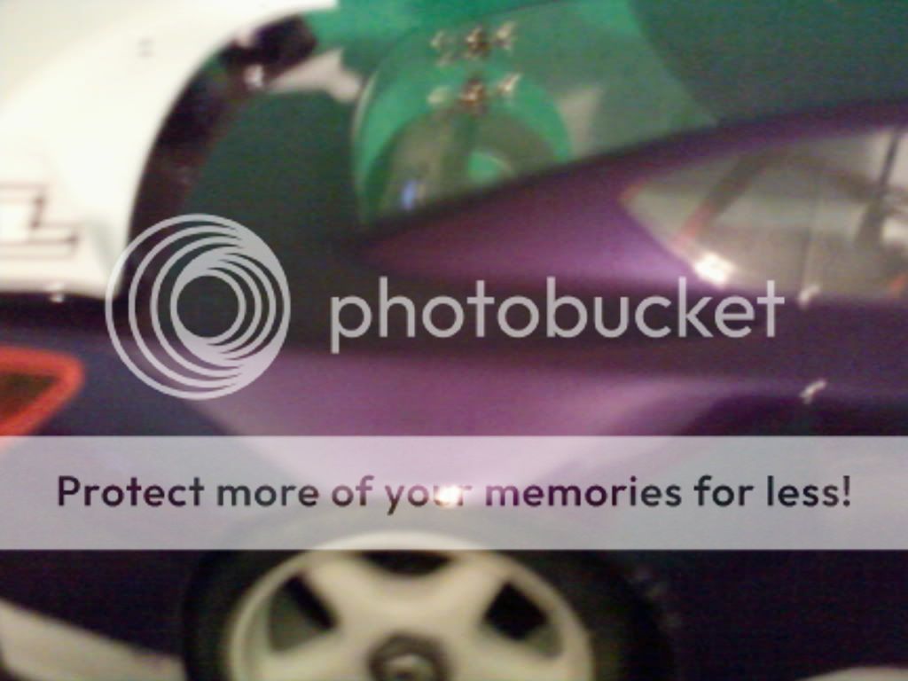

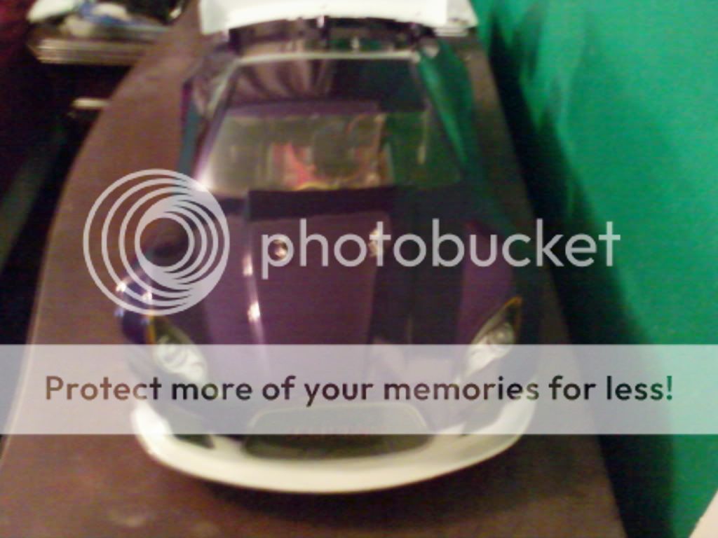

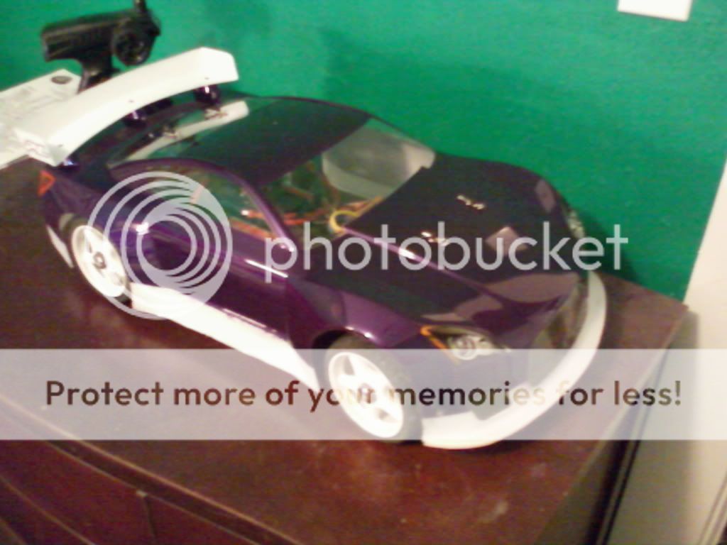

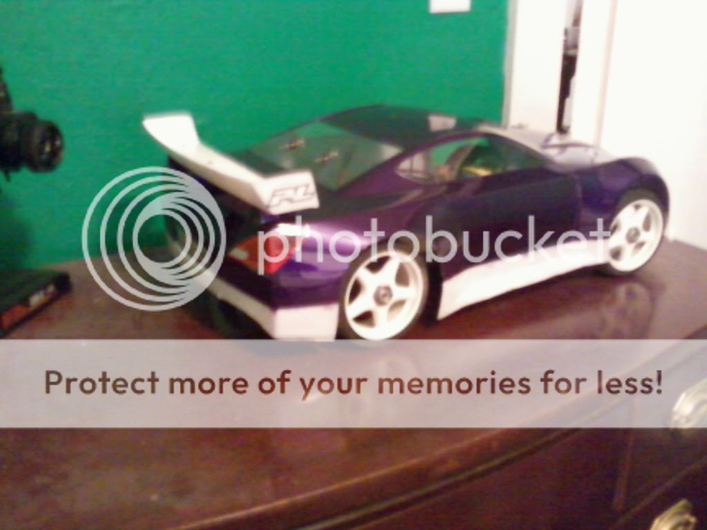

    Not really proud of it but I learned that I need to learn quite a bit more beforing doing it again. I had alot of trouble with paint bleeding under my tape, can anyone suggest a good tape to use?
    It is a redcat by the way, it's anEarthquake 8e made into a touring car. Referenced ZielkeRacing's build quite a bit for ideas. The thing flys.

    Well not bad. 2 toning takes guts first time with airbrush...I use the blue tape from home depot 3m blue??

    Yup use the 3m blue painters tape and make sure to press the edges down really well.

    I will definitly try out that blue tape from Home Depot next time I'm there, I will be painting a slash body eventually.
    The body is a proline protoform PF8-GT 1/8 scale touring car body. Link: http://prolineracing.com/1-8-on-road/pf8-gt-clear-body/. The paint thatI used was Pactra candy purple.
    Sorry about the pictures I took them with my cell phone and if I make them to much larger they get really grainy.
