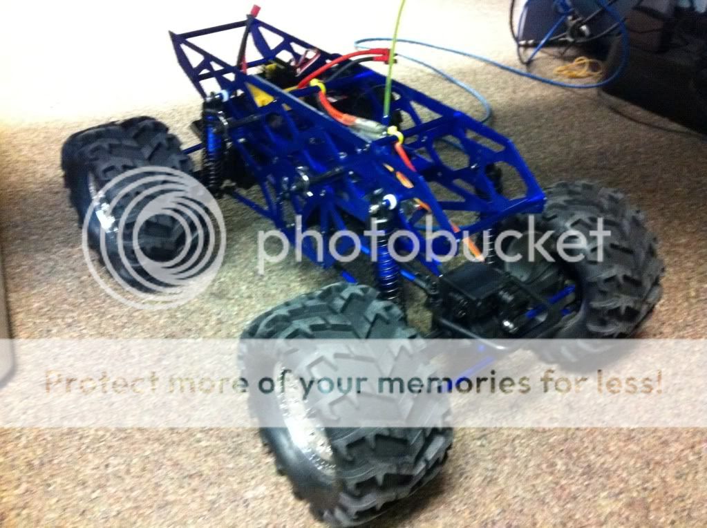

Join Date: May 2011
Location: cicero,
IL
Posts: 716
RE: Redcat Ground Pounder ??
i think iv got da baddst gp out ther, no?
sheer plates. aftr i designd my axle brases, i buckld da alum chassis sides.
1/8" steel sheer plates
my axle braces also protect steern linx
