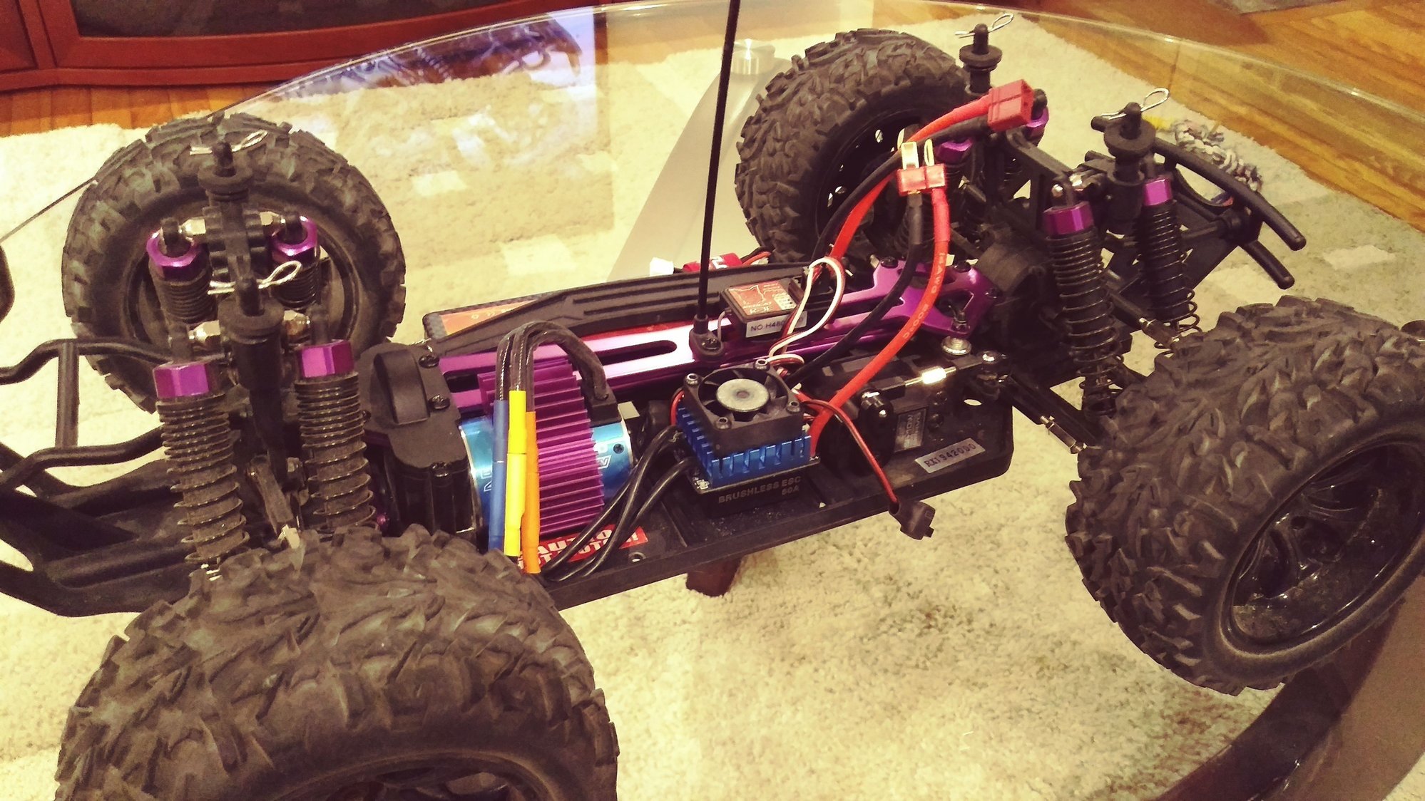

I'm curious of any owners of the Volcano EXP that have upgraded to brushless what gearing you've used? I just got a Volcano and have an GoolRc 3650 3100kv brushless setup coming today along with 2s Lipo 5200MAH. I grabbed a steel Spur/Pinion set that I believe is the stock ratio also. I'm in question about this due to the fact that a lot of videos I've watched where people made this upgrade have very little control or handling with their vehicles. They appear to be too powerful to drive. From reading I've gathered that brushless an entirely different animal and needs to be tamed. I'm just looking for advice as I'm just coming back and research is all I've got.

You are right, and I'm guilty of it myself. People often get too much power. Sure, it's fun going blistering fast, but not so much fun navigating rough off-road terrain while being outta control. Brushless motors are no different than brushed motors in terms of you picking out a motor that best fits your needs. For situations where swapping motors is done, I would suggest investing in an infrared thermometer. That will be your best friend in determining optimum gearing. Don't let motor get over 180F. For my "cushion zone", I try and gear my motors to run around 160F.
If you got a 64T spur gear on the Volcano, I'd probably start with a 22T pinion gear.

I have a Redcat volcano exp that I converted to brushless. Stock brushed pinion is 17t I suggest run it with stock gearing and see if you want more speed or not then go up on the pinion.
I have some suggestions for which have improved driveability and durability with brushless for me. You may have already done some of this but I thought I would just put it out there.
Ball bearings for the hub carriers
Metal gear servo (then tighten down the servo saver for better tighter steering)
Aluminum front A-arms (normally would not suggest but I have broke too many plastic ones)
Springs in the axle and diff cups (help keep dogbones from popping out front only)
Aluminum hub carriers front and back
Keep a pair of stub axles handy
Check screws for plastic stripped screw holes
Be prepared for bent shock shafts after impacts (aluminum or plastic a arms)
Reinforce the body with gorilla tape or shoe goo
Durablility of the volcano greatly decreases with brushless. They can be a handful to control but simply getting a better servo than stock will help.

Thanks guys I really appreciate your feedback. My order just arrived from Amazon with Brushless set up, Lipos and Charger. I also got a steel spur and pinion that are from what you said stock at 64/17 so at this point that's what I will have to try. I'm looking at the following link to cover carriers and steering in aluminum.
https://www.amazon.com/HobbyPark-Alu...uminum+volcano
They come with ball bearings although who knows what quality. I had a Savage that I swappped out the radio system for Spektrum before ever using it so I took the steering servo from the HPI radio and replaced the stock one. Not sure how much better but I'd believe it's a bit more than the RedCat one. I'll use it until it fails. A-Arms I'll order and keep on hand until the stock break. While I'm going through the the truck installing the new gear I'll go over all the screws. Do you happen to have a link to the springs, axles, and cups that you use. Oh, and possibly the infrared Thermometer for temps. I'll go ahead and order it all tonight. Now I just have to figure out this new charger of mine and be safe using these Lipos. I don't want to burn down my house. Beyond that, hoping all goes well installing my new stuff. I drove the truck yesterday with stock battery and motor and wasn't at all impressed. I tried it again today after getting an overnight charge and it was embarrassingly slow. Not that I expected much for $150 and new I's be going brushless. I'm actually only setting this up to play with my dog. I have a Rampage MT coming this week and my buddy custom fabricates racing motors for NEMA (New England Motocross Association) and is going to port the engine for me and make a tuned pipe. That's where my obsession and focus will be on performance parts more so than this build. Once again, Thanks! I'm going to start building my rig now.

Whoah! Got it going and it's night and day difference. Didn't go crazy but all seems good. Doesn't feel hot at all after about 10 minutes of opening it up back and forth. What are you suppose to do with the switch? No apparent place to mount it to.
I had a esc like that there is not much surface area on the switch for tape to hold so I zip tied it on top of the chassis brace.
